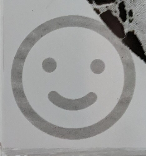

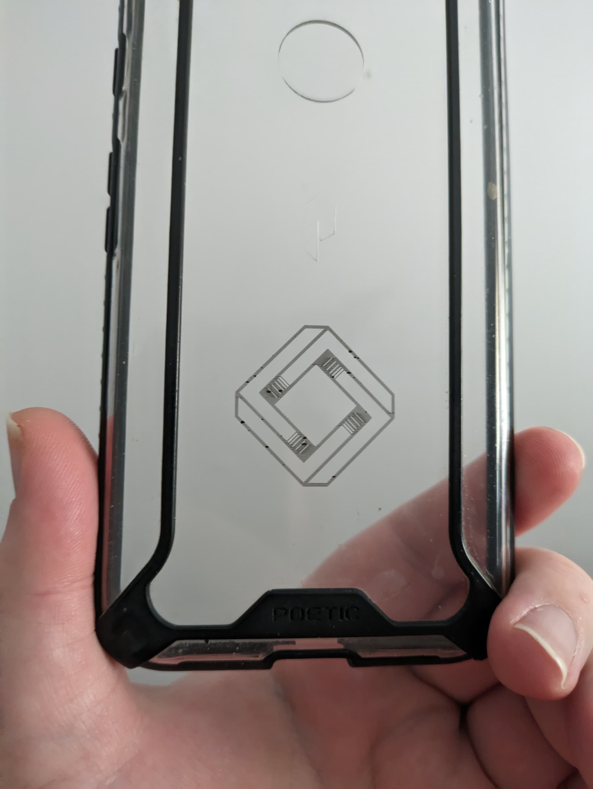

The IR doesn’t work on glass, however, I’ve had success on clear acrylic and other clear plastics.
Acrylic; Little smiley face.
Transparent phone case: Manufacturer says it’s PC.

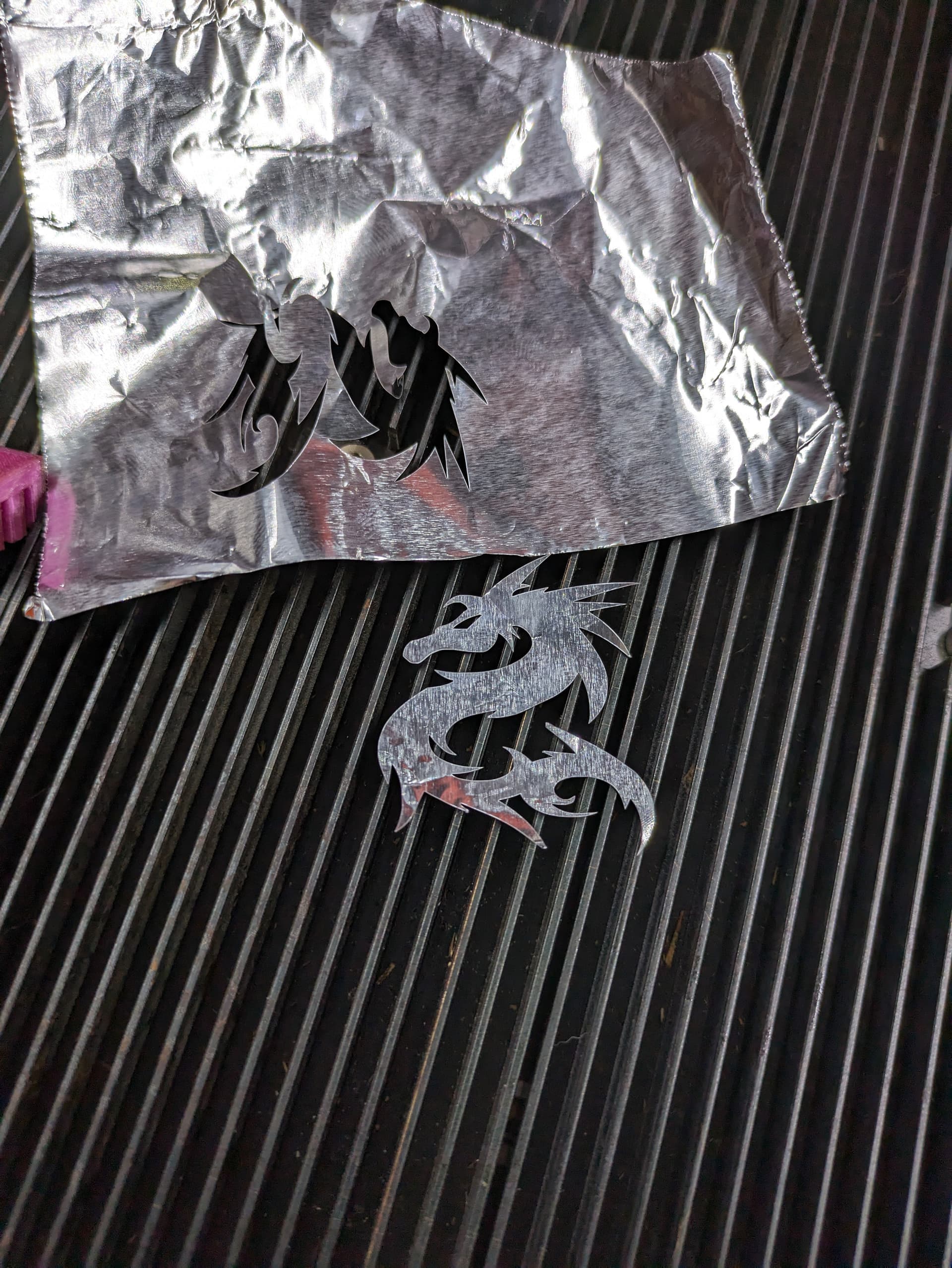

Bonus; Aluminum foil.
