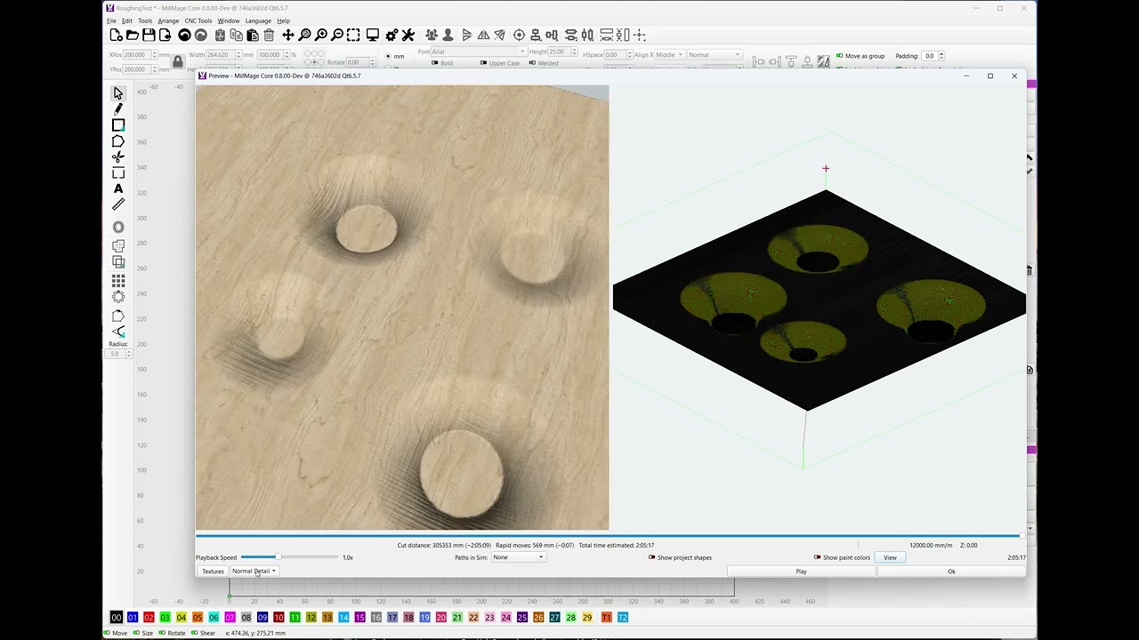

This is “manual roughing” for the moment, while I’m planning the feature and checking my math. The relief pass is working, but needs a little cleanup, and I’d like to have options for optimizing the gcode output, smarter image sampling (for speed).

Relief carving alone isn’t too hard, but generating optimized relief toolpaths, and good roughing passes with optimized retractions is a pain in the butt. Importing an STL and doing the conversion to depth map will require a bunch of new UI to support it.
I have the basics of relief roughing working, but still have a bunch of bugs and a bunch of improvements to make. I’ll try to post more progress as it’s happening.

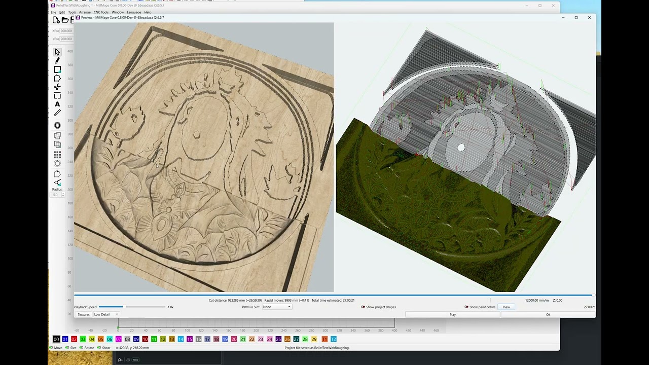

I now have fully automated roughing:

There are a couple complexities there:
  • finding areas that a given bit can’t reach will take some effort. I don’t have a good idea how much yet.
  • Depending on complexity, it might make more sense to just do the whole job with the fine bit, because lifting/moving between smaller sections will add time.
It’s possible right now to do multi-tool manually (or it will be, once I’m done adding the boundary area code). Having the system do it automatically is an interesting idea, but I’ll need to figure out how feasible it is.
