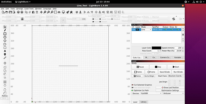

I’ve attached a simple test job that is failing.
CircleTest.lbrn2 (12.4 KB)

  3. Take a full screenshot of LightBurn with the design loaded and ready to burn. Please have Cut window and Laser window showing for the screenshot.
  4. Try doing a square frame. What happens?
  5. Save the gcode for the design. File->Save gcode, use .txt extension, then upload file here

When I try to run the Line_Test gcode (or any other) The laser goes to the starting point, Stops, and Lightburn just shows Busy below where it says Laser on the right. To do anything else from that point I have click the Stop button even if I wait a long time for the job to “complete”.
I haven’t tried a different USB cable but this is the once I have been using with this laser since I got it.
Line_Test.lbrn2 (2.7 KB)
Line_Test.txt (255 Bytes)

  1. change S Value Max to 255 in Edit->Device Settings
