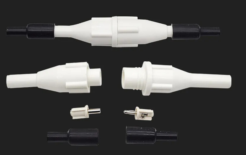

I’ve just replaced the 60w laser tube, in my 10 year old machine, the old tube must be five years old and has had plenty of use. The new tube had cables already fitted, but they were too short to reach the power supply, so fitted an additional red lead between the two with proper laser cable connectors. Running the laser it seems well down on power, my laser test meter is only showing 12w at the end of the tube, running at 70% power the amp meter is showing 10mA. I’m wondering if it’s the additional connector causing an issue or is my power supply on the way out?
Should be ok - what connector did you use?
Like this?
I have joined the high voltage cables before and rather than use a connector I prefer to just directly twist the copper strands together and solder for good measure, then wrap with high voltage rubber splicing tape. I guess it depends on the quality of the connector you are using.
Also check for any sign (or sounds) of arcing on the high voltage line and make sure the black return wire from the cathode end is properly terminated back at the high voltage power supply, and that your ammeter connections are good.

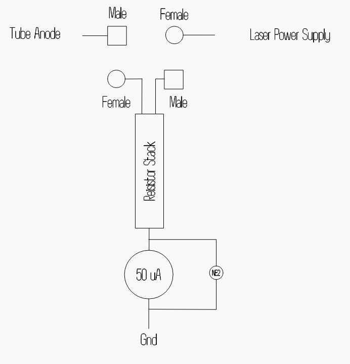

When I put a hv meter on the machine, I used these to connect the 800mOhm resistor to the supply.
I used opposite connectors so I can take the resistor out of circuit and still plug them back in.
You did use HV wire?

Thanks for the replies, yes my connectors are the same as in the picture and I am using HV cable. I did think about soldering one of the connections, so will give that a go.
