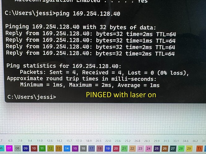

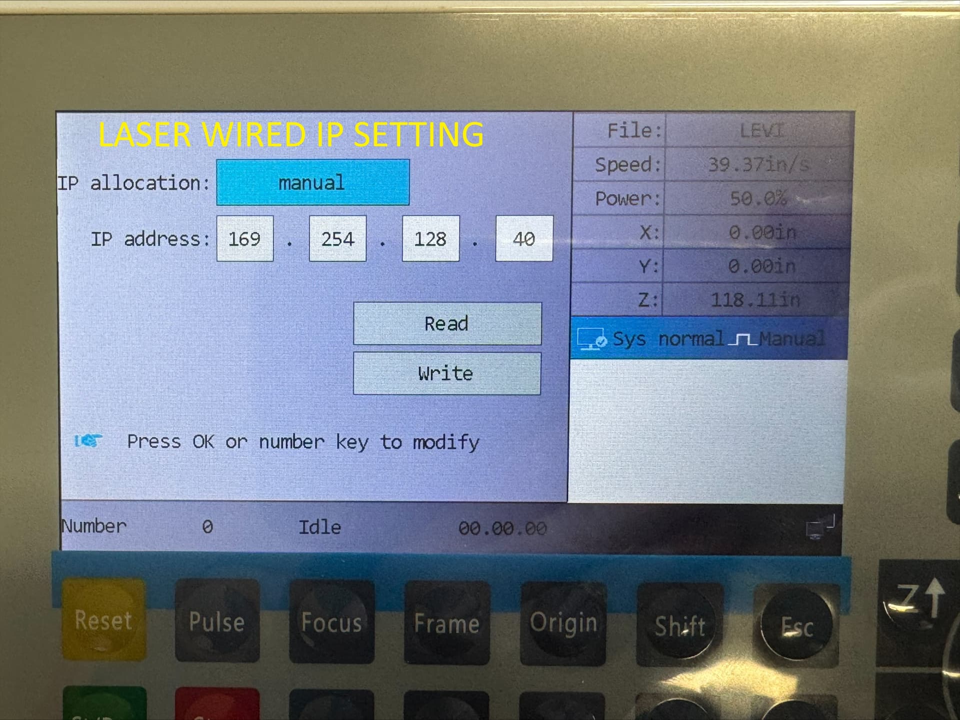

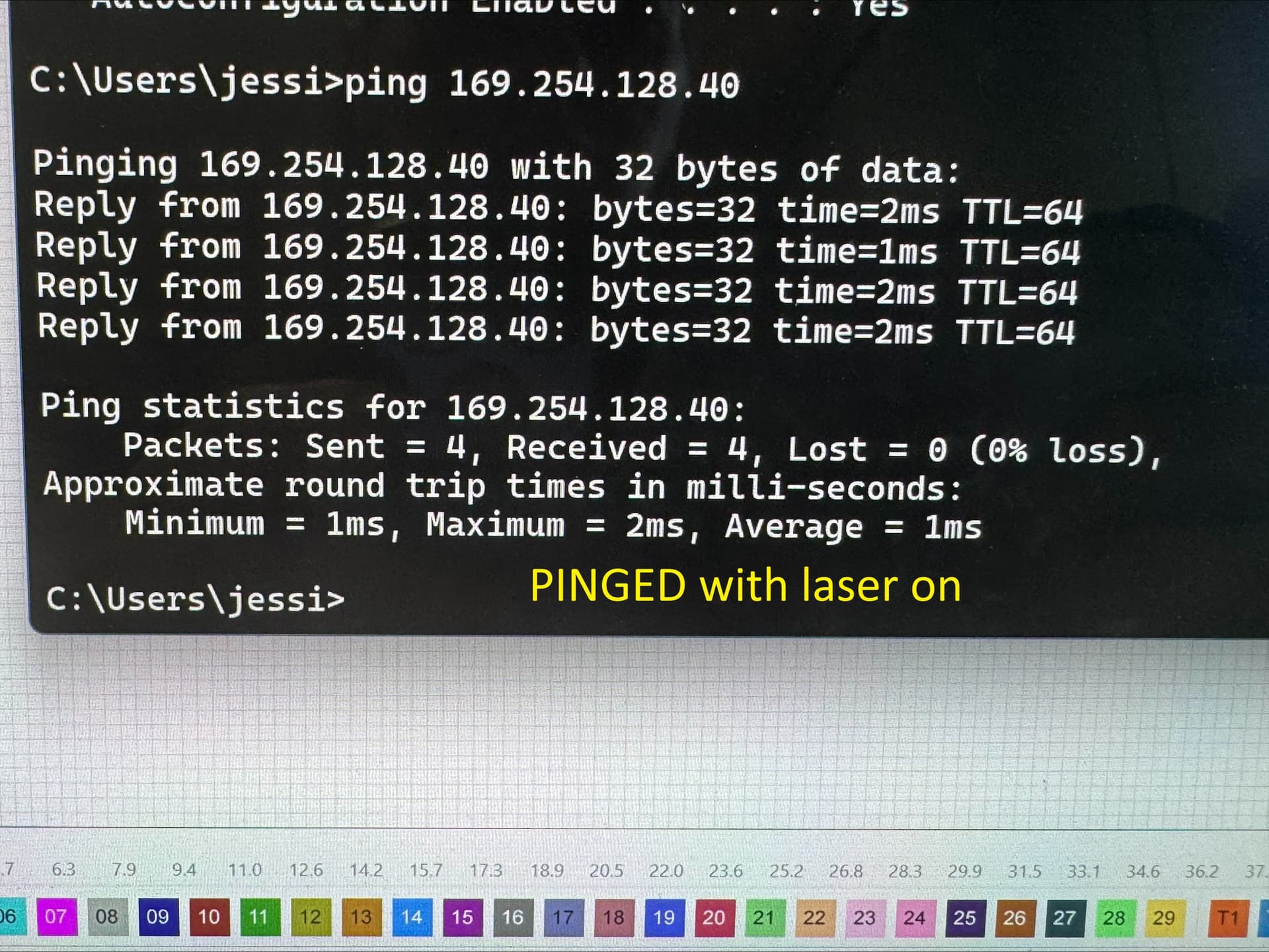

Thank you for your reply. I am sure the network cable is ok as it immediately picks back up when I put the old controller on. I see that light 15,12, and 9 are on and light 14 is blinking. After checking this, I did change the IP on the laser and then changed it in my lightburn configuration for the laser. There is no change as lightburn still doesn’t “see” the laser.

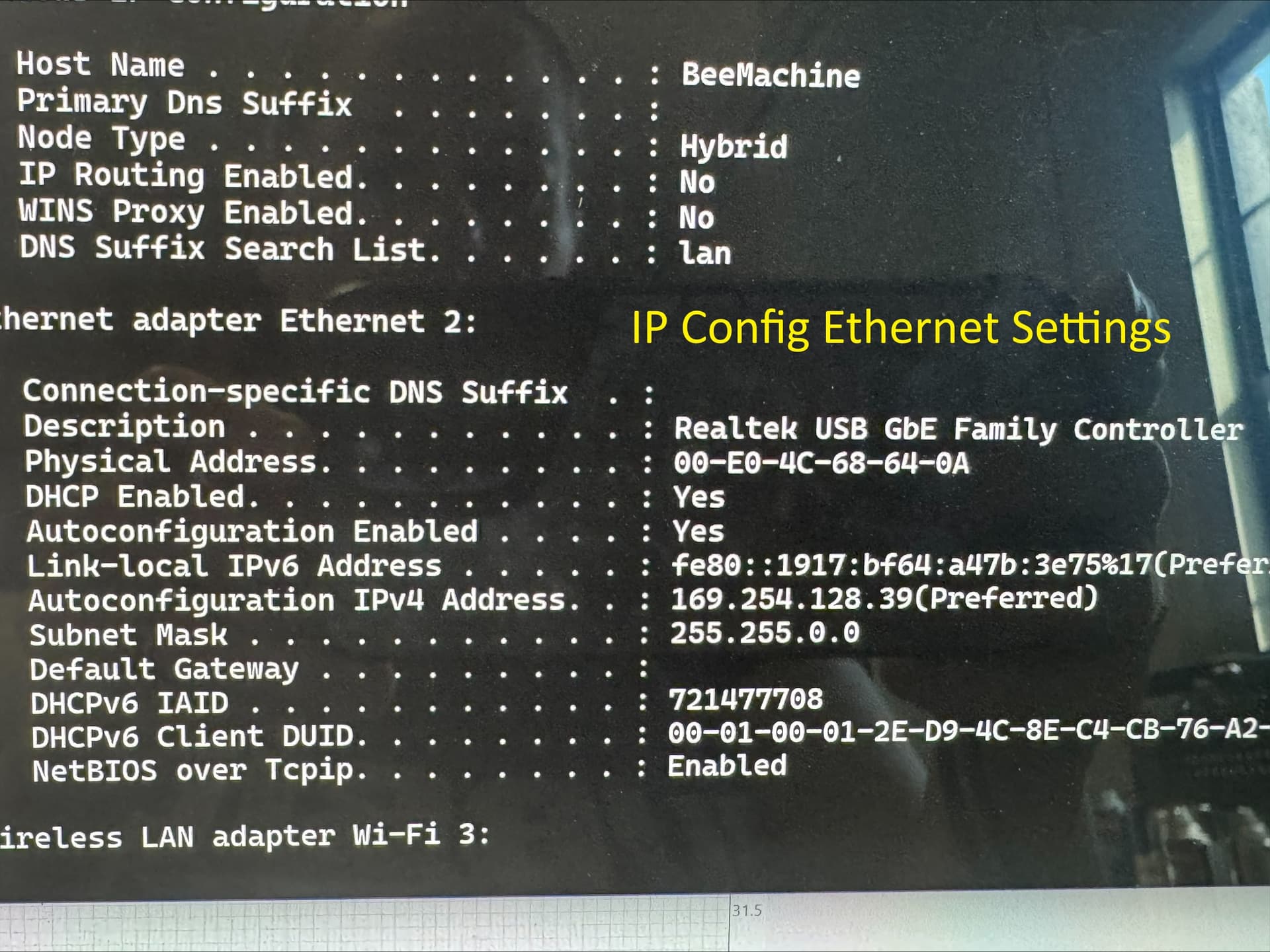

Now it’s time to get more information so the hive mind can ponder the situation:
Type those commands in a Command Prompt window that you start by hitting the Win key and the R key, then typing cmd into the run dialog box.
Thank you. I appreciate your help. Attached are the images requested. The board shows the wired connection light lit, but not the communication light. The image with the board was caught and shows pin 14 on, but that is because it is a still image. That pin is flashing.

The only quibble I had with the setup was the PC’s IP address, which is a default link-local address. AFAICT those addresses will only work with a direct network cable from PC to laser, not through a router on a LAN.
If you wanted to use the laser on a LAN (and it worked with Ethernet), you’d set its IP address to the same subnet the router assignes to the PC, typically be something like 192.168.0.x. But that’s for the future, should Ruida ever makes it work as everybody expects it should. :frowning:
