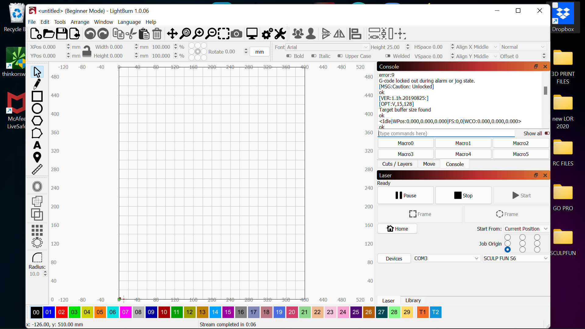

LOL, well when i spotted her on the computer i thought nothing about it until i seen light burn opened, i attached the photo of the console in hopes that would explain a little of my troubles. I feel i have bitten off more than i want to chew with this coding stuff. i get ERROR 9 g code jog and i cannot move my laser with the direction keys it makes a crazy noise. I really was hoping there was a factory reset of sorts i have tried uninstalling lightburn hoping that would work but it didnt.

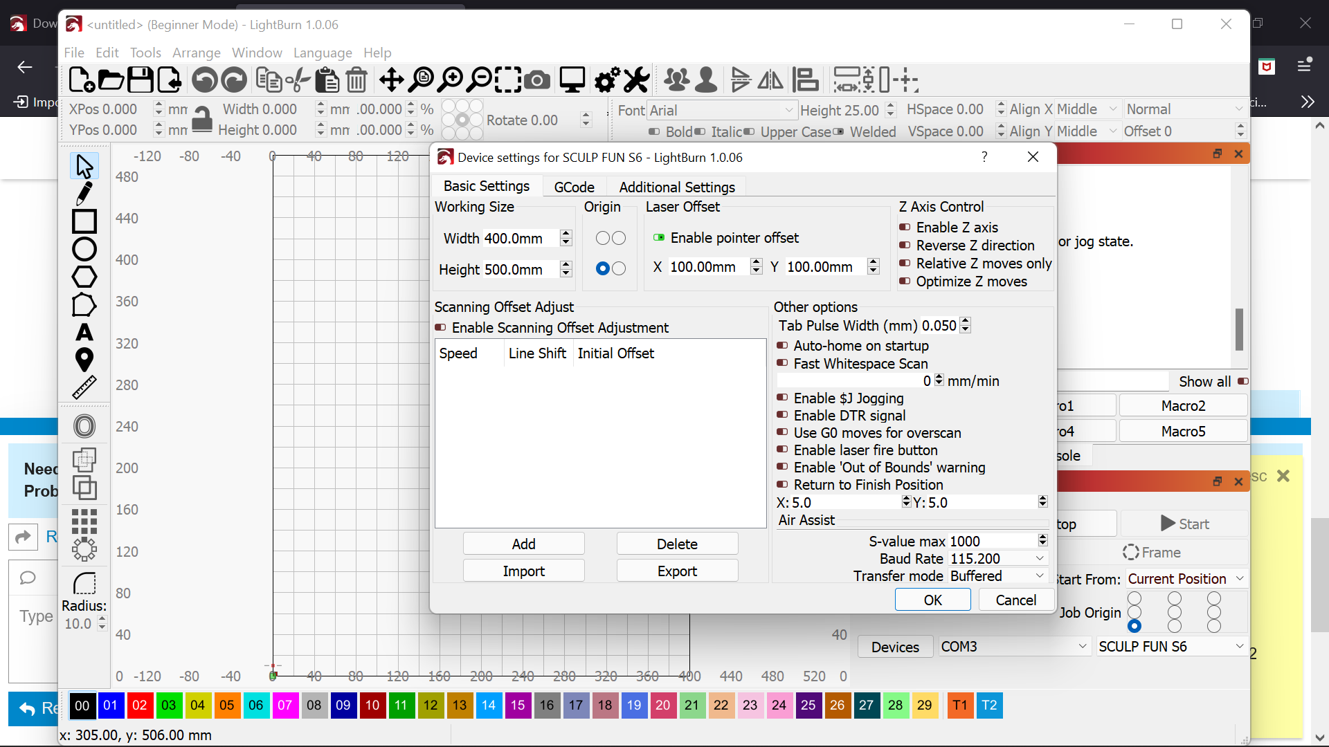

Please open Edit->Device Settings and take a screenshot.

i get no movement using the arrow keys and the laser does not try to move when turned on
what i get is a short thump like it tries to move then the error 9 G-code locked out during alarm or jog state

  1. In Device Settings you have “Laser Offset” enabled. Turn that off.
  2. Enable “Enable laser fire button”. That’s useful if you want to see the laser beam for testing. Will be available in the Move window.
However, none of these changes will fix the laser not moving. Now I’m thinking there may have been more stuff changed so let’s take a bit of a closer look.

I expected to see the homing cycle ($22) to be enabled but that doesn’t seem to be the case.
However, I do see something that’s highly unusual.
The PRB line is indicating that a probing operation was completed and indicated that the Z position of the laser was 2147483.648. I don’t understand how a probing operation could even be done with your laser.
This is resulting in the laser believing the current position to have a Z position of the same value.
I don’t even think this should be an issue but the behavior you’re describing is highly unusual.

This is what I don’t understand. It looks like LightBurn has asked the laser to home but since your machine is not capable of homing it goes into error state. This is why you can’t move.
However, your device is not set to auto-home based on what you showed in the Device Setting.
