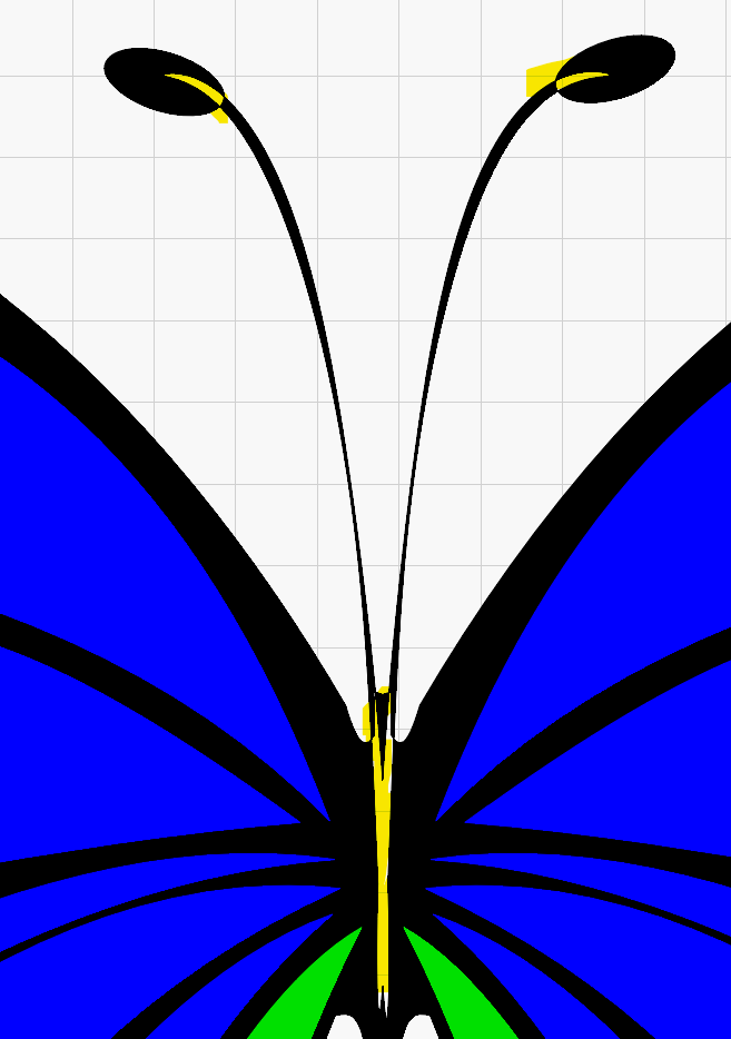

It’s unclear to me exactly what you’re going for in the design so I’ll speak in generalities about some things I’m seeing:
  1. LightBurn follows the rule that areas of overlapping shapes will become negative space. So in order to make a hole, you put one shape on top of another. And importantly, this rule is only applied to shapes on the same layer. For example, shapes on red layer won’t negate shapes on black layer.
    The areas in yellow highlighted are negative space because of this. Is this what you want? If not, you’ll need to weld these shapes together such that they are one consistent shape.
  2. To further elaborate, all layers in LightBurn are treated independently in terms of how the graphics interact with each other.
    So for example, in this screenshot the entire black layer is evaluated independently of the red and black layers. This means the red shape does not result in negating the black shape. Instead, the red shape will burn independently with its own settings
  3. Running a job with a single shape in LightBurn is not necessarily the same thing as running all shapes at once because of the way negative shapes are handled
  4. All lines in LightBurn will get burned in spite of how things are stacked. Because something is obscured from view doesn’t prevent it from being evaluated for burning.
  5. Using Preview will show you how your job is being evaluated. Scrub through the Preview to understand how the job has been evaluated and what exactly the laser is being instructed to do.
I suspect based on your description you probably don’t want the colored areas at all. Remove those shapes in that case.

Here’s a view of the shapes where I’ve turned off the colored layers and shifted the background shape. The shapes representing the negative space are more apparent.

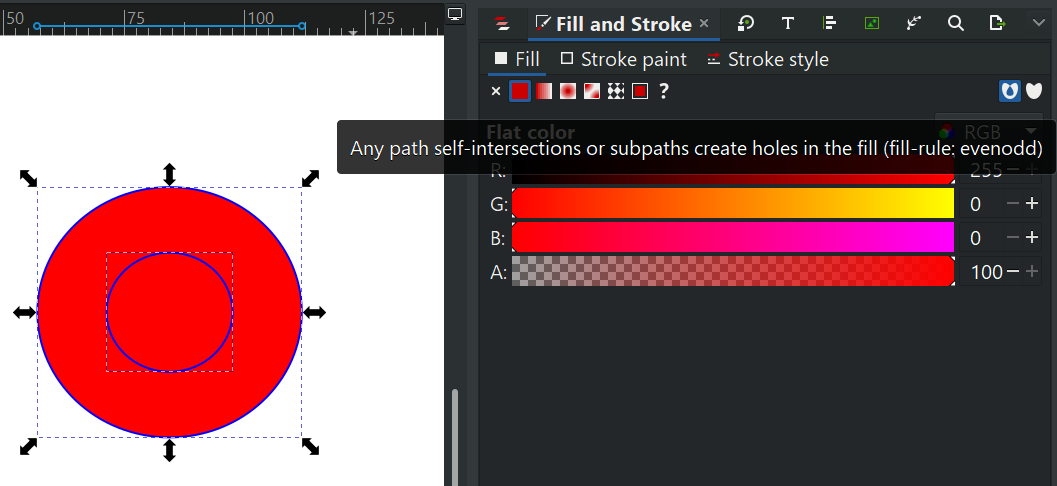

This is actually the same as one of the modes in Inkscape.
Note the wording in the tooltip. When combined these shapes will become a donut. However, that’s not true for the other mode where only counter-directional shapes will result in negative space. The only difference with LightBurn is that this is applied to all overlapping shapes, not only those that are combined.
It’s hard to know what you’re expecting without a thorough description but if you just want each color to represent a different level of shading then yes, you’ll mostly get what I assume you want. The exception being the negative space on the antenna and body. Are those deliberate?
One thing I’m noticing with your design is that you’re using flood fill for the black layer. I don’t see any value in doing that. Suggest you turn it off unless there’s something very specific you’re going for.
