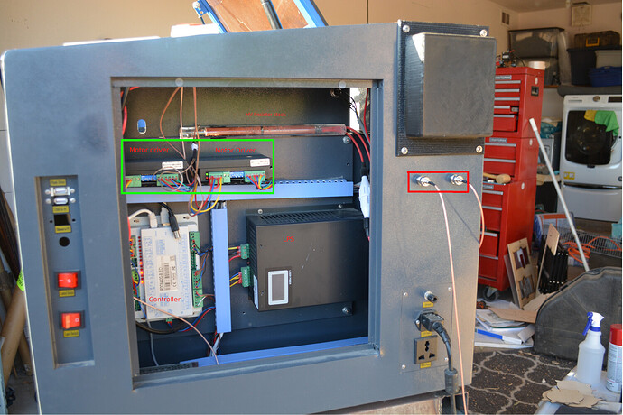

This is a common motor driver, might not be the same as yours but it will look something like this.
dm542
The two motor drivers are about center in the photo in green rectangle. Yours can be mounted anywhere.

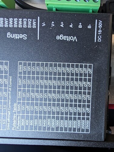

Here’s a pic of the side of the stepper for the y axis:
When trying to read the chart on the front, I have to use a combination of a magnifying glass and flashlight, as the “steps” part of it is tucked behind a piece of frame. But using the last 4 switches as off on on off, gives me 2000, just like the one in the former post you shared.
I’m so confused. While typing this, I had made a few more videos and pictures, starting at 3000 steps per rotation, showing how it went 3.5 rotations forward, then 2 back. Then I clicked ok, and switched to 5000 for a comparison, but it only went 1.5 rotations forward, and returned to start. I just went back to 3000, and it fell short of 1 full rotation, and returned to start.
Could this have just not been writing to my controller or something?? I’ve been hitting ok, have restarted lightburn, turned on and off the laser, etc.
Can you see the front of the driver? It looks like the switches are OFF ON ON OFF. If it’s the same as my driver that would be 2000.
