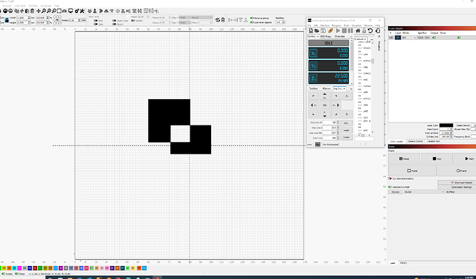

Have the highly common drivers typical on Fiber Galvo systems for Z and Rotary. This JPT-C-80 form JCZ. The rotary is energized, yes , both coils about 1.2ohm good… but no commanded movement. In the Lightburn window Rotary Set Up, where Rotary is ENABLED there is a Test button at the bottom. When I press it, nothing happens, it stays blue` and nothing is reported below it. The rotary unit/function is new/unused/unapplied. What is the next step in troubleshooting ? Of course, Laser Everything and every ones similiar videos Ive watched. Can I actually see the Lightburn “signalling” the motor, measure that electrically?

The LB rotary function is running my z-axis. My JCZ JPT C 80 fiber came with Ez2, programmable Z, and Rotary and all that worked…I have another question into the software forum about the Z issue, can I just swap the cables, and of course change the settings on the driver as appropriate?

Appreciate your time ! Yes, its a JCZ unit, JPT-C-80-M7 Fiber 1.064. #1) Sold with programmable Z (do not have electrical buttons for Up/Down) and rotary. Their LMCV4 board Com4 has two motor driver out pin outs (4 wires). One is their Z the other the Rotary. Yes, ran fine. #2) Lightburn answered me with little concern for what they called “automation”, and no, not supported in the Galvo package. I do not understand that, we need focus control WITHIN the program run structure.
The EZ2Lite has a single Control Board FBL1-B-LV4 out for rotary. The regular std. Control Board LMCV4 has ability for two. However, the output is set for extension axes X and Y (so designated on print) to Z and Rotary respectively. Lightburn for Rotary wants to use the X control board output (pins 6,7,14,15) … so… simple switcheroo. in the chassis at the signal input. Tested and fine.
