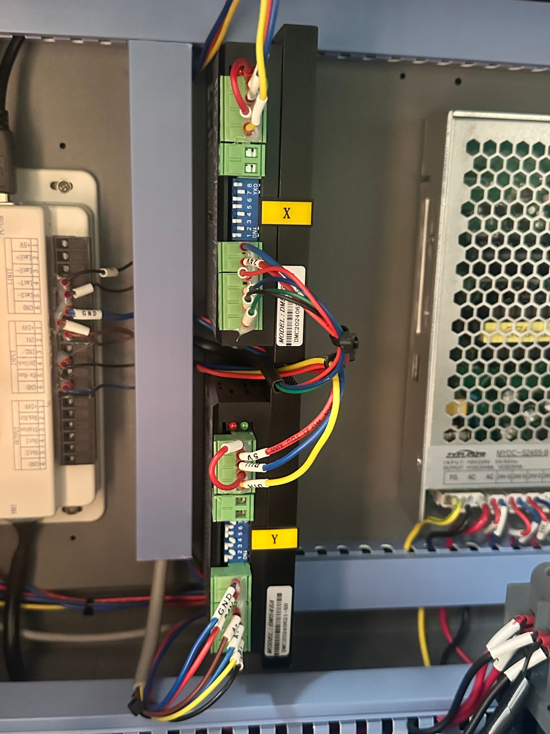

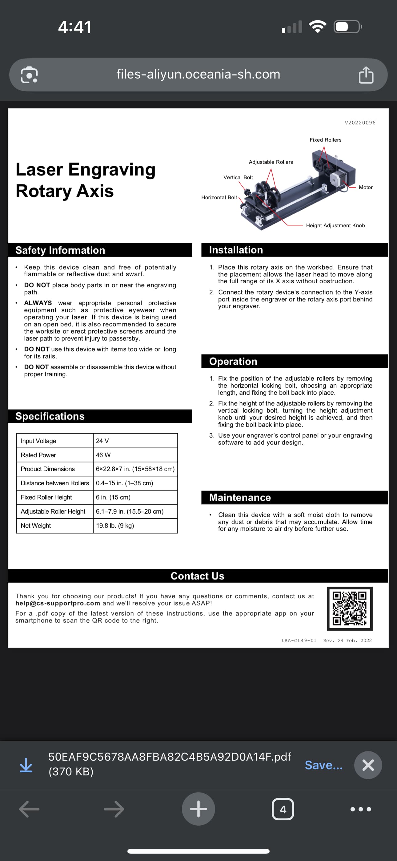

I’m attaching a link and a picture of the rotary I’m using.

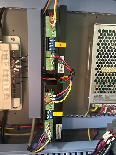

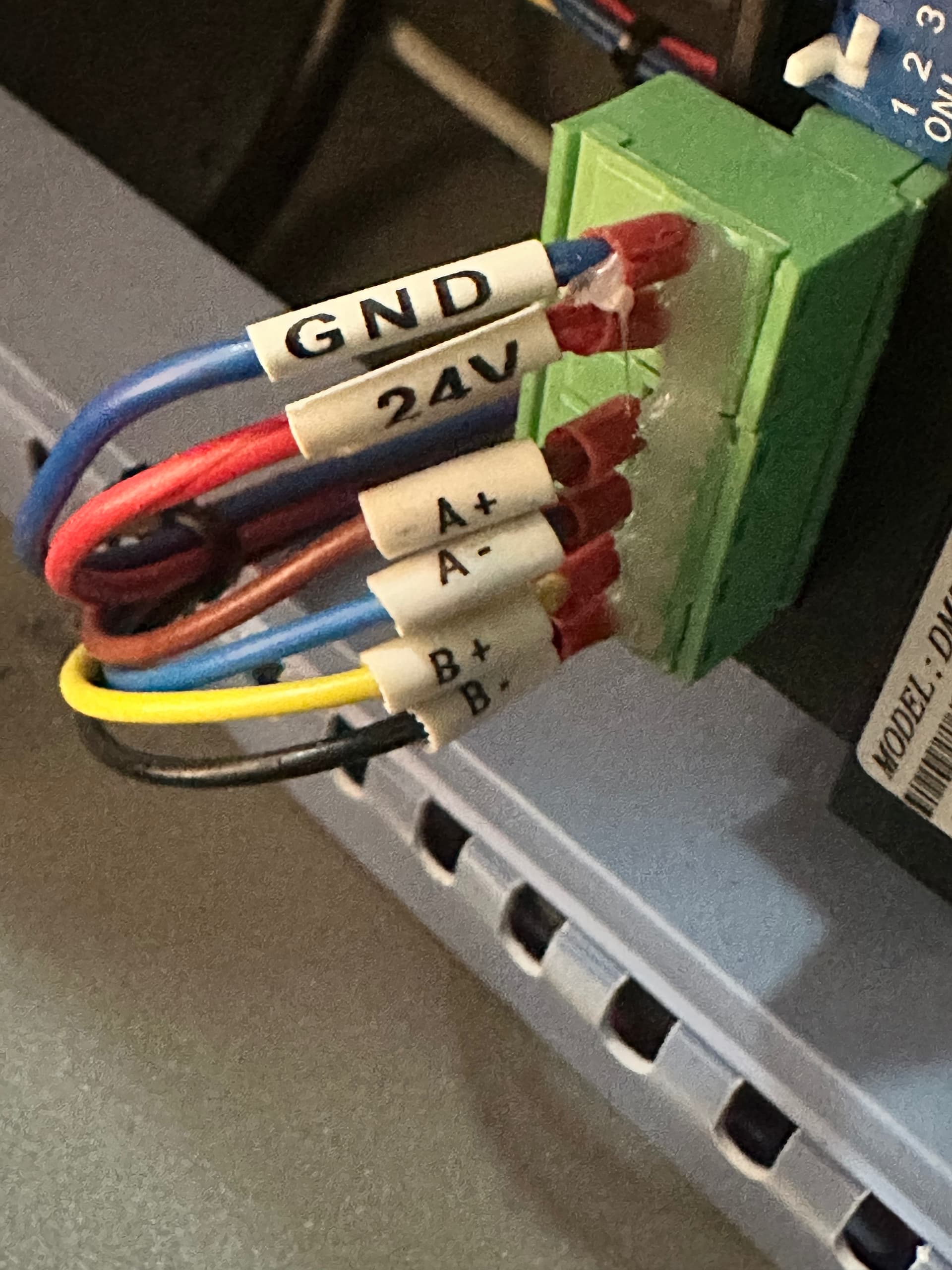

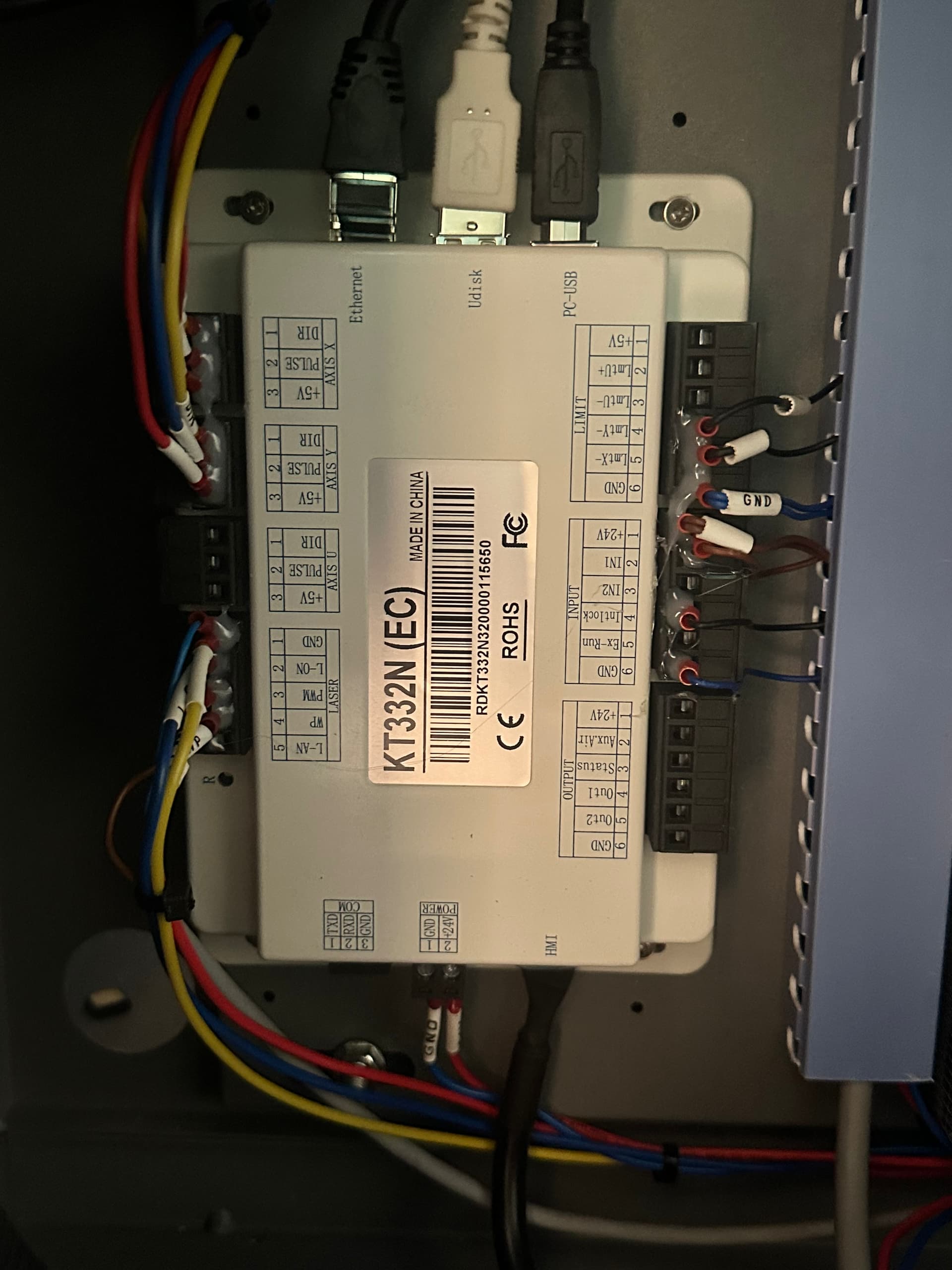

Problem: I’m setting up the rotary for the first time. The laser and the rotary each have an aviation plug. When I’m trying to control the rotary from lightburn in the rotary set up screen, it is not responding properly. I have selected roller style, taken all my measurements and entered in the appropriate spots, and then click “test”. The result is the laser moving about three inches on the x axis and no movement on the y axis (rotary). When I use the touch screen on the laser to move the head, it responds perfectly on both the x axis and y axis (rotary). I read it could be wiring so I have attached pictures of all the connections. Checked the Ohms and they were correct.
If it responds from the machines console it’s likely OK. Does it move the distance specified by the controller?
