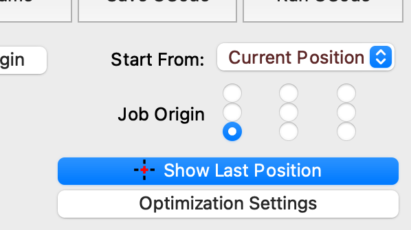

On thing you can try is setting the Job Origin to the lower left corner. That’s where the Fill will start by default, so that should eliminate the jogging motion before starting the actual engrave.

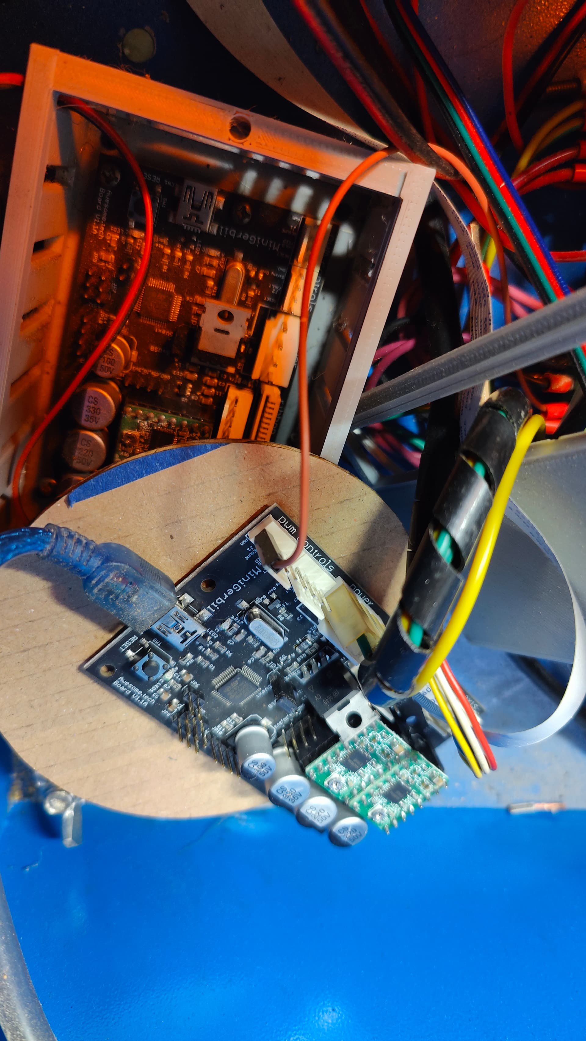

its actually still doing it brefily even now i have secured the pwm cable.
take a look just before the jobs starts:
If securing the loose cable helped before, but you’re seeing a recurrence of similar behavior, that strongly suggests that there is still an issue there. It could be that it’s come loose again, is loose on the other end of the connection, or the power supply itself is failing.
The cable is 100% secure. power mode was on all time before which is because the cable was loose.
Behaviour is fine after the initial burn at the start where as before the laser never turned off again because the cable was loose. Something else is wrong here.

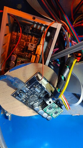

Same issue with my spare controller:
I’m not saying the connection is necessarily loose exactly where it was last time, but if tightening the connection resolved the problem for a while and now it’s come back (in slightly different form), that tells us that the issue is with the power supply to the laser head. Either the wire or the supply itself.

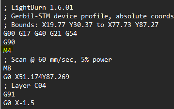

I am no gcode expert but i can see a M4 command in LB just before the job starts.
Lightburn.txt (128.2 KB)
laserweb.txt (1.2 MB)

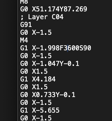

Yes, it looks like Laserweb is sending the M4 command after the first move. However, sending the M4 command at the start of the GCode is standard for all GCode LightBurn produces, and the laser should not fire until it receives G1, F### S### commands as well — which means there is something wrong on the machine side that is not exposed when you use Laserweb, but that’s not quite the same as the GCode produced by LightBurn being wrong.
You can try saving manually editing the GCode so the M4 command is just before the first G1 command:
Screenshot 2024-06-12 at 11.16.02 AM
Then clicking Run GCode in the Laser window to select and run the edited GCode.
