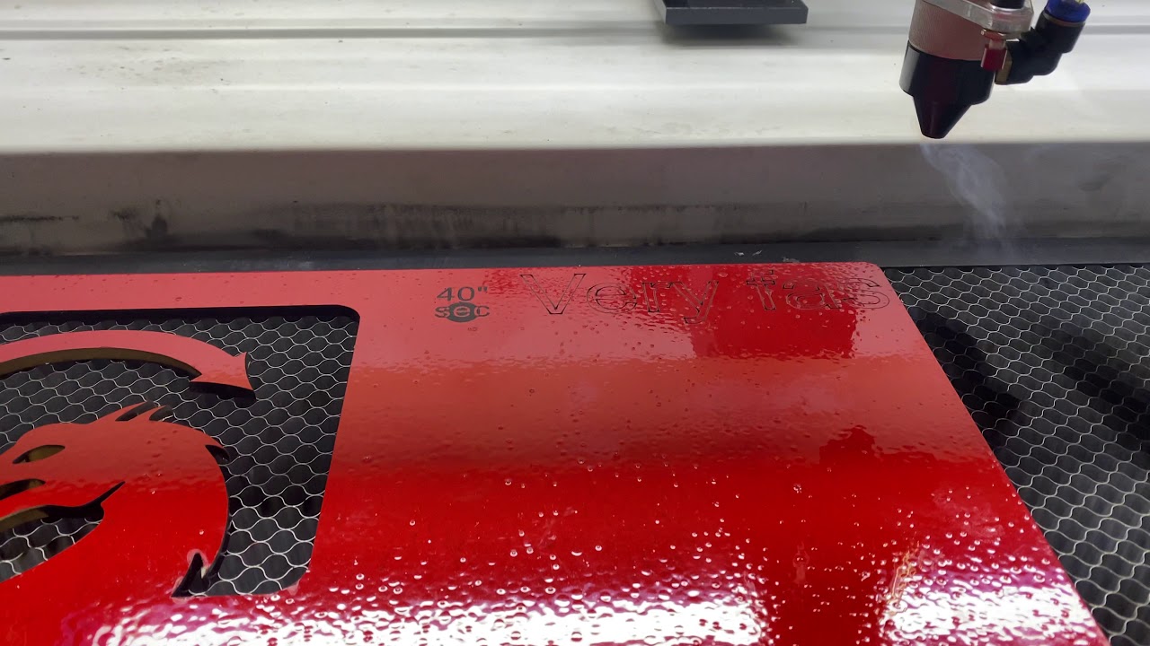

The video you posted is engraving at 800 mm/sec with Ruida’s max acceleration of 15,000 mm. You don’t need servos or hybrid motors for this.

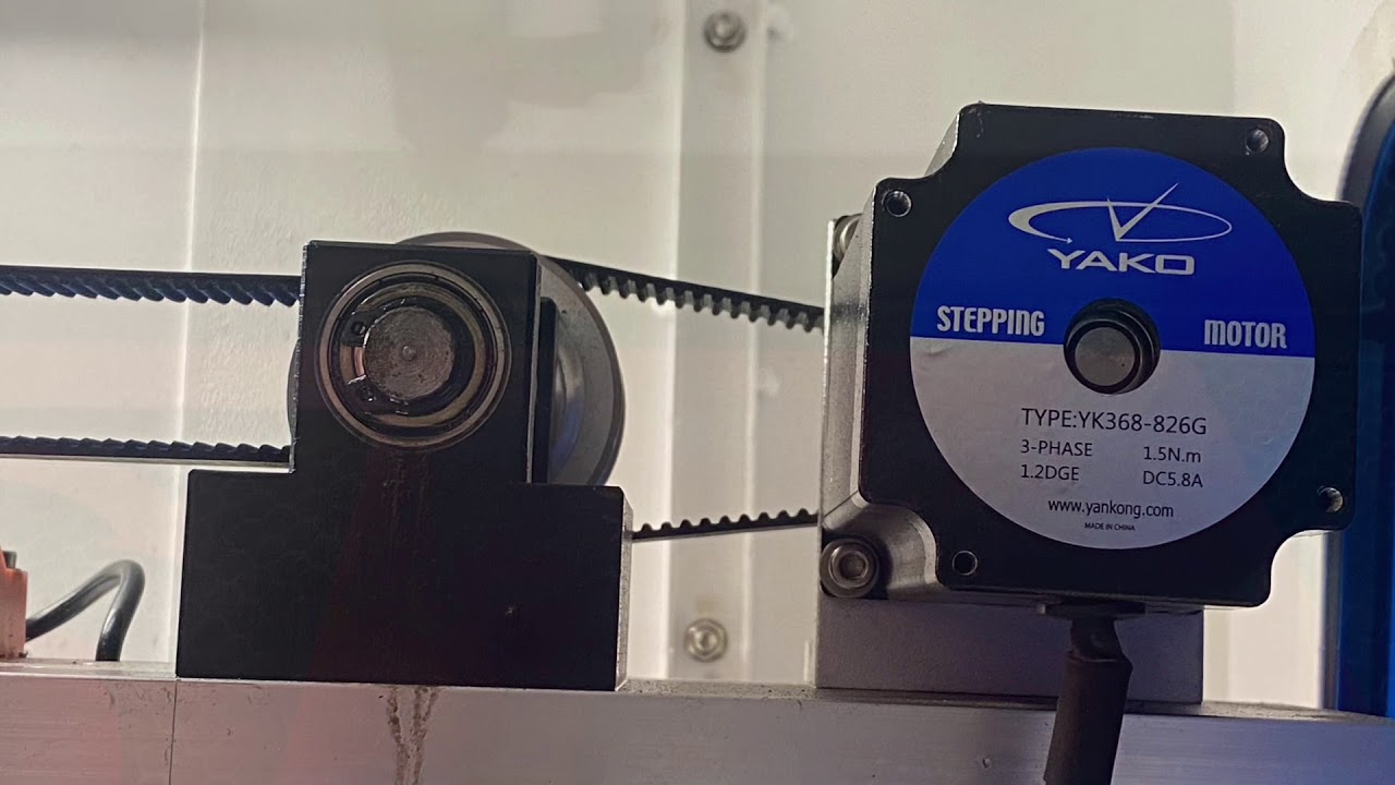

Here is my yako steppers running at 1016 mm/sec :slight_smile:
Also, fast vector engraving
You’re right you don’t. And for a glass tube you can’t do anything past 1000mm/s without out running the pulse (20khz rate/pre-ionize/cutoff timing) But you’re never going to get the accuracy of the servos with steppers, and this is further dimenished the faster you go. Drivers and PSU stability is also critical. Especially with micro-step creep and HTD 3m belts you’re running. Repeatability is what I want to see your system do at these speeds. Show this from start to finish on a three row run of at least 4 semi complex item shapes that have raster fill+line then an outline cut with this setup. If you don’t get offset creep I will be very impressed, but I find it highly unlikely you will be able to do it.
Comparing leadshine stepper those clearpather SK/SD motors isn’t much of a competition in many ways.
That isn’t to say you can’t achieve speeds similar when running ultra light nozzle assemblies and belt reductions.
If I had your machine, I would concentrate of belts and pullies at this point. Something like 15-25mm 2m GT2 profiles with resonance dampers. I can see those HTD belts you’re running vibrating like a guitar string. Now for the paint removing stuff you’re doing in the videos, this sort thing probably isn’t an issue that is as noticeable. But scale your work on down to 1/3rd or less the size of what you have on that 40" raster engrave on the red plate and run this again on acrylic that you also cut out with rounded corners. The rounded corners will likely show belt resonance marks.
Either way, if I’m wrong then the truth will be known what you can do in overall performance with this. But it really can’t be shown removing paint from a plate.
By the way, what are your motors, drivers and PSU used? I just want to know if you have anything different from the typical.
