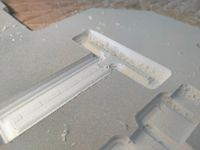

setting up a round over bit 1st time ever, not sureif im it doing wrong but its diving deeper than i would expect
ROUND OVER TEST.mage (21.4 KB)
1: i would assume it would be a chamfer operation , as they do same job one rounded ones angled
with chamfer operation it wont allow me to select a round over bit

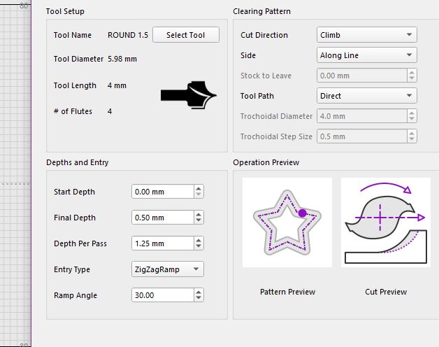

2: using profile even set at .5mm dept. it buries its self 4-5 mm in to project when you would expect it to not even touch surface
even final depth of zero it burieses itself
the main pocket is 3mm

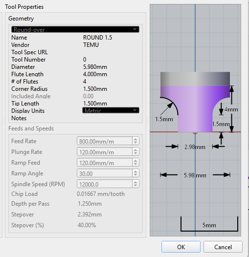

Did you probe your tool length after changing from the flat endmill to the round-over one?
I stumbled here, because the Tool in the project file you sent uses a different Tip Lenght. Did you change this after you took your screenshot, or did it get scrambled somewhere else?

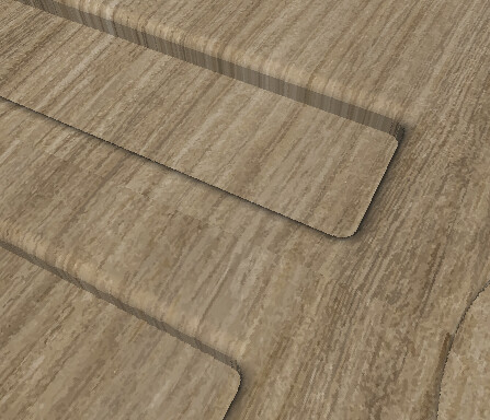

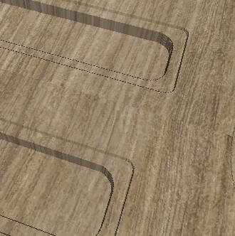

Why would you expect it to not even touch the surface?
At 0.5mm Final Depth, the Preview looks exactly as expected to me:
With a Depth of 3mm, we get nice chamfers:
I missed this part. It’s true that the Chamfer operation only works with V-Shaped bits.
Doing the same movement with a round-over bit would technically work, but would be called a Fillet instead.

Both indicate that your Z-Offset are not set correctly.
Are you using the Preview feature (Alt + P) to verify that your Operations are doing what you expect?
