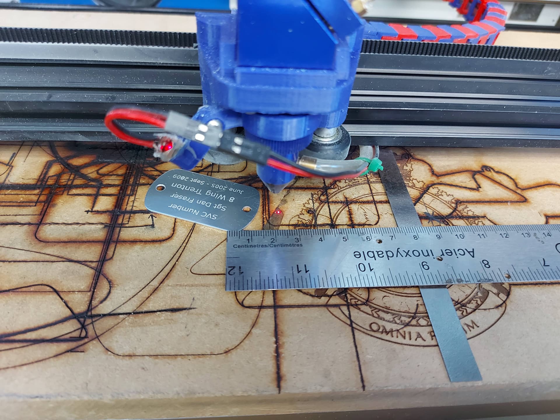

This photo is of where I have the project to start. The disc with the hole in it shows the bottom left of the project. If I select square frame it follows the rular across to the feeler gauge, up then back to the hole.
This photo shows the origin position using the rubber band frame. The feeler gauge on the right shows where the far right of the project ends and it circles around to the finish point. See next image
This photo shows where it stops after the rubber band frame. It’s approx 6mm to the right from the start position. If I select the rubber band frame again, it does the same thing; however, ends another 6mm to the right of where I started that frame from. Basically every time I do a rubber band frame it moves it to the right about 6mm, but shows the position as being the original starting position like in image 1 up top. If I I move the laser head back to the home position without selecting home it doesn’t move it back to say 0/0 but however many mm to the right of the starting point. Next image shows that.
This is supposed to be 0/0 which it isn’t. Next image is 0/0
I literally have to select the home button for it to realize it’s actually at the home position.
If I want to use the rubber band frame on anything over 115mm wide this is the issue. If I use the rubber band frame on projects at or under 115mm wide, no issues. I hope this all makes sense.
