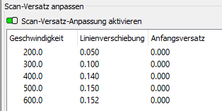

2 lines have a shadow here and 2 don’t
The lines should have the same thickness
The shadow is created at the start of the line. At the end of the line there is no shadow

In principle, the Scanning Offset Adjustment
values should be fixed for all materials, because it compensates for controller-to-material delays.
In practice, stray energy around the focused spot will damage delicate materials at differing diameters during turn-on and turn-off, so you may need slight timing variations. I avert my eyes and define the results to be Good Enough™ for my simple needs.

“Scanning Offset Adjustment” compensates for the laser turn-on and turn-off delays. It matters most for high-resolution uniform materials like acrylic and, unless it’s grossly wrong, very little for fibrous stuff like wood and MDF. There’s no point in attaching the values to specific materials because it remains nearly constant for most materials; set it on acrylic and forget it.
“Overscan” is the distance on either side of the filled / engraved area where the laser head accelerates and decelerates; the Ruida controller handles those computations. Because the laser is off, the overscan area has no effect on anything within the LightBurn layout, other than requiring it to be more than the overscan distance from the edge of the laser platform.

So I decided to check everything, starting with adjusting the mirrors (they weren’t adjusted quite correctly either, so there was a small line). I think the solution is simply a combination of many small errors that simply added up and resulted in this error resulted

This (nearly) is due to the fact that the alignment of the beam with the mirror to the tube and the focus lens is not yet quite perfect for me. I will correct that when I get the chance
