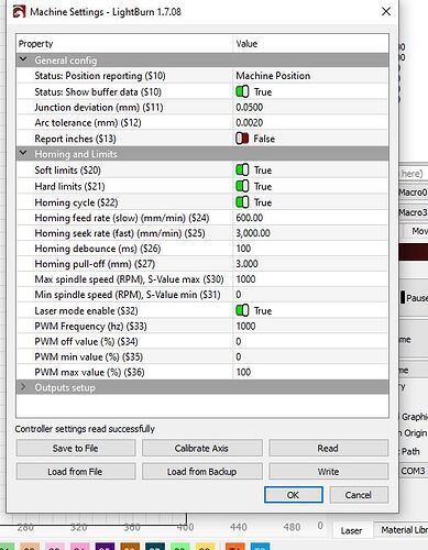

2 days in a row i have had tp ask for help,haven’t worked with my laser in over a year purchase a cnc router trying to lear it then seen the ortur yrc chuck rotary i always enjoy doing tumblers so got it trying to set it up got down to hitting the test button in rotary setup and nothing happens butthese warning popupsee screen shots i’m sure its something simple but still over my headit is wired in when i power up ortur master pro 2 rotary spins

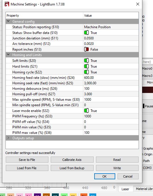

I do have limited switches one which I just replace couldn’t find one at ortur but replace with same value my work area is set at 400x400mm I have tried without job setup and with a job at current position and use position i thought I had turn off auto home I am adding some screenshot i hope will help you help me I
cannot thank you enough for trying to help me with this. i look for home switch under machine setting and device setting, I know it is something small that I’m doing wrong or not doing thank you again for the help
Try this. In the Machine settings Window, click save to file. That will give you a backup of your current settings that you can easily reload if needed. Then Turn off $20, $21 & $22. That will disable the limits and the homing cycle. You should then be able to use the rotary without the error message.
Just be sure to enable them when you go back to flat work. I woud leave Hard limits diabled at all times unless you have limit switches at all 4 corners, which i’m pretty sure you don’t.

Thank you that fixed it .if it does it again in 2 years I will have to check back with you, I’ll never remember what i done Kenny Lynn
