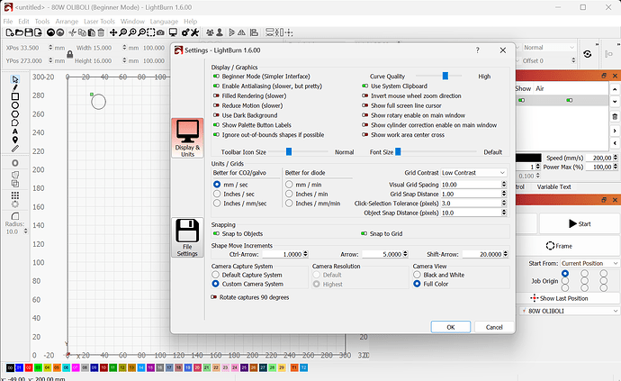

Hello Olivier
To validate that is not an settings issue, please share your LightBurn window showing the layers tab?
Also - as it might help - Edit > Settings and Edit > Device settings screenshots please

Hi Gilaraujo here is the screen capture. Thanks for your help !
