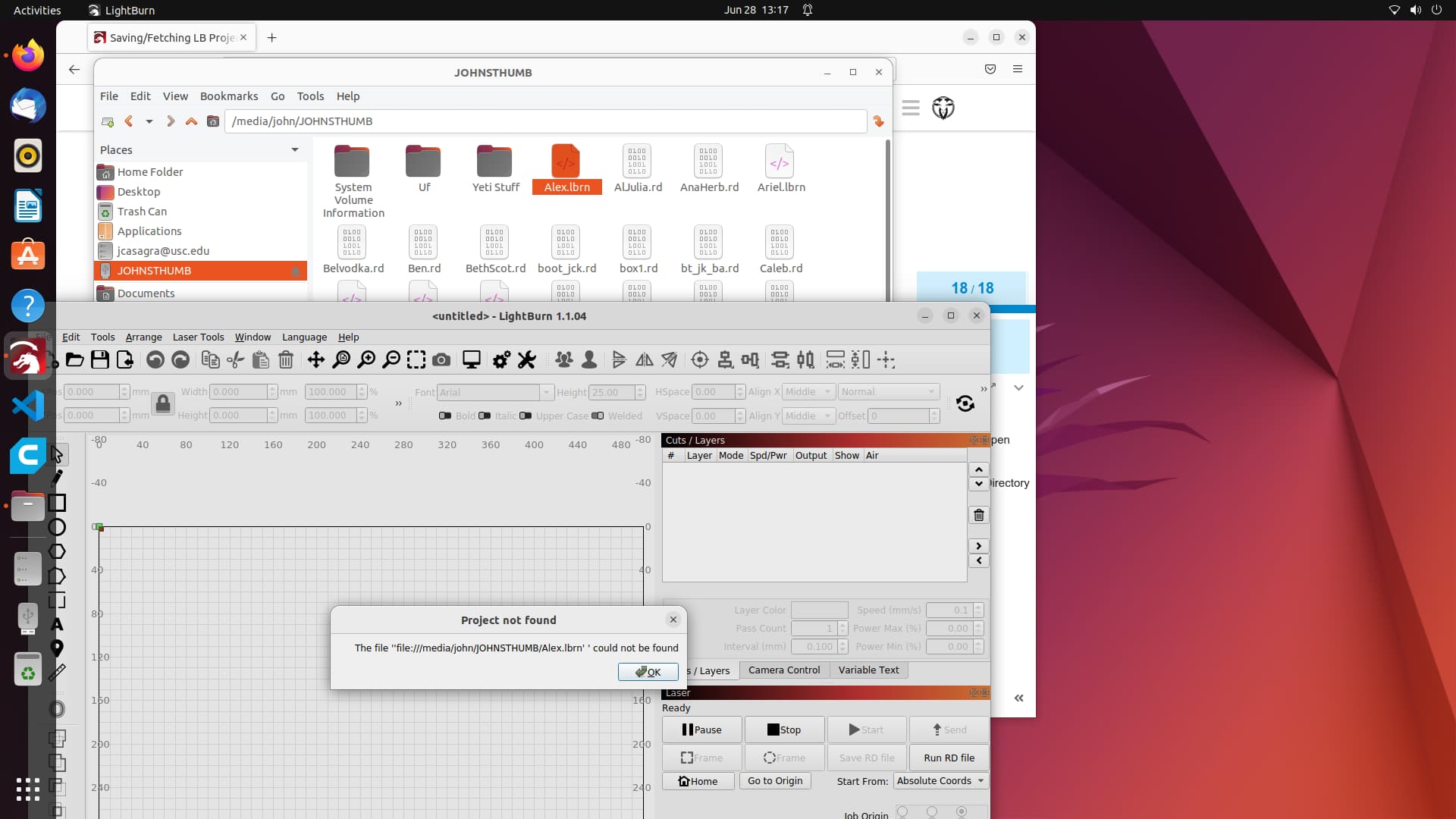

If I switch the File Settings, the behavior is the same; i.e., I can open LB, click on FIle Open and walk down the Directory tree to choose a project file and it opens the project.
However, if I use the File Manager, either Nautilus or PCManFam, and walk down the Directory tree to the same file; I get a File Not Found error dialogue box. See below:
Here is my Settings screen:
Oz,
Please look closely at the File Not Found error box; two different delimiters are used at the beginning and end of the Fully qualified filename string; a " and ’ '; a quote and two single quotes separated by a space. Is that what you intended to display?
