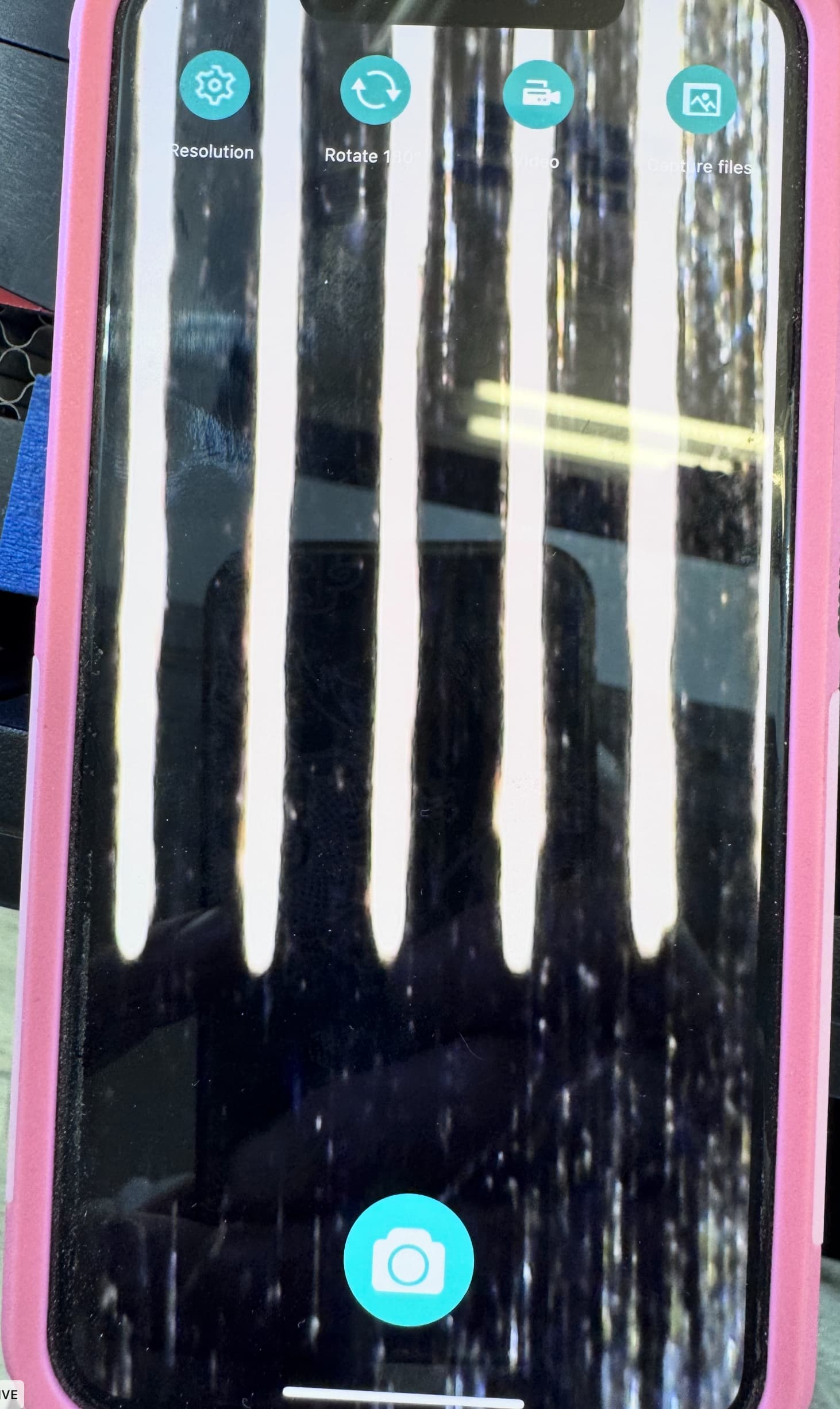

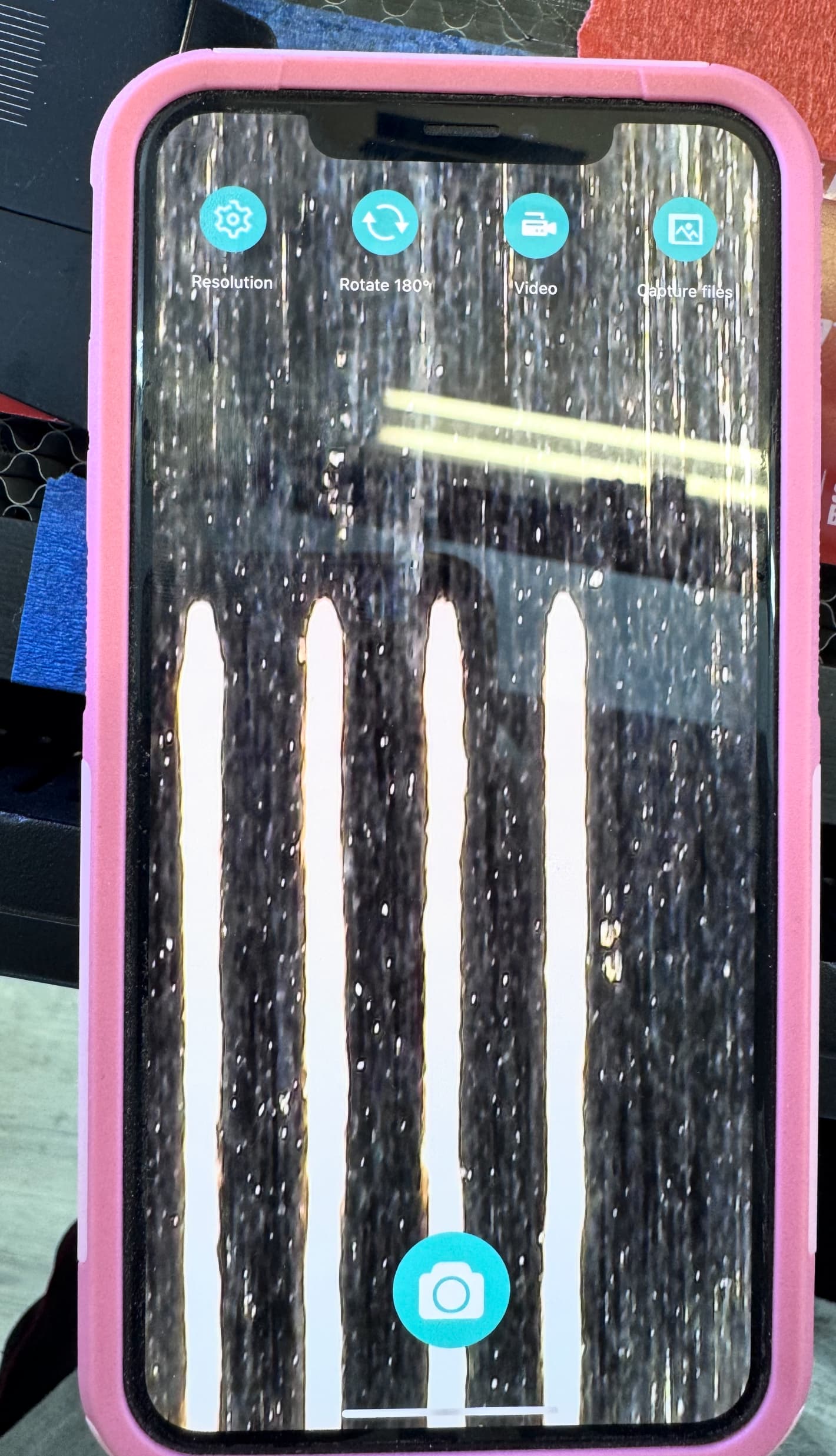

I decided to do a scan offset from 0 again to just start fresh. When looking at the .5LPI tests, they look perfectly aligned. When looking under microscope, I can get them to line up on the right… but the left side(starting side) never lines up… Or I can get them to align on the left, but not the right. Like I said, to the eye- minor shifts under microscope can’t be seen with the eye.

Right Side
Left Side

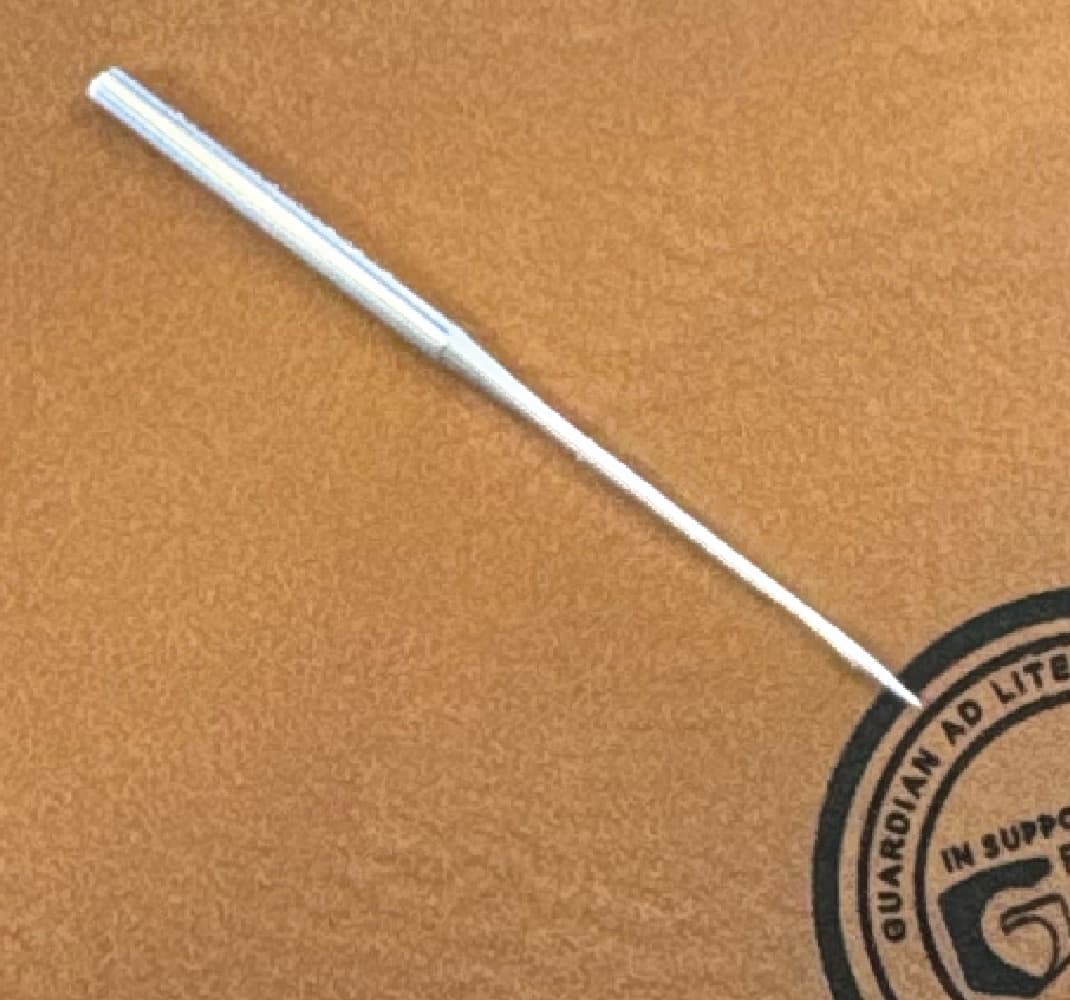

The circle outside of the letters is the size of a dime, thats a 65/9 commercial sewing needle which is slightly larger than your average house sewing needle. I started to see some of the aforementioned issues around this job, however - all of the letters are 100% readable for being that small. Was run at 400/317 - 1 pass.

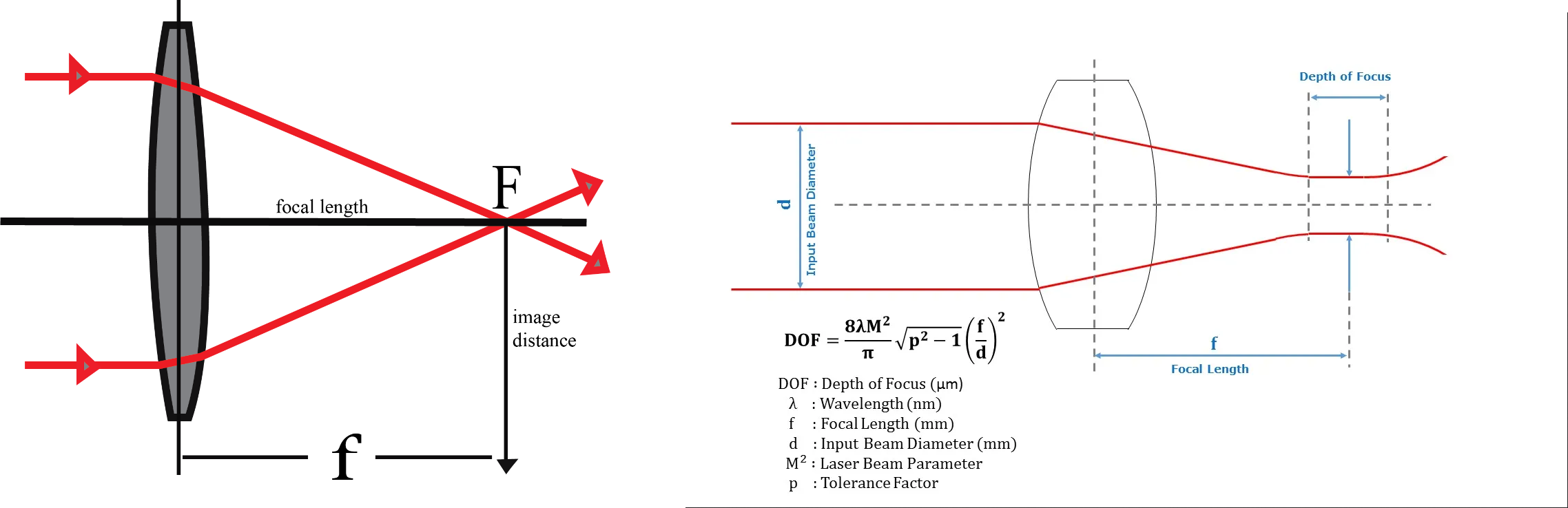

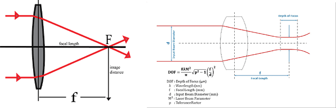

We already spoke about spot size. All lenses have a depth of focus (dof), in photography we call it depth of field, but it’s the same animal. We think of the many photos we see about how a lens focuses to a spot. In reality the lens focus to a particular spot has a dof associated with it. The left one is the main thought, but the right one is more of a reality.
The dof for a 2" lens is approximately 2.75mm. If you’re correctly focused, with a 1 mm change, you will still be within the dof of the lens and have changed nothing.

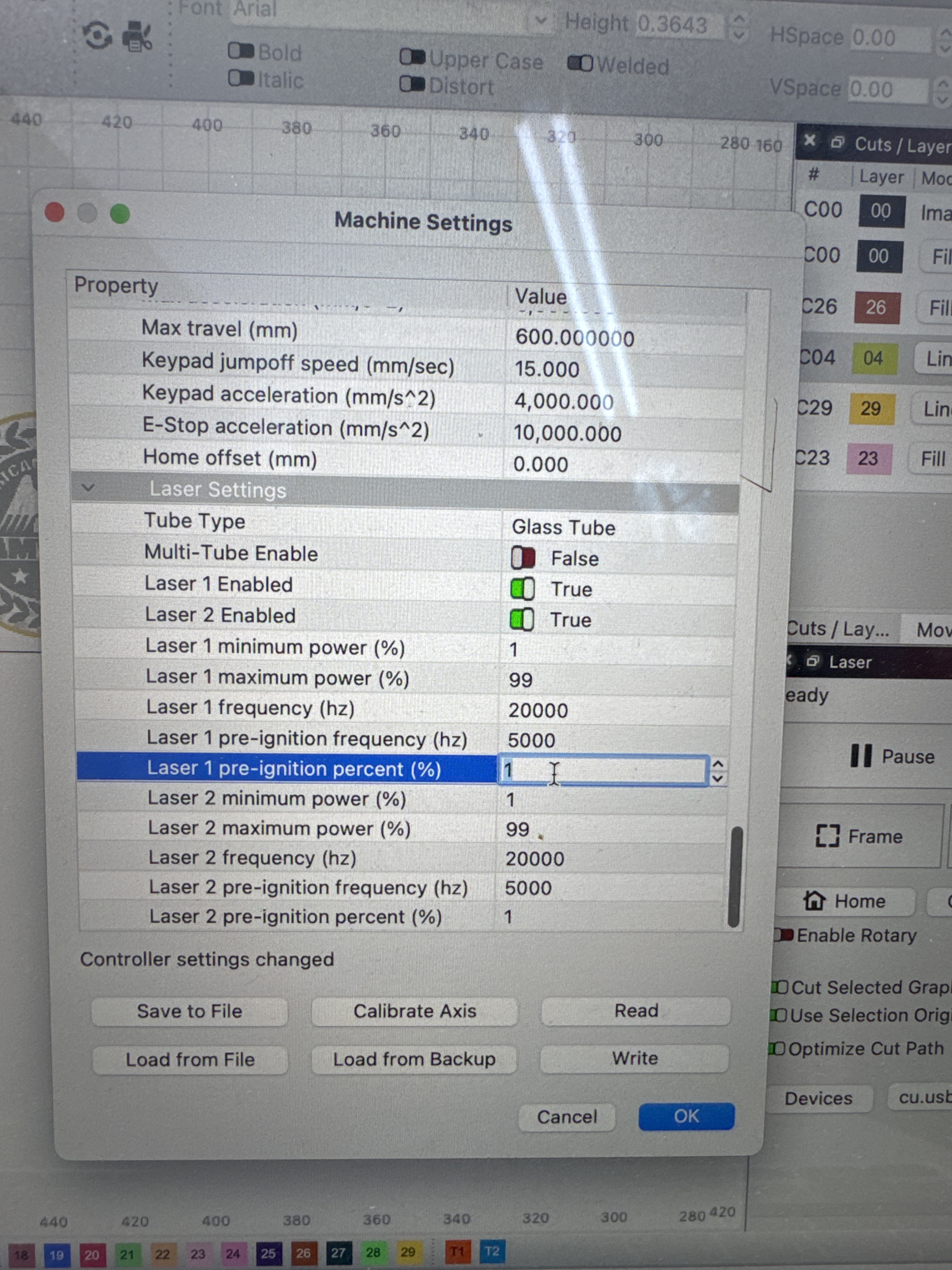

My Ruida and all the others I’ve seen have an initial pwm period of 50 microseconds (20kHz). Where is the power percentage you are referning?

At the bottom will be a picture of the settings in question. The starting frequency is set to 5kHz and running Hz is 20kz

Pre-ignition is only an RF metal tube option.

You’re looking at the turn-on and turn-off delays of the power supply + tube, which are almost symmetrical. Your pictures show some differences in adjacent lines, but overall they look just fine.

The Scan Offset Adjustment assumes symmetrical times and can’t compensate for any differences, so stop when you’ve gotten results Good Enough for naked-eye inspection.
