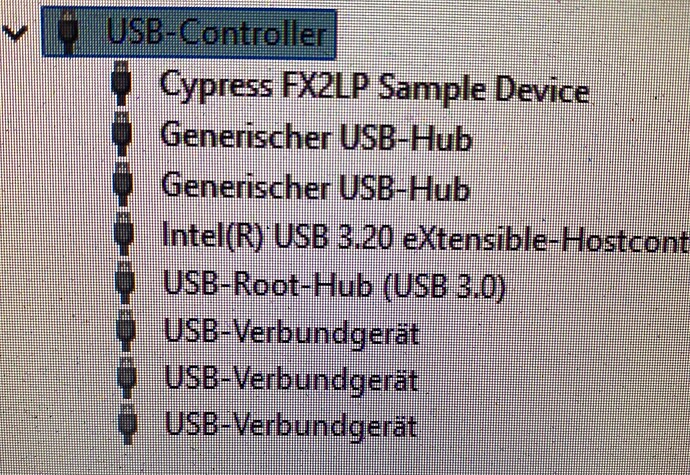

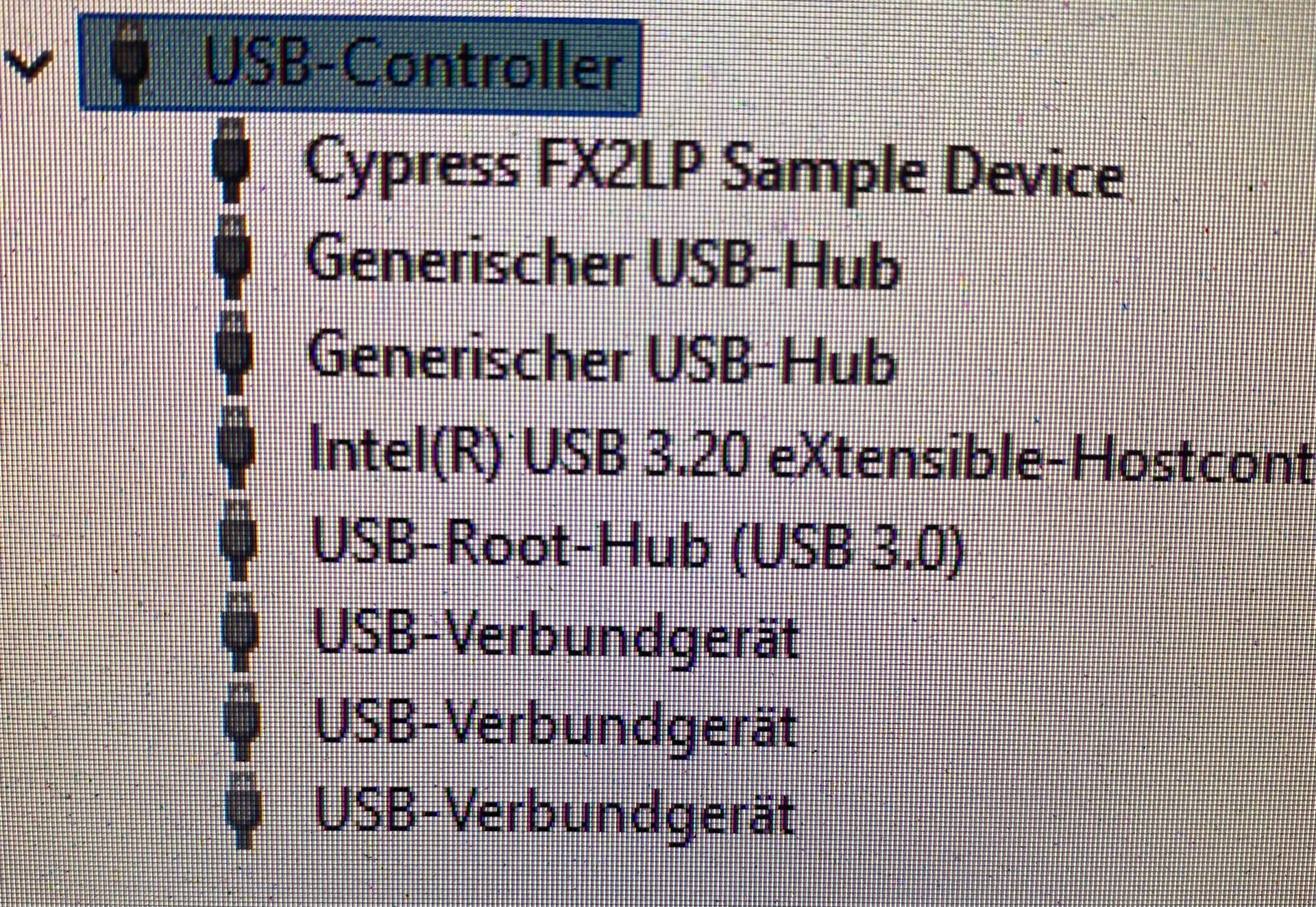

Right Click on your Windows Menu > Device manager
Plug and power on your G9 and see if you can see where the device pops up.
Device manager will Blink as it updates.
it shows up under USB Controller -
As Gil said, you need to install the Cypress driver. Did you try SGD laser application to control it? LightBurn is not officially supported yet. You need to import a device profile for the G9 which is not officially available yet. Though I can provide it to you for testing purposes (there are still quite some issues to be solved).
Could you please share a screenshot with us?
