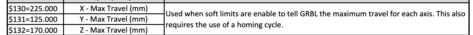

Your $130, $131, and $132 values are the max travel. I would change these, but you might want to ask Sculpfun why their firmware is like this first:
Your parameters are all out of whack. I am guessing you did not save a copy of them before flashing the controller board.
Visit @misken 's website to get the S9 settings. You will have to set $130 and $131 to fit your particular frame size
Here is a Topic about changing the parameters. Ignore the LaserGRBL reference.
