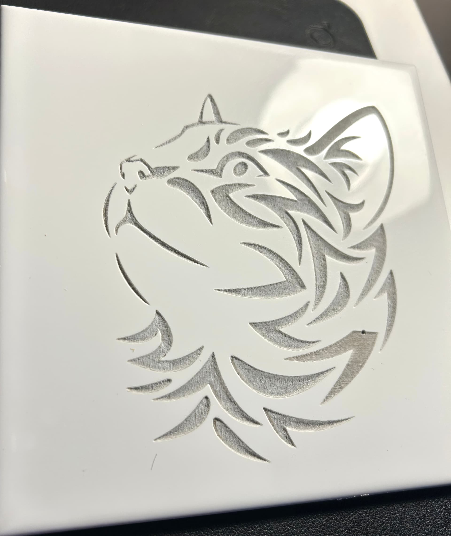

This is a 6-inch plain white ceramic tile, which was engraved using the Sculpfun SF-A9 40W. I wanted to discover what was needed for an engraving without using titanium dioxide or laser-engraving paper. The power was set to 40W at 100% and the traversal speed was set to 1000mm/min. I used a digital caliper to ascertain the depth of the burn. The engraving depth varied from 0.19mm to a maximum of 0.55mm. The burn time was 1 hour and 11 minutes.
The pinhole is where the Sculpfun tilt sensor stopped the proceedings. It is the result of the five seconds to cross the room, open the enclosure, and hit the emergency stop button when hearing the tilt alarm. I was unsuccessful in discovering how to turn the sensor off. Sculpfun were unwilling to discuss the matter with me. I intend to fill the engraving with powder coating paint and gently heat the tile from underneath. This will give me access to the colours I want to use.

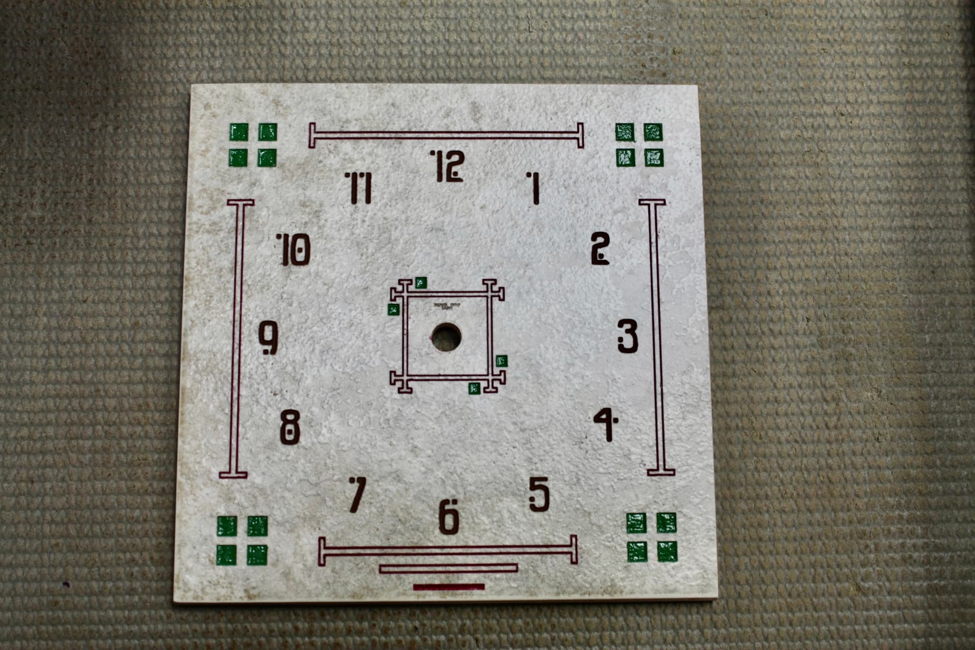

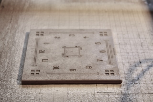

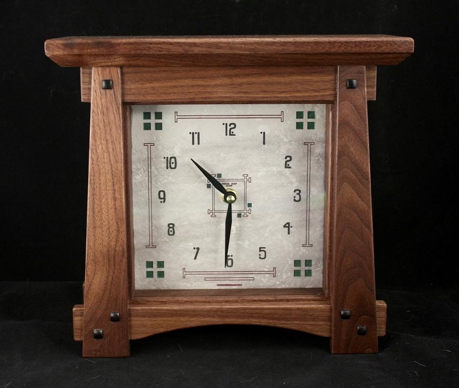

I’ve done similar deep etching on tile with my 10W diode. The depth allows for acrylic paint fill so colors besides TiO2 black can be achieved as with this clock face:

I believe I was getting down about 1/16" (1.5mm) with two passes at 80%. Don’t recall offhand the speed, but probably 8mm/s (I can look this up later if you really need the specifics, not at the machine at present).
The tile etched easily, but tiles are different base materials. I don’t think this tile was porcelain (high temp). Just a texture-glazed tile from a home center. I have done the standard “cheap” white glaze bathroom tiles as well. but didn’t try going as deep.

The detail is good, but I was pushing the limit on some areas like my logo directly above the clock hub at 12 O’clock.

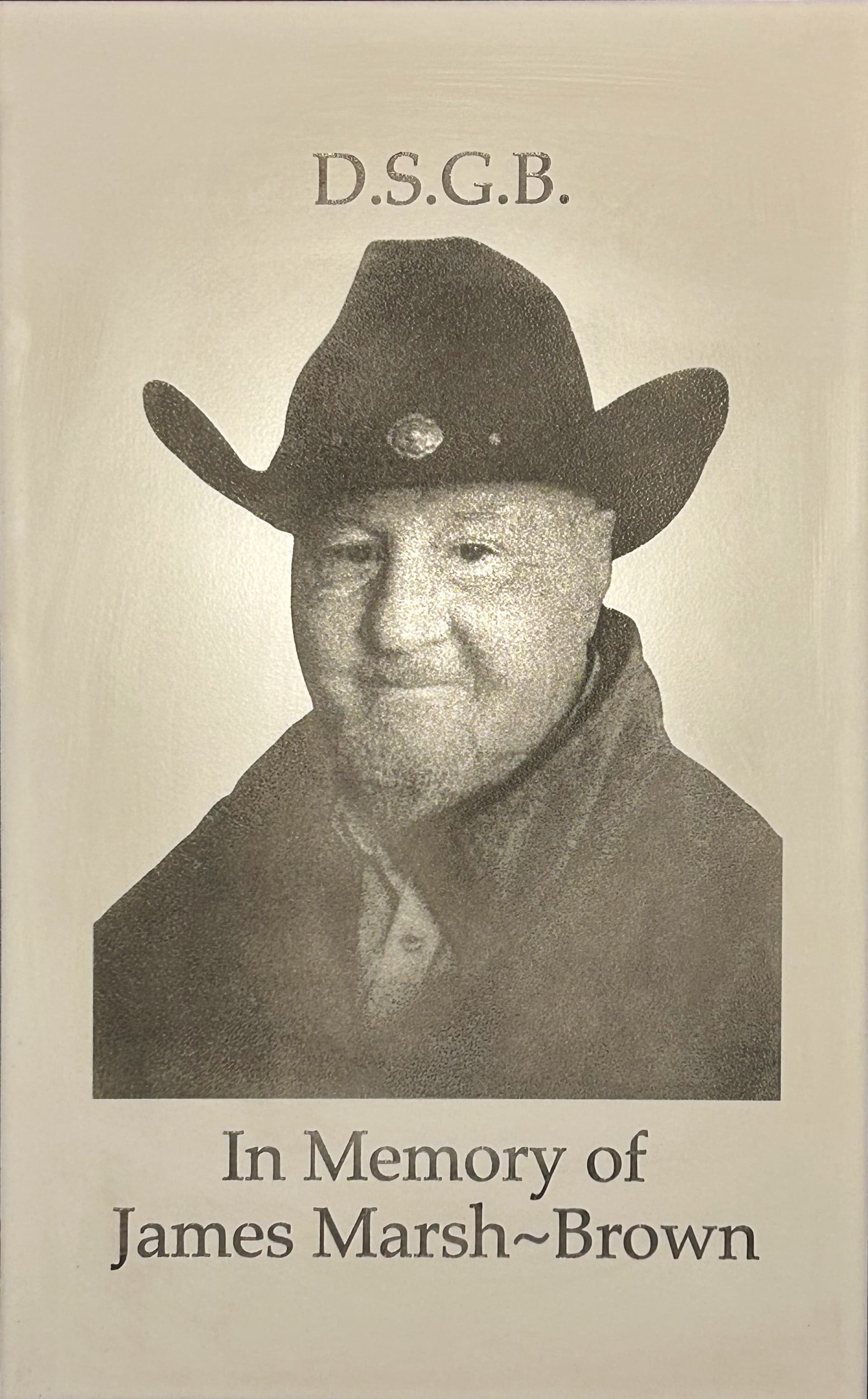

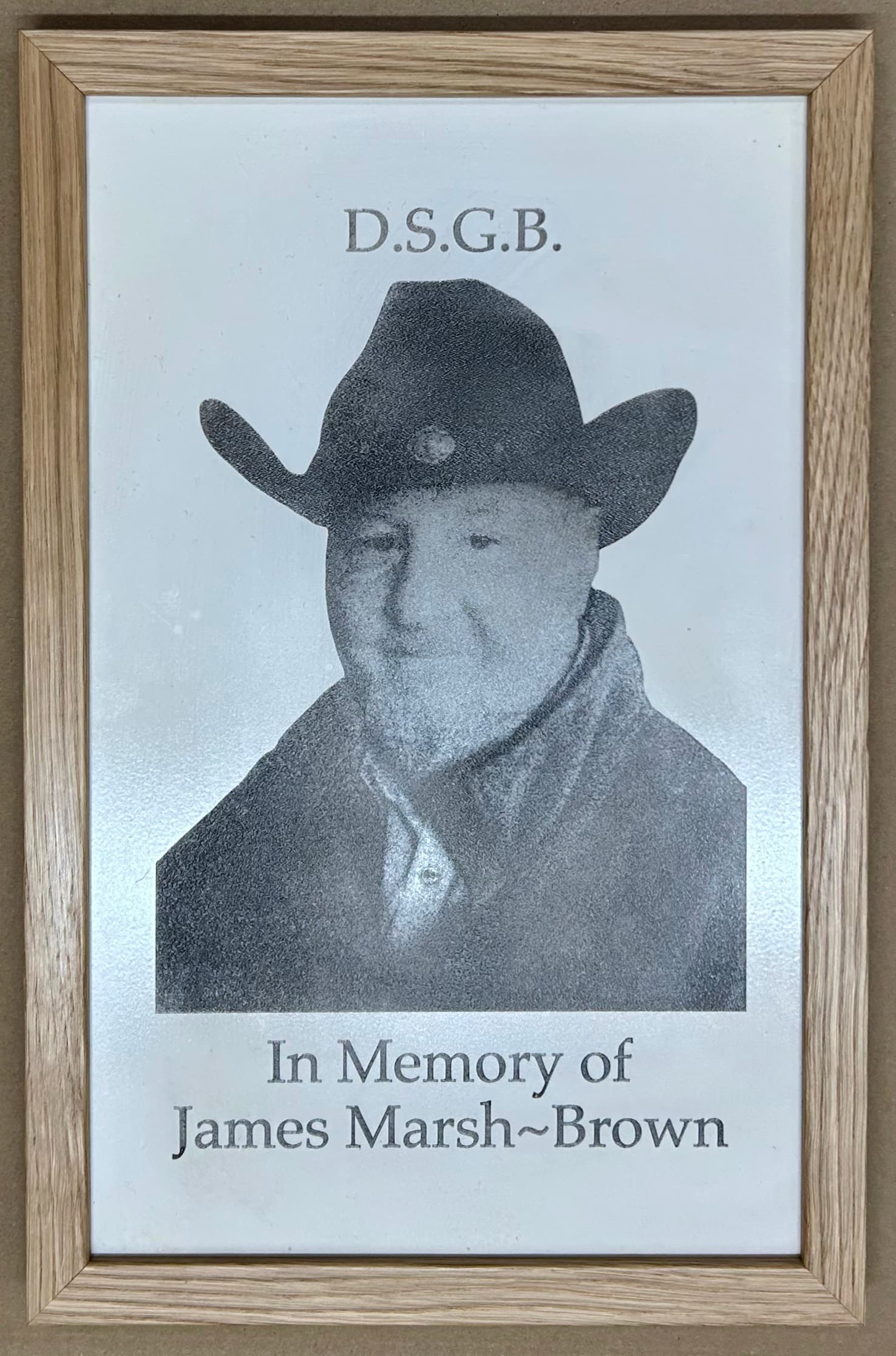

Further to this issue of disabling the tilt sensor, I have run a one-hour job without any stoppages. The image is a 400 x 250mm matt white ceramic tile, which is not complete. It could use a little additional black paint on the text. With an ash frame and some picture hanging components, it will be finished.
40 Watts at 80% power, burning Rust-Oleum Painter’s Touch Matt White spray paint. The traversal speed was 6,000mm/min. Paint removed with an acetone wipe.

The completed job is done now. A finish of clear varnish to the tile and beeswax to the frame. Hardboard backing to hold the tile in place and sealed in with a very sticky frame tape.

I ran that tile at 80% and 5mm/sec, 2 passes. Air flow at about 10L.
Different tile base materials (ceramic/porcelain/etc.) will make a difference but I too was surprised at the ability. I think the air flow has a big effect as the tile material gets fractured and the air clears out the waste.
