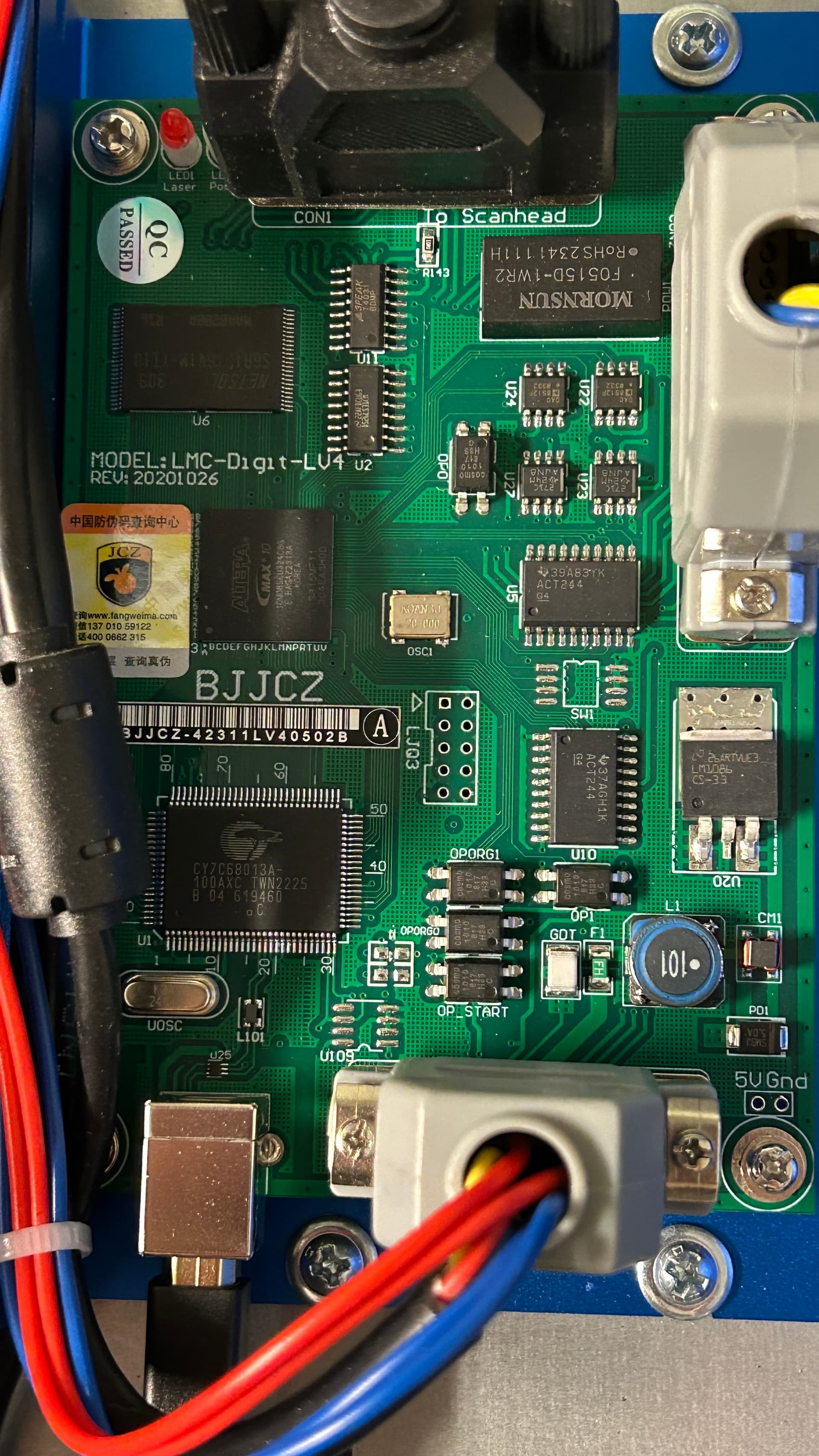

My controller board for my UV laser is not communicating ok with LightBurn. I need to get back to my supplier with a request for a board to be sent to me. Where can I find information on which board I should ask for?

What controller do you have now? The BJJCZ board for CO2/UV comes in lite or standard, either will run a rotary axis. The standard will run 2 outputs but not sure if LB will. I don’t have a UV but watched some videos on LMA when they first brought one in for testing.
https://forum.lightburnsoftware.com/uploads/default/original/3X/e/c/ec56bbe64f2e8e46ec7ac616cb13c752f7992906.jpeg
This is my card, but not working as it should. :frowning:
Should be fine with a UV. What exactly is the problem? “not communicating ok” doesn’t really give much to work with!

looks like a driver issue; have you tried the steps mentioned here?
If this is a relatively new machine, I’d suggest you just email the vendor and ask. Most are willing to help if you give them time to work. Most of the time seems to be just getting the idea of the issue across to them.
You can put in EZCad2 drivers and see that package works, that would identify or eliminate the issue as the board or drivers. The two seem incompatible in a Windows system.
