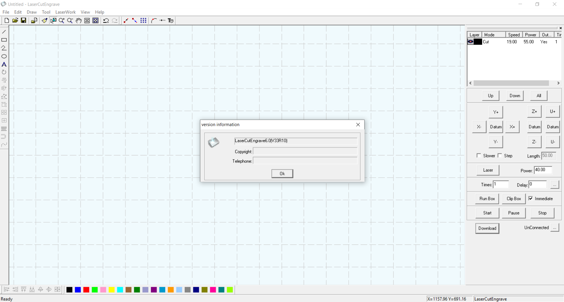

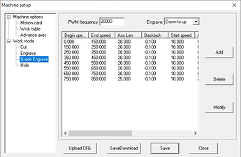

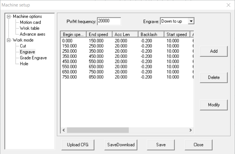

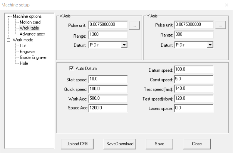

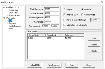

Software that I currently used is called LaserCutEngrave and looks like this:
A slightly different controller, but it should be relatively easy to swap them out.
Setting up the controllers configuration might be a bit more time consuming.
Thanks for the response, Jack! I will order the Ruida 6445 in the next 3 weeks. Since I’m new to this, I’m going to take a structured approach to the installation:

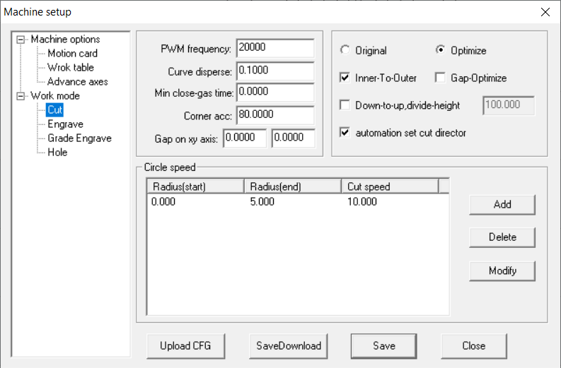

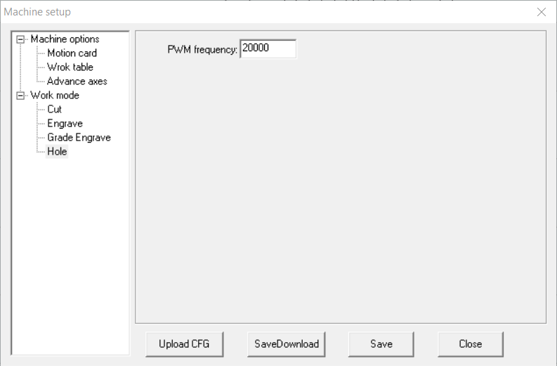

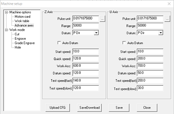

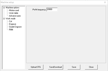

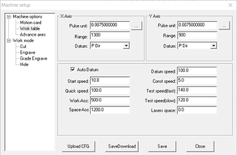

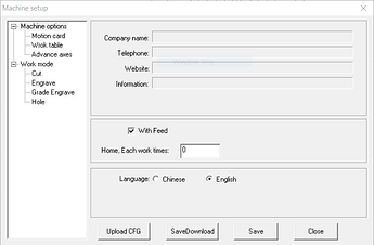

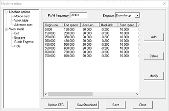

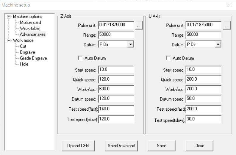

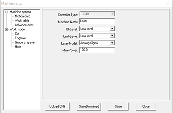

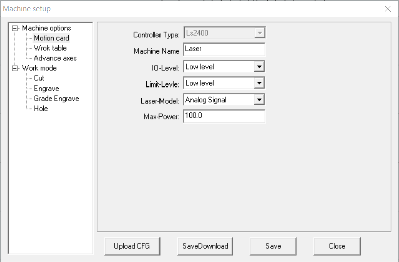

  • First, I’ll gather as much configuration data as I can from the old software. I’ve seen recommendations in another thread about this, and I’ve already taken some screenshots… But I’m not entirely sure if they contain the necessary settings. If anyone can confirm, that would be a big help.

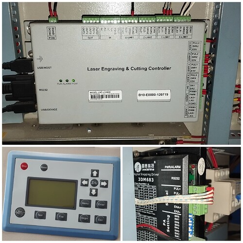

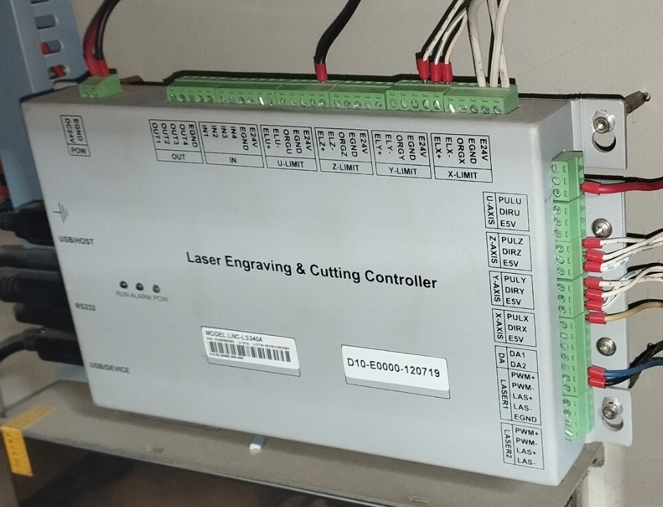

  • Next, I’ll create a simple wiring diagram using photos from my machine. I’ll share it here before making any changes to ensure everything is correct and to avoid damaging anything. Plus, it might be useful for others attempting the same upgrade.

The laser itself is fully functional but about 12 years old. It originally belonged to my father, who passed away. The machine only has X and Y axes… No Z, no air assist control, and no safety switches… Which I assume simplifies things, though I’d appreciate any insight on that.

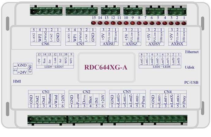

Sorry for the double post, but I’ve taken more photos and looked more at the manual for the Ruida 6445 controller, and I’m still unsure where all the wires should go. Some connections are obvious after going through the manual, but others I have no idea. I’ve compiled a list of what I have so far:
POW DC24V Goes to CN0 +24V
POW EGND Goes to CN0 GND
U-LIMIT EGND Goes to ?
Y-LIMIT ORGY Goes to ?
Y-LIMIT EGND Goes to CN4 GND
Y-LIMIT E24V Goes to ?
X-LIMIT ORGX Goes to ?
X-LIMIT EGND Goes to CN4 GND
X-LIMIT E24V Goes to ?
U-AXIS E5V Goes to CN3 Puzu
Y-AXIS PULY Goes to AXISY PUL/cw
Y-AXIS DIRY Goes to AXISY DIR/ccw
Y-AXIS E5V Goes to AXISY +5V
X-AXIS PULX Goes to AXISX PUL/cw
X-AXIS DIRX Goes to AXISX DIR/ccw
X-AXIS E5V Goes to AXISX +5V
DA DA1 Goes to ?
LASER1 LAS- Goes to ?
LASER1 EGND Goes to CN5 GND
If anyone with experience can shed some light on the wiring, I would really appreciate it! I’m still learning about this stuff, so if I misunderstand something, I apologize in advance. I can provide more pictures or details if needed.
Seems sensible that the power goes in the POW connector.
Assuming these are active home switches, since they have a 24V supply. You can pick up 24V anywhere on the Ruida, but I’d suggest you pick this up from the 24V power supply, although the Ruida should handle it ok.
Both limits switches will go to the negatively marked axes limit, X would go to CN4-4 LmtX- input of the Ruida. The other two wires are ground and 24V power for the switch.
I suspect the ORGY is their name for the machines origin for the Y axes.
Since you don’t have a U axes, I have no idea where they are using the ground EGND. The PUZU is a 5V pull up if you need it, relative to ground it’s 5V so it’s likely they just picked it up to use it elsewhere… you’d have to chase it down.
These 5V taps are current limited, so check it in the manual if you decide to use them.
Seems like all of these are for the laser control. I am clueless as to what they use the DA and DA1 are. You’d have to look up what they use it for.
LAS is likely laser enable and you want the LAS- to go to the L input of the laser power supply (lps). This goes low to enable it to lase at the current power setting.
This should get you started… Sing out if you have any more questions.
Good luck
Thank you again, Jack! That does helps a lot, I was able to fill in some of the missing connections. I’m still not entirely sure if everything is correct or safe to wire up as-is, but I have time to figure it out since the controller hasn’t arrived yet.
Here is the updated list:
U-LIMIT EGND Goes to CN4 GND
Y-LIMIT ORGY Goes to CN4 LmtY-
Y-LIMIT E24V Goes to CN0 +24V
X-LIMIT ORGX Goes to CN4 LmtX-
X-LIMIT E24V Goes to CN0 +24V
U-AXIS E5V Goes to AXISU +5V
DA DA1 Goes to ?
I also found this in the LS240A manual:
DA1 - Laser 1 Analog output port (0-5V)
DA2 - Laser 2 Analog output port (0-5V)
PWM+ - Laser power differential signal (+)
PWM- - Laser power differential signal (-)
LAS+ - Laser high light
LAS- - Laser low light
EGND - Laser power ground
But i’m not sure how these correspond to the Ruida controller. If anyone has insight into what those could be please post I will get a multimeter soon so I can try and trace wires as well.
The pwm from the controller goes to the IN of the lps. This input is actually a dual digital/analog input. Analog control one, as in most things, history, but these lps work with either.
You can use them to drive the IN of the lps, but I’d suggest you use pwm as most of todays machine generate.
Don’t know why I didn’t think of analog… I’m quite aware of it.
Looks good…

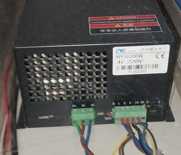

Thank you for the reply, I’m not sure I’m following… There are H, L, P, G, IN and 5V on the power supply.
H is unused
L needs to be connected to CN5 - L-ON1
P needs to be connected to CN5 - LPWM1
G needs to be connected to CN5 - GND
IN needs to be connected to ?
5V is unused
Ruida LPS
L-On1 L
LPWM1 IN
GND G
The P connection is the Water protect circuit in the lps, so it’s usually strapped to ground, making it active.
The Ruida should be wired to your flow meter or chiller and that should let the Ruida know there is an issue. If that occurs, the Ruida will stop everything… You can also fix the issue and continue.
Make sense?

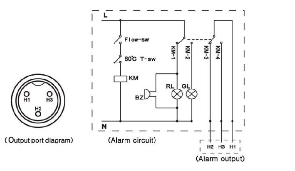

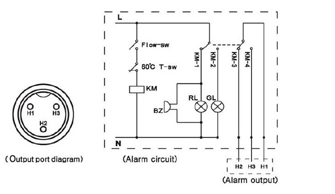

This is from the 3000 series chiller user manual and shows how the fault output is implemented. The manual I have, even translated is mostly Chinese or I’d post it.
If you think about the relay being in it’s other state, illuminating GL (green light). Now follow the H3 pin of the connector through the relay to H1.
This just completes the the ground for the WP input on the Ruida.
Only needs two wires.
You can see the connection from the OMTech to the chiller in the photo. It’s the black line ending up at the connection next to the mains power.

@jkwilborn If I understood correctly, I need to connect H1 to CN5 WP1 and H2 to CN5 GND. Additionally, on the LPS, I should bridge P and G to bypass the LPS’s built-in water protection and let the controller manage it instead. Did I understood that correctly? Thank you once again!

Appears so.
