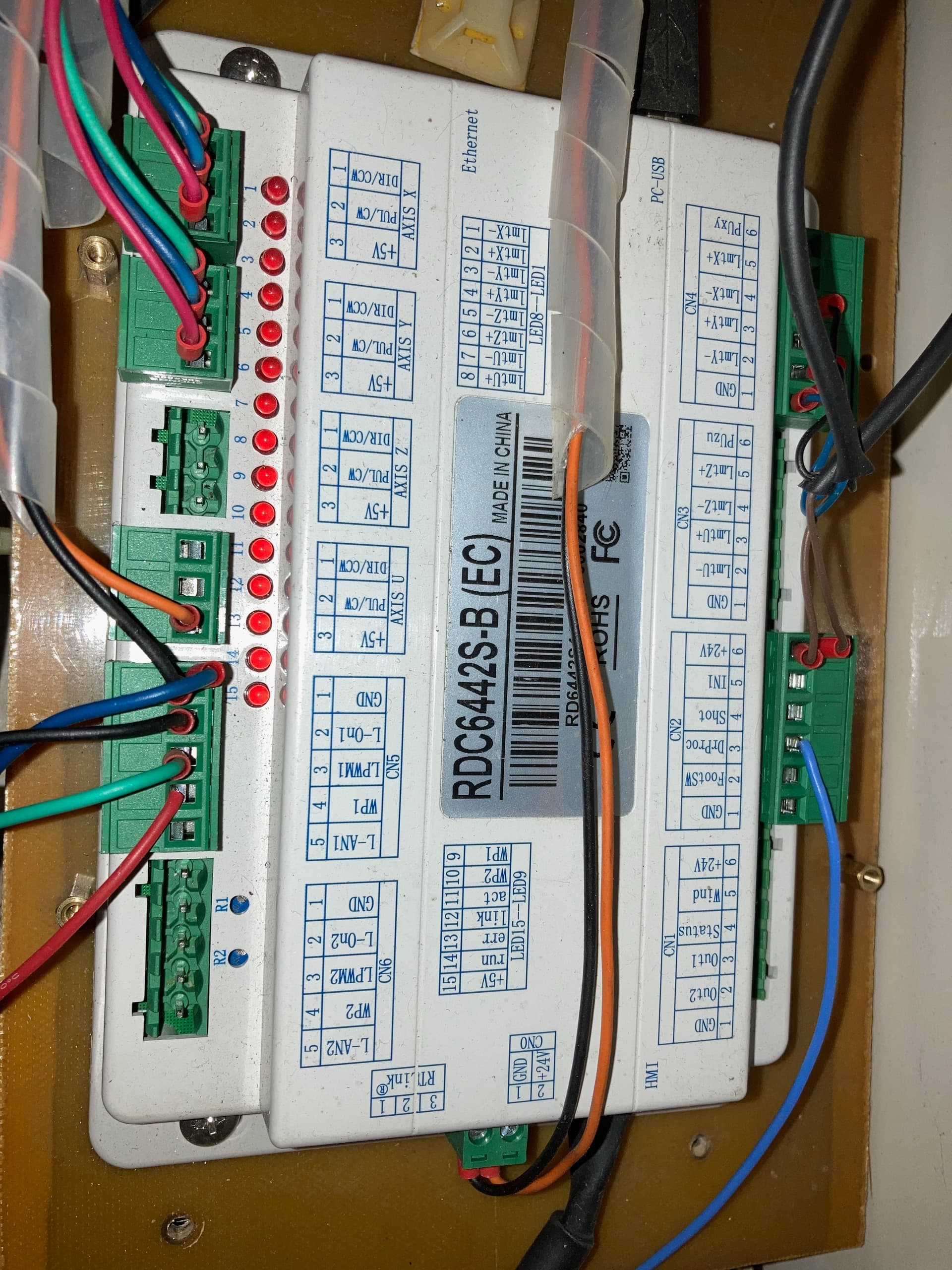

here is a photo of the ruida connections showing wp and the lid protect connections
We were speaking about the lps, not the Ruida. The Ruida will handle both errors if you wire the door to CN2-3 DrProt and the Chiller or flow sensor to CN5-4 WP1.
I can’t look at either the Ruida or the lps in a photo and tell where the wires actually go once they leave the photo.

Can you post a current picture of the wiring on the LPS?
In your previous picture in post 51, you do not seem to have the water protect pin on the LPS connected to ground. There should be a wire jumping between the 4th (WP) and 5th (G) positions (counting from the LEDs). The WP on the LPS should not be connected to the WP on the ruida.
I have the ground wires for both switches connected to a ground screw on the chassis
Not asking about the switches. On your previous picture you posted of your LPS, you had nothing connected to the WP position on it. Do you have anything connected to the 4th pin from the LEDs on the LPS? Can you post a picture of the LPS showing how it is currently wired?
I currently have the wp connected to #WP1 on CN5 of the ruida and the other wire of the switch grounded to the chassis of the machine.
Can you clarify which way things should be
So far you have been the most help to me and I have followed your instructions. Before I make any changes I want to keep on the same page that you got me started on because you have been right so far on all this
good morning, as mentioned before
Independent from what you have done with the wp pin on the controller:
On the power supply you need a wire from wp to gnd, just a simple wire
Without that it will not work,
From what I read from your post you do not have that yet right?
These are two seperate systems. I’m advising you let the Ruida handle the faults instead of the lps.
The wp connection to the lps should be grounded. This will allow the lps to lase when needed.
L-WP1 is an input, as WP on the lps is an input. Most devices have an output that drives some other devices input…
L-WP1 is where your coolant switch to ground should be connected. This allows the Ruida to control any faults and to continue if the operator makes that choice.

OK, back at it again. I put a jumper from the WP to the ground terminals on the LPS. I have one wire from the water switch to the WP1 on the ruida and the other to a chassis ground. I put one wire from the lid switch to the DrProc terminal on CN2 of the ruida and the other to chassis ground. now the laser fires as it is supposed to. HOWEVER… I have no control over the power. Seems to be maybe at 10% max. I have the setting on the dashboard of the machine MIN Power. 5%, MAX Power 99%. Settings in the Machine Settings of Lightburn. min and max same as console. FREQ 20000. pre ig freq. 5000. pre ign. % 1.
