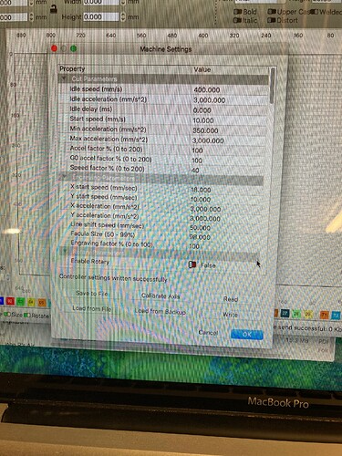

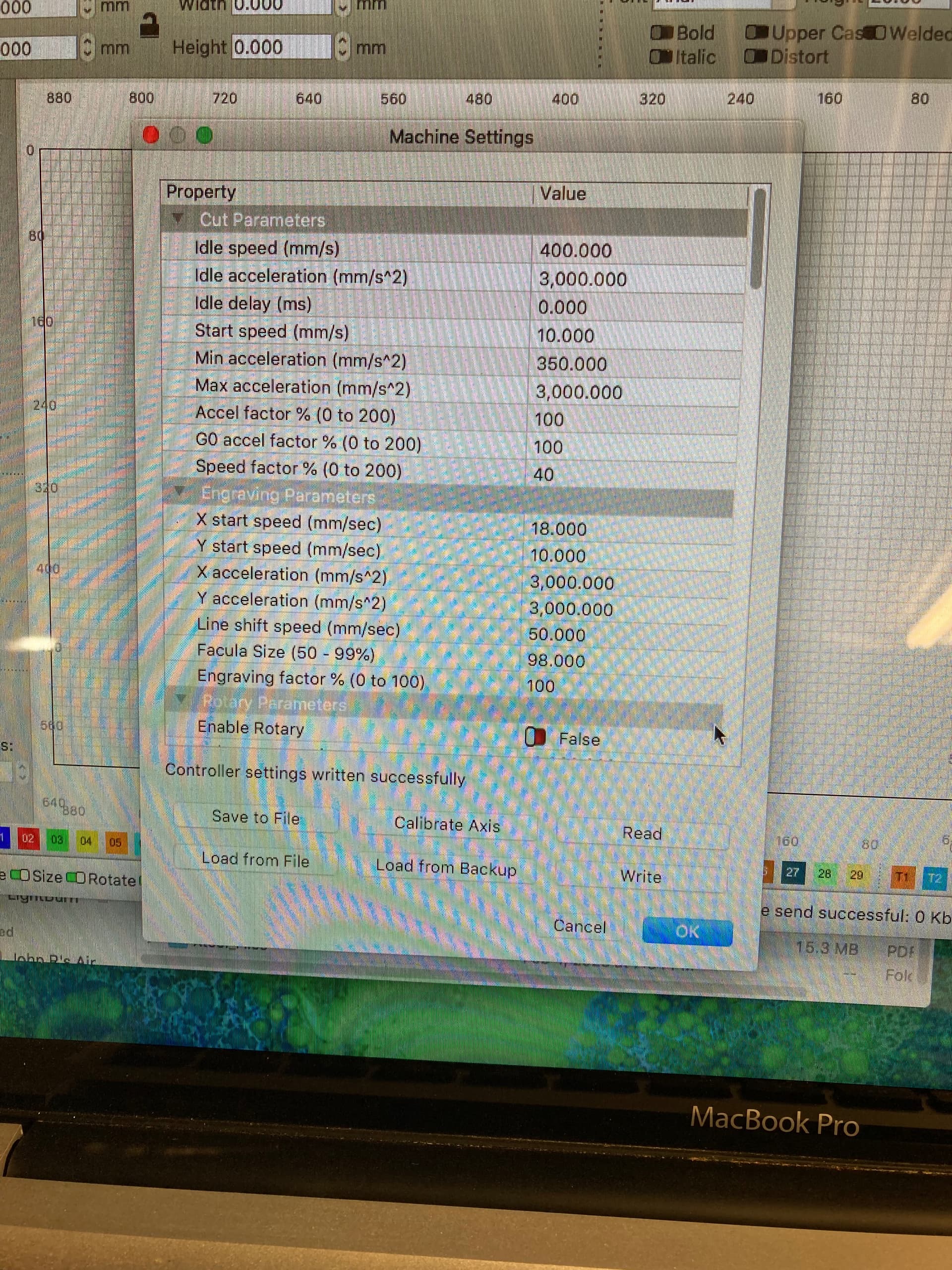

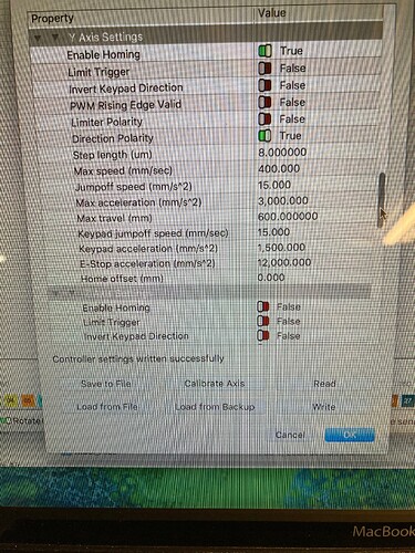

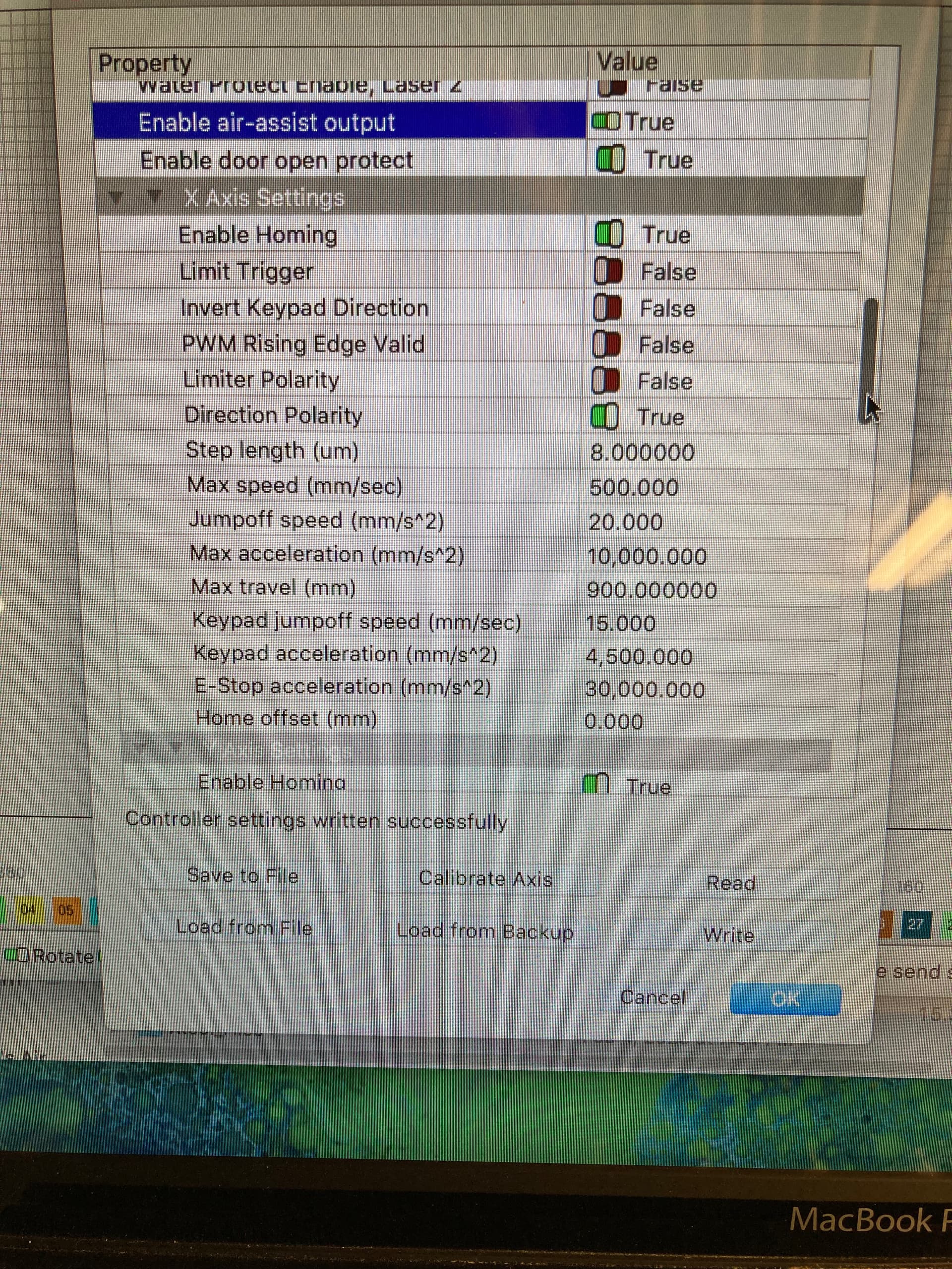

I am now stumped. with the plug with the controller wires in it, unplugged from the lps , I push test button on lps… laser fires. plug this back in, close lid switch, water on, push pulse and get nothing. here are the screenshots of my settings…
This is correct.. If you unplug the control signals you can test fire the laser from the lps.
If the Ruida doesn’t have an error, then it doesn’t know there’s an issue.

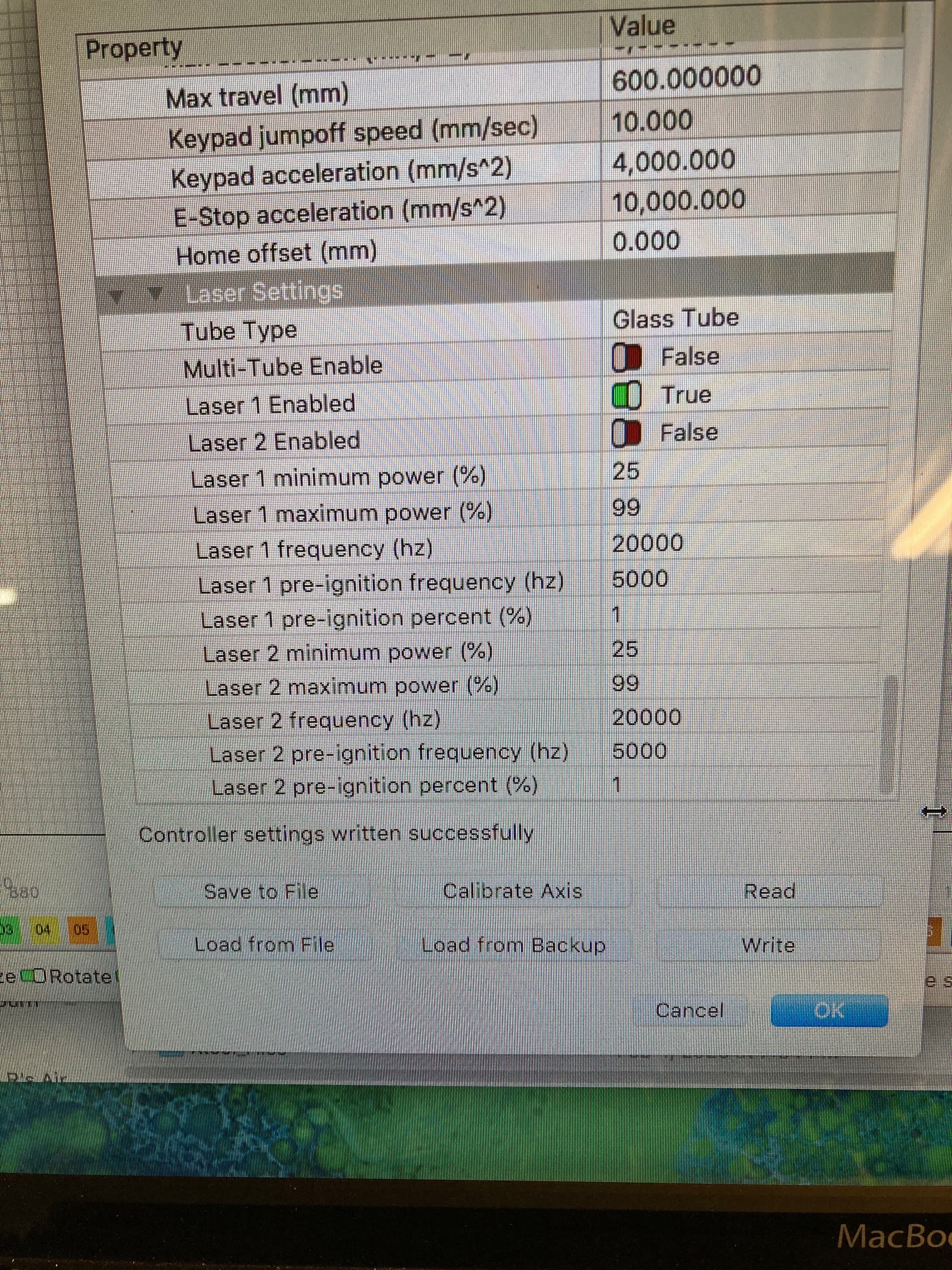

Might want to check what power and pulse width time the controller is set. You have to do this from the machines console.
Hi Jack
I have the laser set to manual and 20ms
nothing fires with the pulse button

Did you ensure you have power set high enough to reliably lase?

Is the water protect of the laser psu tied to gnd as well? If not, mine would not fire without the water protect of the psu being tied to gnd. (but that should be in the manual for your new psu)
