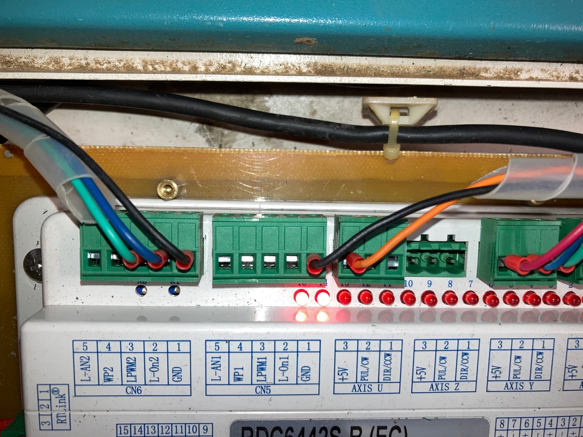

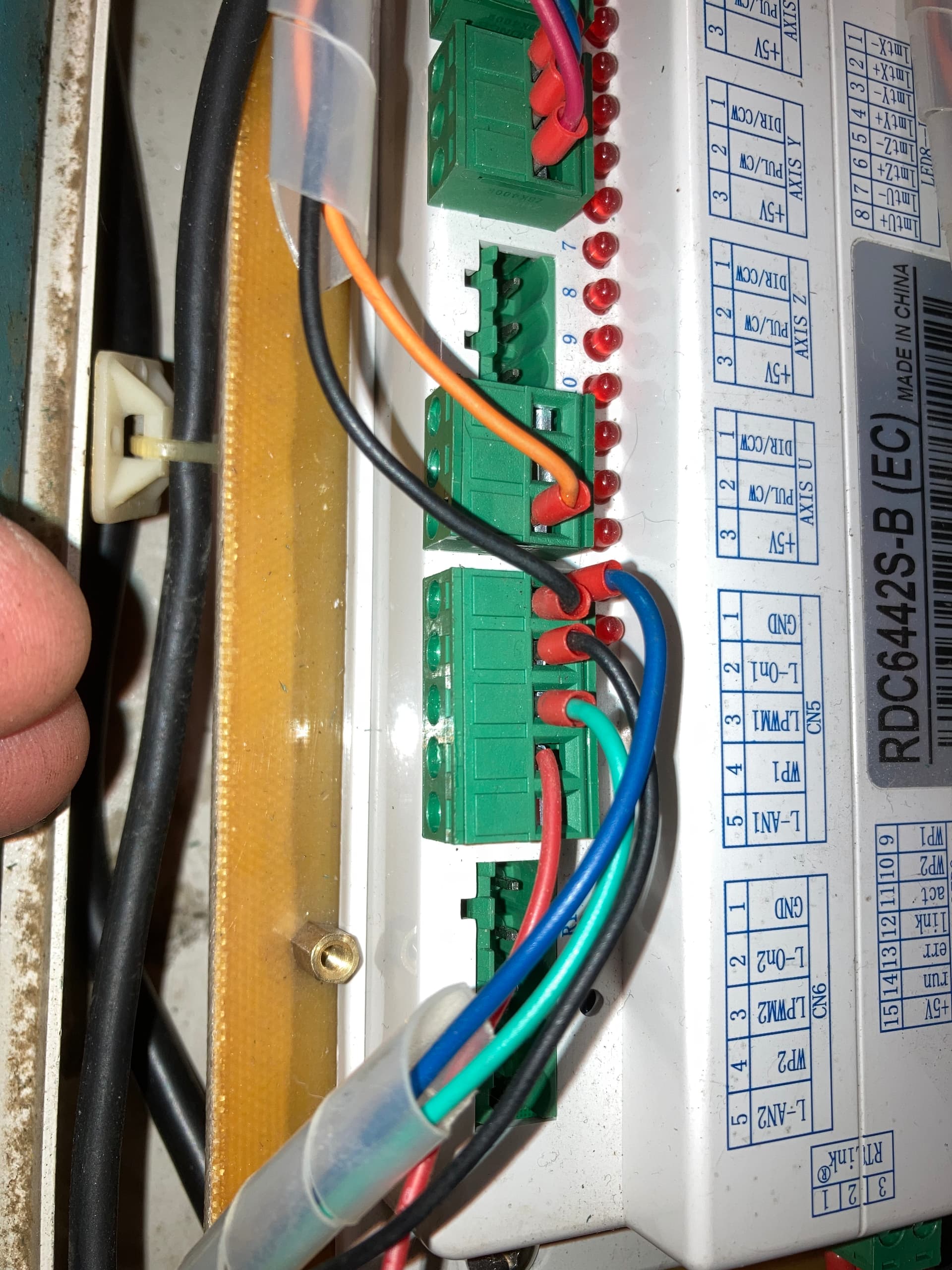

From your # 9 post, this photo shows your machine is wired to CN6 (laser 2) instead of CN5 (laser 1). Just swap the two connectors and it should work using laser one settings.
Black wires only, are both at ground level, so you can swap those between the connectors if you need too.

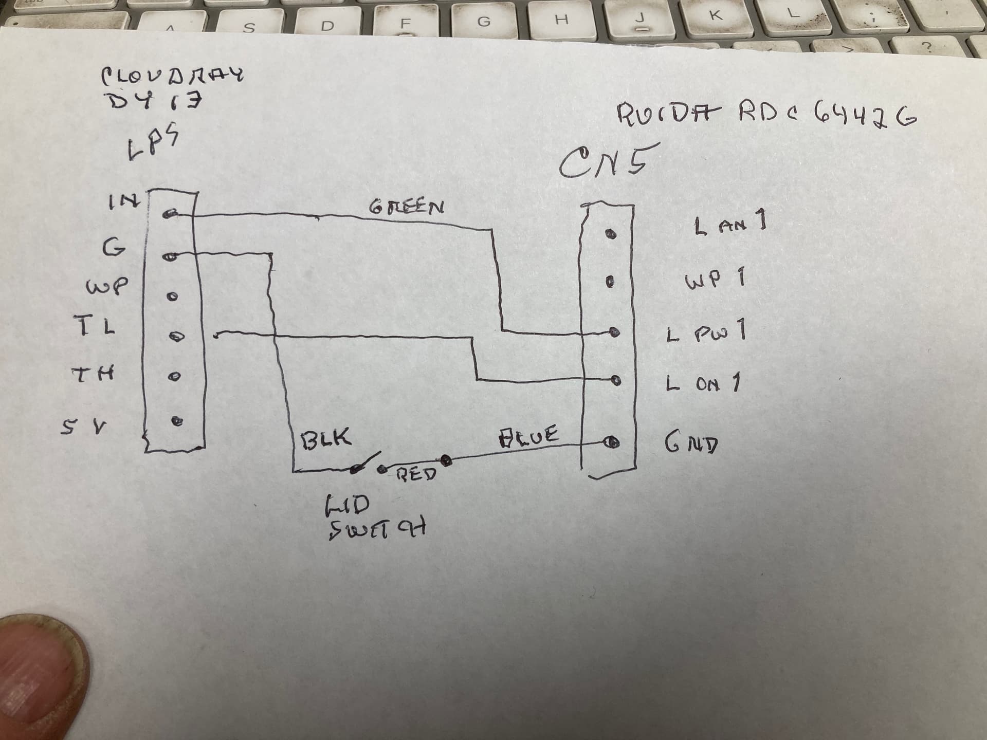

Jack, thanks for the reply. the way I had it wired did not match your little chart here so I changed things so it is like you show. as of today March 22 here is how I have things wired . before I changed the wiring I though I would test to see if the laser fired and all I did was press the top door close switch and it fired so I quit because that meant some how I had it wired wrong. This has to be something simple now as we are down to almost everything working

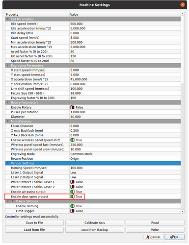

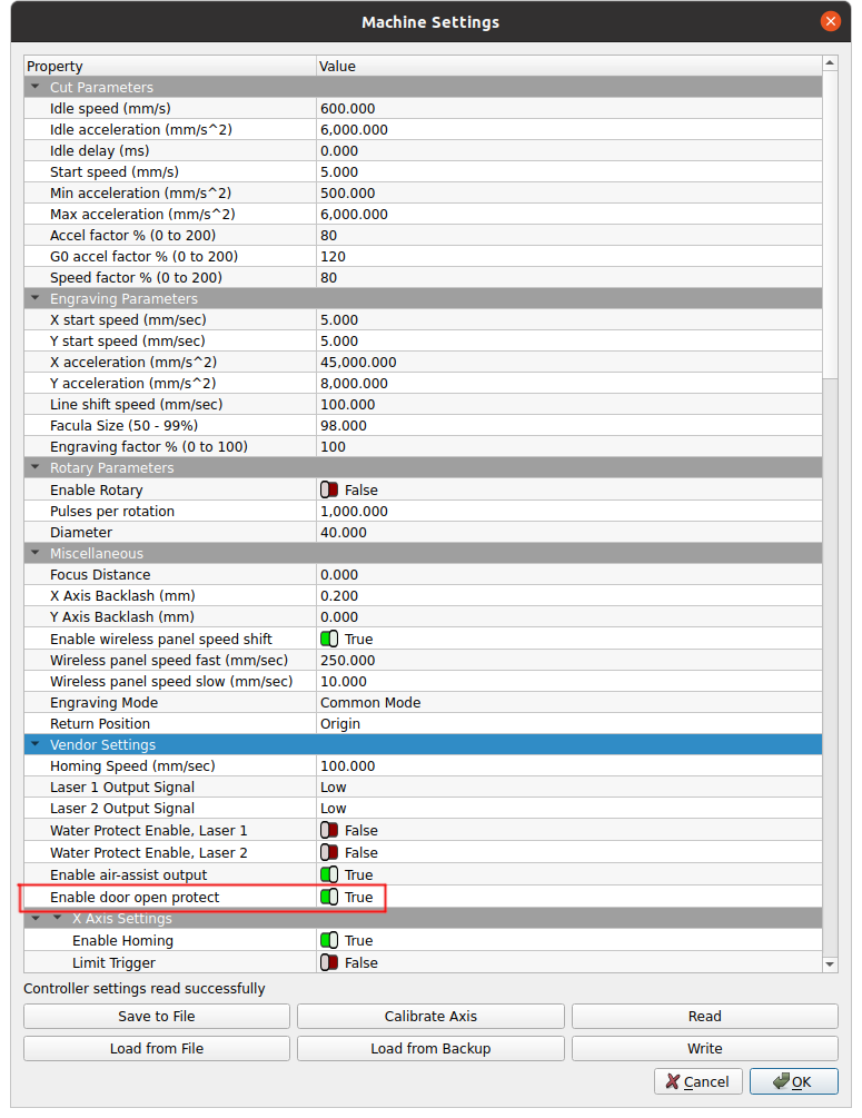

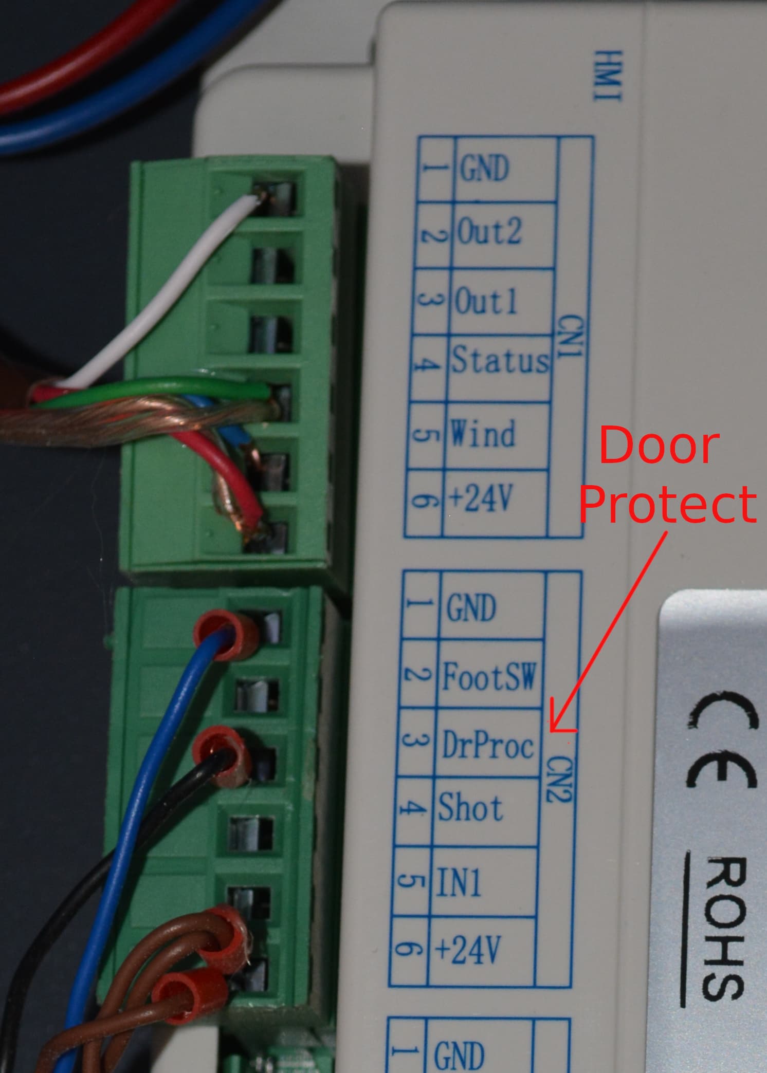

If you wish to use the door protect on your machine, wire it up to the door protection input of the Ruida CN2-3 (DrProc).
It has to be enabled in the Ruida.
The previous photo showed both black wired to ground, now you’ve re-wired it with one of the black wires going to L-On1? The lps shows no connection to wp input?
You might be smart to re-read some of what was posted.

  1. I have wired in the water protect… one wire to WP1 and the other to ground . I have verified this with multimeter and it is working. I have a led that comes on the box in #9 which is WP1
  2. I rewired the door switch… one wire from switch to DrProc on CN2 and the other to ground, once again verified with multimeter again getting a good ground with switch closed.
  3. if I am thinking correctly that leaves 2 wires. One from TH on the lps to Lon1 on ruida. and the other from IN on the lps to Lpwm on ruida
  4. So, with water chiller circulating I have verified a ground at WP1 and with door switch depressed a ground also at DrProc.
  5. with water chiller running, I depress the door switch and then Press the PULSE button I get nothing. if I press the PULS button with that switch released I get the error message… that should be good indication of things working, however no laser beam… power setting at 30% by the way
  6. if I have a file for a rectangle in my computer with settings in the computer so it should engrave , I hold down the lid switch and start the process in lightburn. It will actually go ahead and run with no laser beam… So it seems the only thing not working now is that the laser beam is not triggering.
  7. back when I had it wired like thishttps://forum.lightburnsoftware.com/uploads/default/original/3X/9/5/9529f82a2ae6455024e41a6331f81d266c992b63.jpeg
    I turned the machine on, then depressed the lid switch and the laser fired immediately and stopped as soon as I released the switch so I do know the laser is capable of firing.

The controller normally pulls TL low, so I’d say use the L input, then there’s not issue with changing the controllers output.
This would indicate the controller thinks all is OK, but there is a problem with how you’ve wired the L and IN inputs to the Ruida.
Can you confirm how these are wired?

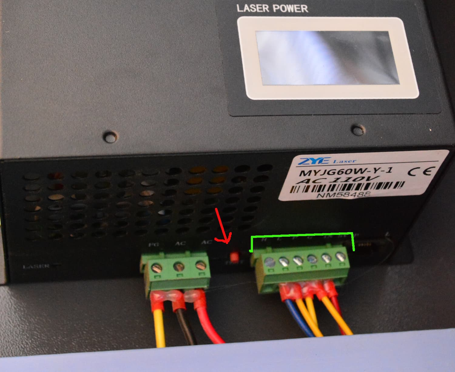

Box on the picture says AC so mains… but as it has a metall housing you use gnd as (yellow/green ) as well
Three wires: the power supply also need a connection to circuit common as the 0 V reference for the two signal connections.

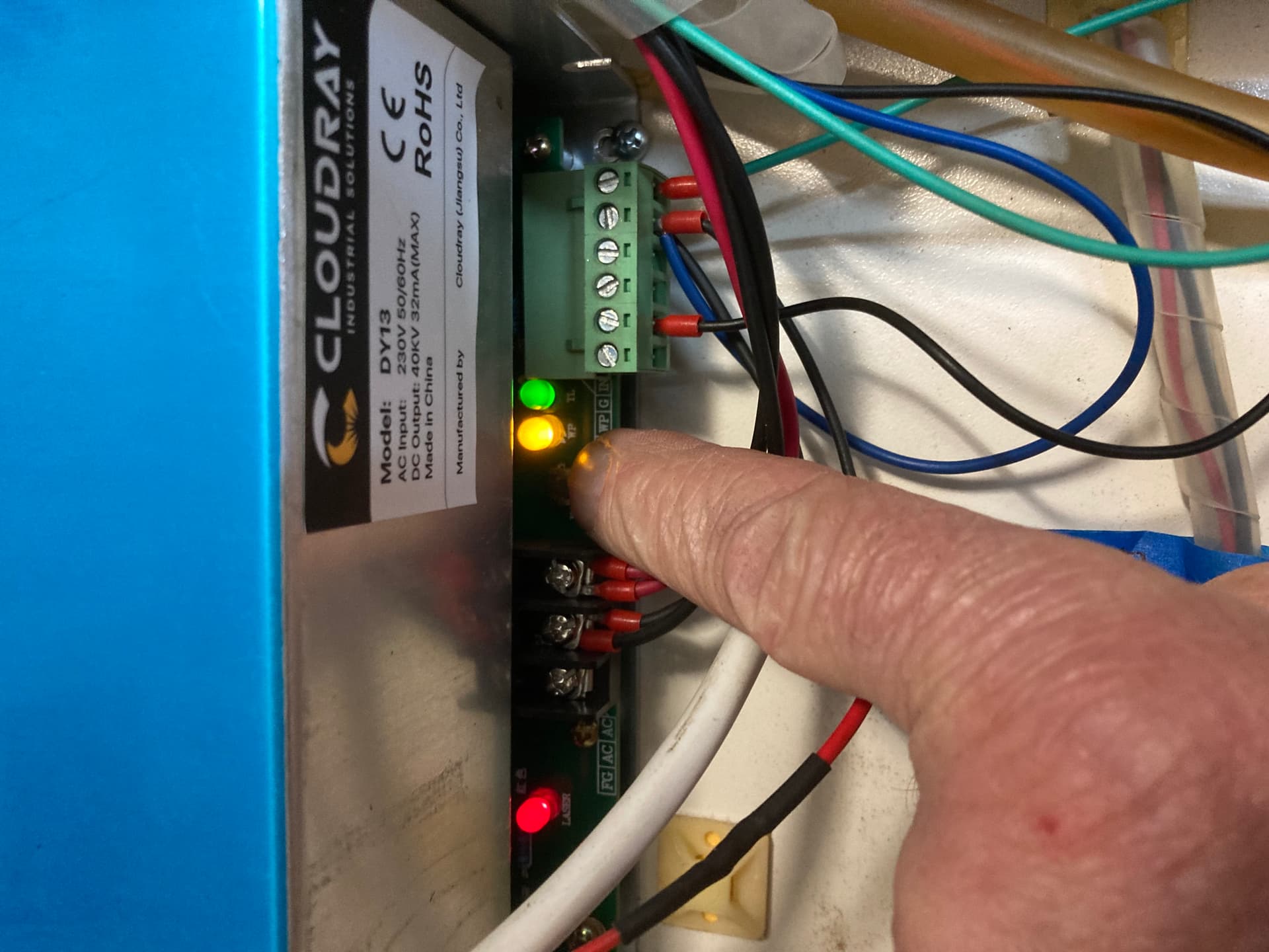

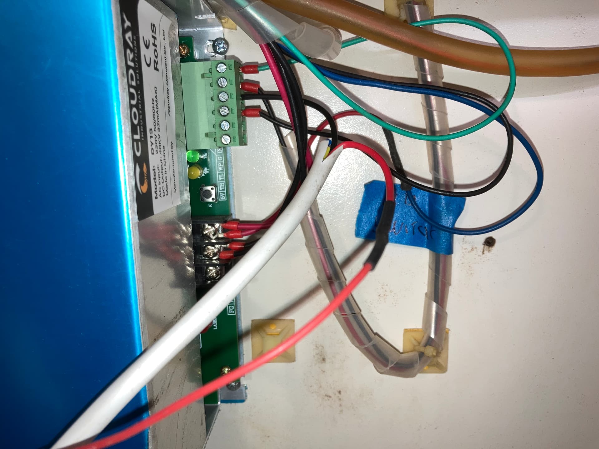

OK, yes good grounds. when I press the test button on the lps with the lid open this is what I get. The laser does not fire though
In your photo, P or WP is not wired to ground. In fact there is no wire to the G terminal in your photo. You must have a common ground between these units.
If the water protect is left open, it won’t lase.
Mine is wired to the G terminal, which activates the lasers water protection circuit. If it’s not grounded, it won’t lase.
In order to test it, you have to pull the right hand connector, green (control signals) off the lps, then the test button will operate.
Note that I use L, P, G and IN, you are missing one or two…
The two exposed screw terminals immediately to the left of your fingertip carry 120 VAC: a layer of electrical tape would be a Good Idea™ before you do more poking around in there.
Source: Been there in other equipment, done that just once, never again. :shaking_face:
You have to poke your skin hard enough to get down to the screws. I’ve reached in there many times and unplugged the signal connector.
Of course, there is voltage there, maybe that’s why I put one hand in my pocket.
Ed, Jack… you guys are great! I would like to focus on the 2 wires I am confused with. On the Ruida I have the following in CN5
1-Gnd wire to motor control stuff
Ground wire to LPS “G” terminal (blue)
2. L on 1. empty now
3. L pwm 1. empty now
4. WP… wire to water protect switch on chiller (ground going to LPS “G” terminal
5. Lan 1. empty now
on the LPS (cloudray DY13)
5w. empty
TH. empty now
TL. empty now
W. empty I used the one on the Ruida
G. 1 to “Gnd” on Ruida (blue)
1 to door switch (black)
1 to water switch on chiller (black)
IN. empty now
I have 2 wire that I can connect from Ruida to LPS
can you tell me which 2 terminals on each unit I should use and what to what?

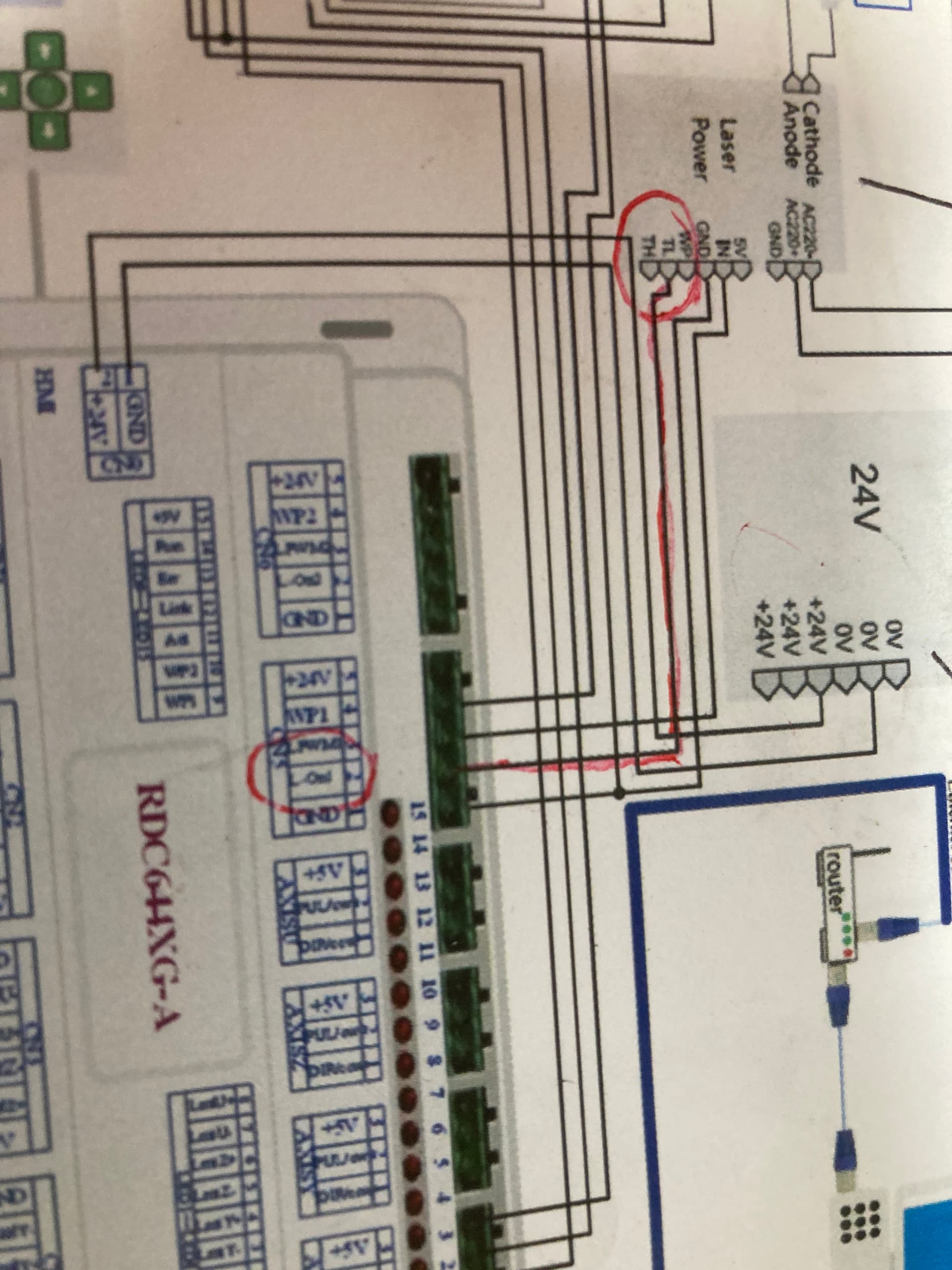

I dont think I have the connections you refer to. here is a photo of the ruida controller wiring diagram from the instruction book and the laser power supply I have.
not sure what you are referring to as the H wire
Am I correct that what you refer to as L is “active low”
