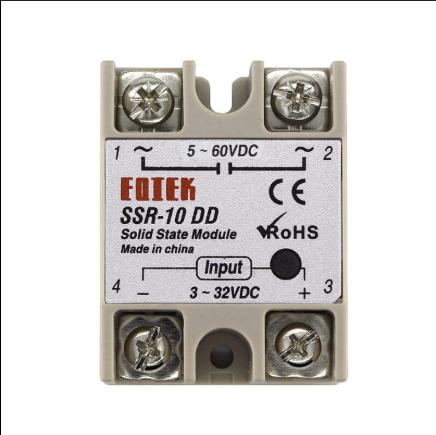

Let me remember. I do not use the foot pedal. I start the machine from the software with mouse. The signal of the foot pedal I use it to tell the machine that the moving of the table is finished then the machine knows that can start marking again. I did it lot of time ago because I adapted a feeding device made with a label cutting machine. So the controller of the cutting machine when finished the feeding process send a signal to laser machine to tell it that can start marking again. And the laser machine when finish marking, send a pulse to the cutting machine to start the feeding process. What you will need are 2 SSR (Solid State Relay) Because the laser machine controller works with 5V, and DDCS V3.1 works with 24V. I will send you a picture of them I think I have in my drive.

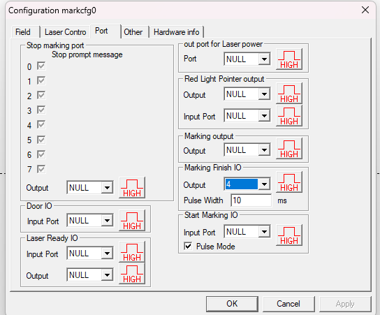

I don’t have exact same card as yours, mine is for only one axis. But as far as I could see in the user manual, the foot pedal is connected to a pin called remark, and you have to use one of the general output, and configure it via F3 → Port → Asing the Pin Port Used to the signal Marking Finish, this will tell your external controller that is time to move the axis.
Mine has one axis extension like yours.
Footswitch on mine is connected to GIN15 pin #9
I’ll do some digging around to see how to configure one of the outputs, Pin 2 or 10 which ever is not already in use. Looks like your config above it is pin 2 (Output 4)
Question, do you remember how you connected the marking finish to the CNC board? did you run that through a relay as well or direct?

I used SS relays, because the working voltage of Laser board is 5V, and the working voltage of CNC controller is 24V, so I used Fotek SSR-10DD, this way no problem for the different voltage in the boards

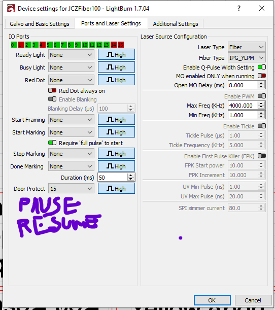

Working on an automation project, may add light to this thread. I could use Pause and Resume ports. Put it in the feature request, maybe get some votes.

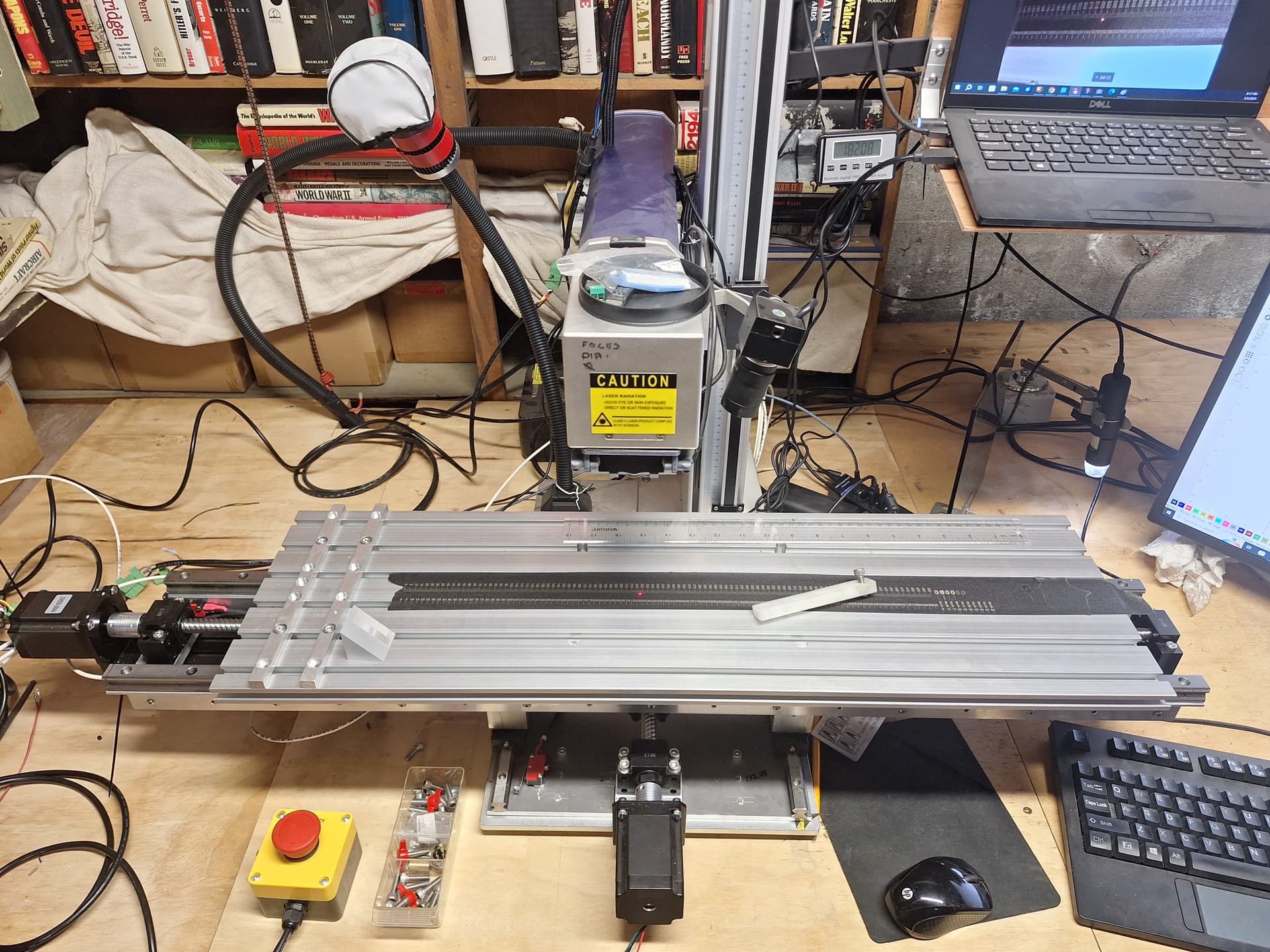

Got the XY table mounted, getting late last night but ran some calibration tests after making sure the Z drive didn’t slam the lens into the table at 2000 mm/min when running focusing macros. Any project like this need the big red button at the ready. Built a 3 axis controller only using it for Y and Z for first tests, running X off the rotary port on the laser.

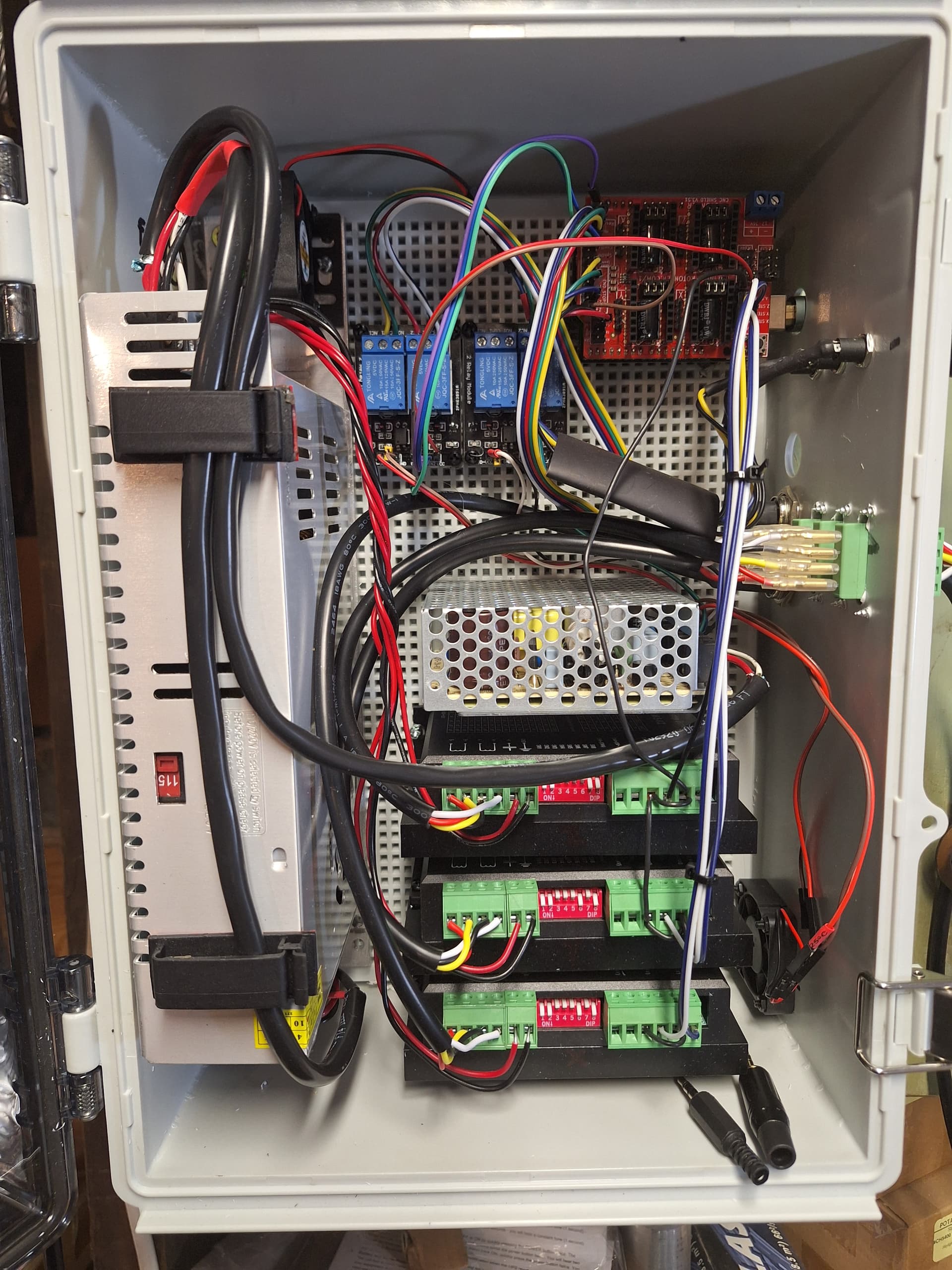

The controller. Arduino Uno based w/ 48V PS for the Microstep drivers, 5/12 V PS for relays and fans, etc. 4 Opto-coupled JVCC type relays so coil power is completely isolated from the board and rest of system. Relay 1 and 2 are wired to a 5 pin aviation plug and driven by the A4 and A5 pins on the UNO (M7, M8, M9 G-Code calls) I’ll connect these to IO 14 and 15 on the BJJCZ board near future. Second 5 pin connected to the board’s Pause and Resume pins, however the BJJCZ board is not compatible so now just for future, as are relay 3 and 4.
First test 2 min video, running repeat marking / dynamic text. Dead on over 450 mm:
