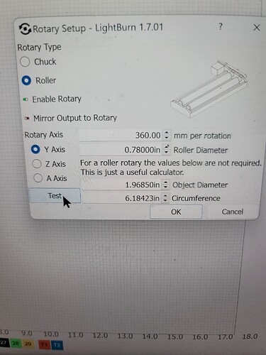

I’m having problems setting up my Algo Rotary Roller RR2 in the updated version of Light Burn
What kind of problems? Please provide more information.
Mike in went TOOLS, Rotary Setup, Enable Rotary, click on Roller, put in my roller diameter 0.78000 in, Click test rollers went through rotation, Escape Out
Click on Edit, went to device Settings, disable Auto Home and Fast Whitespace. Escape out of program. Went to import a design set the laser over the cup and tried to print, no luck. Frustrating
When you do that you don’t save anything you just did. You need to click the OK button to make any changes.

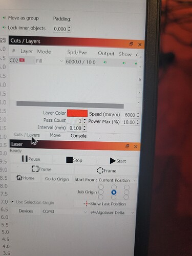

A screenshot of your entire lightburn screen with the layers panel and the laser panel open would be helpful.

Please see photos
In settings, on the display tab, select “Show rotary enable on main window”.
I’d like to see 2 more things for now, your entire LightBurn screen with your project file loaded, your laser panel open and Cuts/Layers panel open and also a pic of your laser with the rotary in place.
I believe we’re looking at an issue with your origin settings and I should be able to confirm and advise after seeing those pics.

Nice documentation, but you did not tell us what it was not doing. May I infer from that last image that is the “having problems” part?
The rotary has no Nome position. That is why you have to turn off automatic homing. Now when you power up, that becomes the 0,0 Origin, unless you set it someplace else.
So now we have the trolley (laser) and rotary set so they can only go one direction, positive. If you powered up with the laser far left, you are good to go there. Unfortunately, the rotary has no front or back. Before starting a job, I rotate the chuck 3-4 rotations, 8-10 if using rollers, and now I am in about the middle of the Yaxis travel.
I Jog over to the part in Xaxis and move the gantry over the part. Now I am right in the middle of the part. From there, you should be able to use Current Position, and select the center dot as the Job Origin.
Go through this slowly and there is a good chance you will be making parts.
