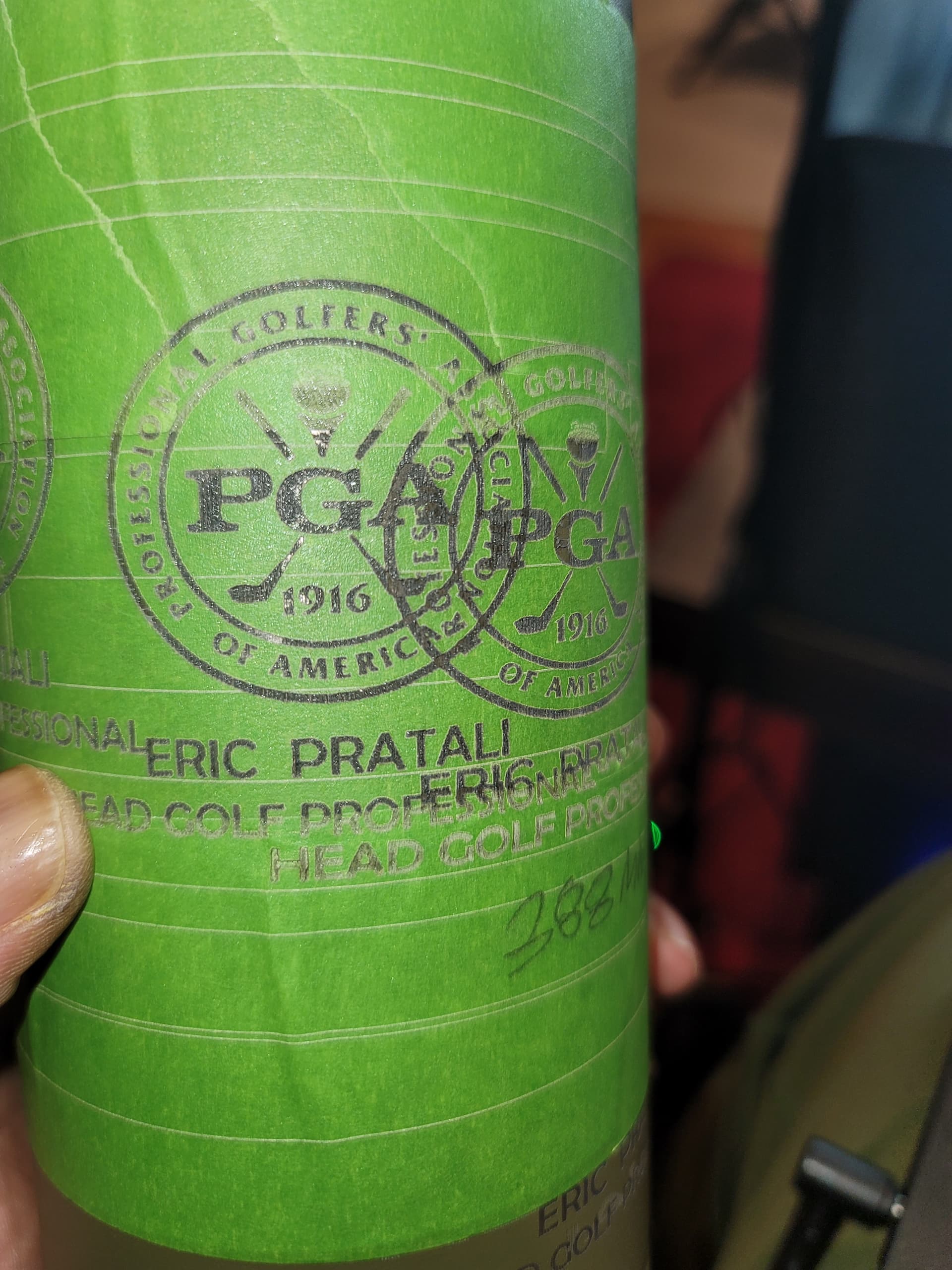

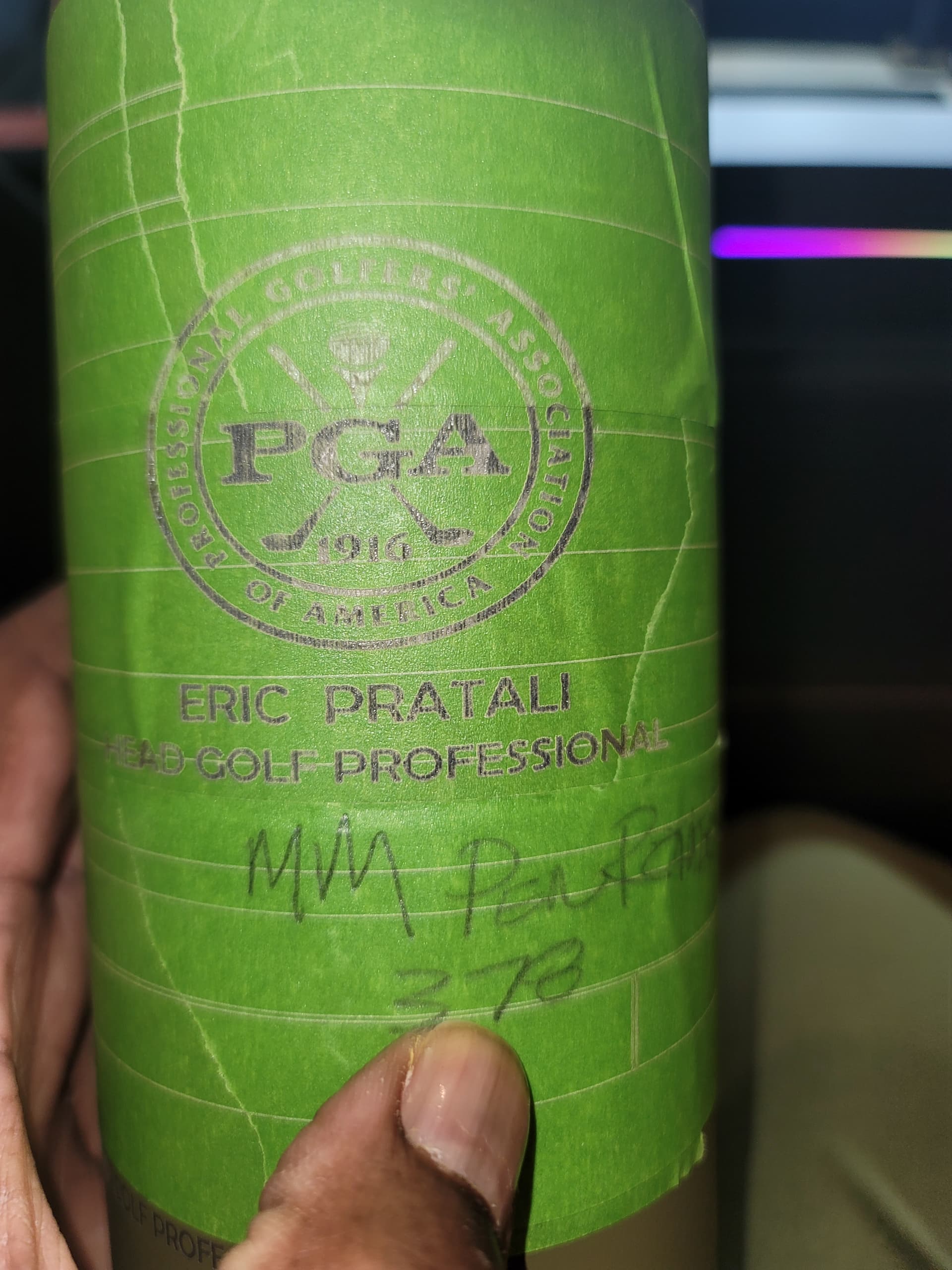

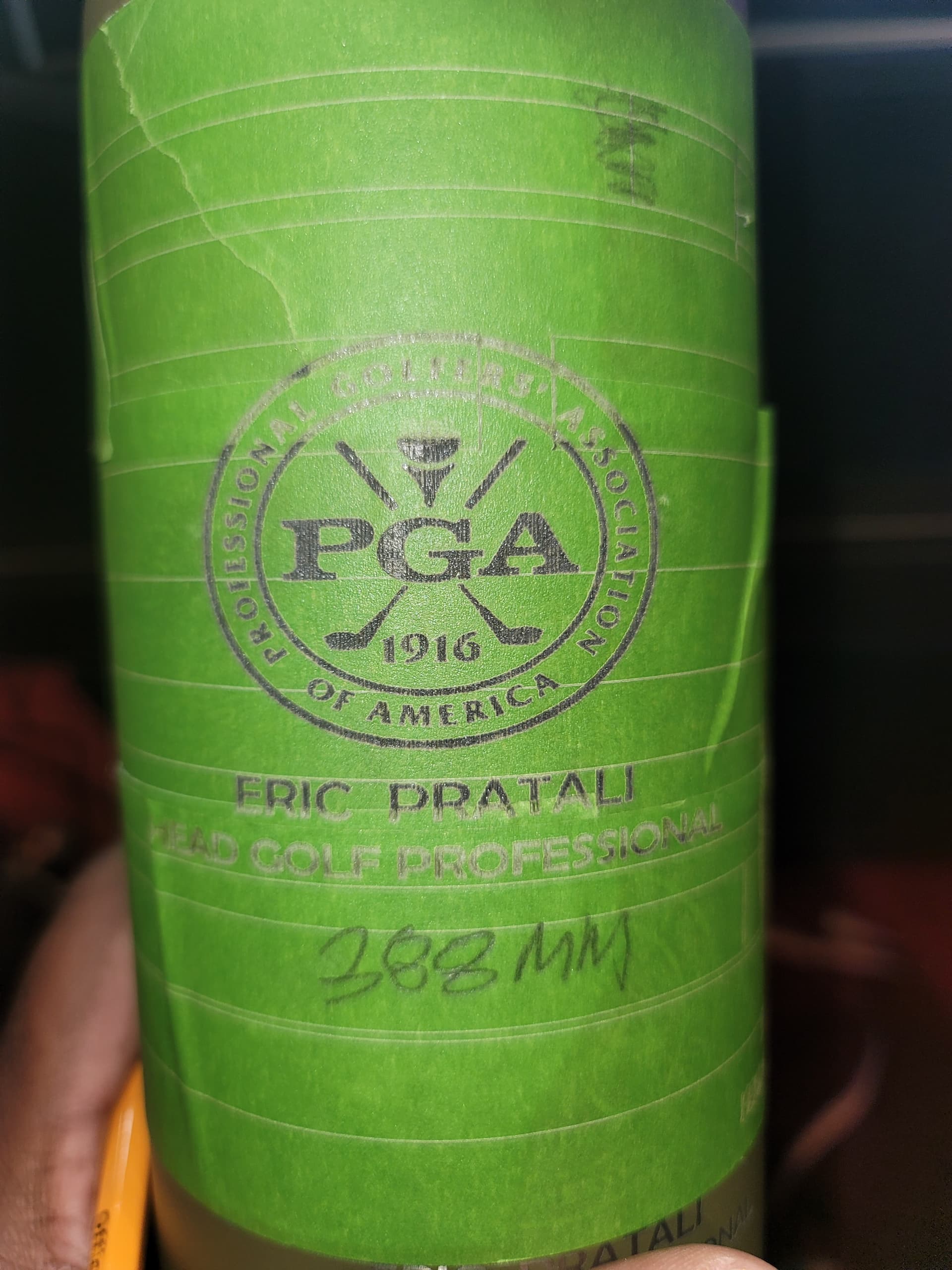

Tim, is it possible to get fairly round circles in the design. Computer shows one thing and the output is different, more of a onlong circle. The 1st pic is 378 Rotation, the second pic is 388 which seems slightly wider. I going to try a dial back from the 378
Its changing some, ive had to go down to 338 mm per rotation to get a somewhat circle, is this a normal thing until its dialed in
It’s an optical illusion. Because of the round shape of the cup it appears squished. If you measure it you will see it’s the correct dimension. Add about 10% to the width of the design and it will look better. Don’t change the rotary settings, adjust the image.
