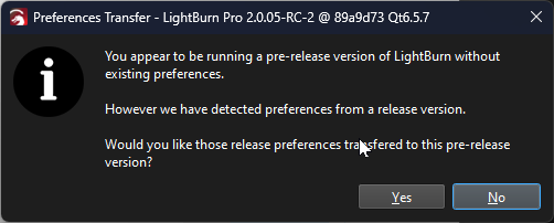

Another option is to download and install the latest Release Candidate 2.0.05-RC-2, which should also help with the “can’t minimize” layout issues.
It will install to a separate folder (C:\Program Files\LightBurn_PreRelease) , when you see this message box choose ‘No’ to start with fresh settings, and have a go at setting up your device again from scratch, and let us know how you get on.
