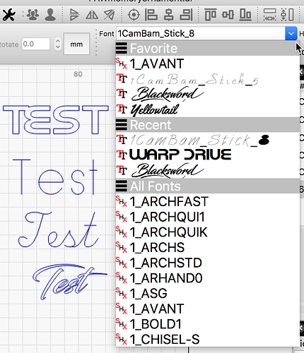

What is the name of this font you are showing? Show us the settings for the SHX fonts you have in the Device Settings along with showing us the drop-down font list.
It looks like you also have ‘Filled’ rendering set for the visual display. LightBurn is intended to work in wireframe mode, so it is a bit difficult to see what you are displaying. Please show the same but include the entire LightBurn screen this time. Some of what I want to see is missing in your shot.

Sorry, please make LightBurn full-screen first, and capture with the font list pulled down like I show.
You missed some of what I asked. Helpful to know these things.

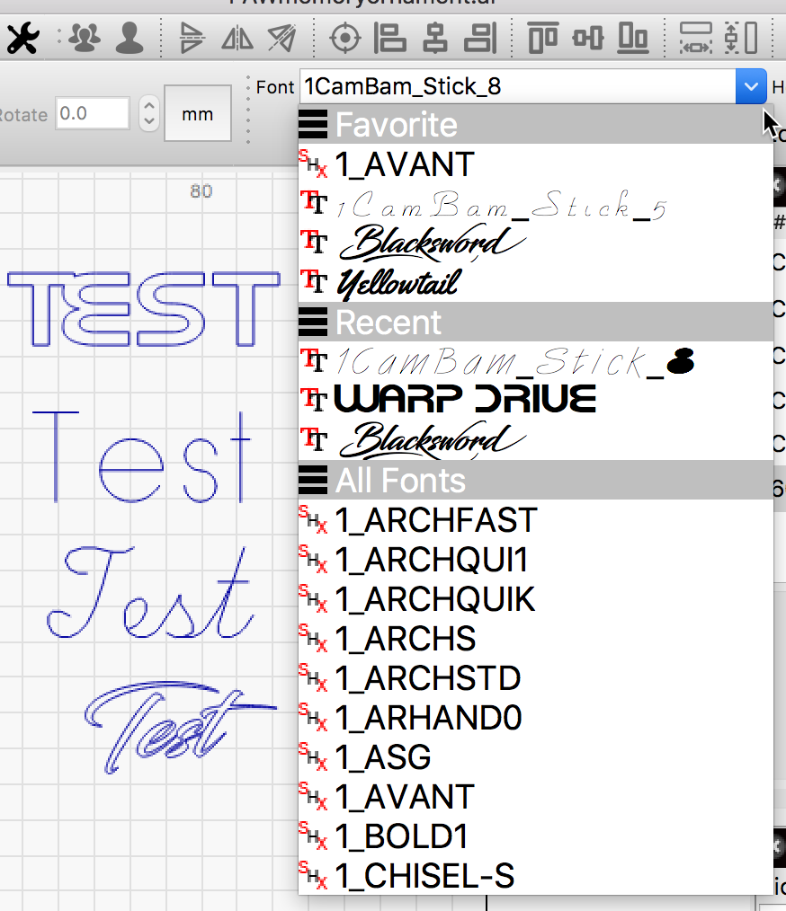

Rick, there are many fonts and the pull down menu does not show all of the, here are some

Glad to hear you are sorted. BTW, you can select the ones you like and only load those. Just place a copy of the ones you like into a new directory, then update the location in LightBurn. You can also ‘Add to Favorites’ with a right-click.

I know this is an old thread but I’ll try to revive it. In the picture the font dropdown shows a “Favorites” category. Is this available in 2.0.02? I don’t see it in the font setup block.
Even better would be a filter to show only my SHX files. Is there a way to filter the font types.
