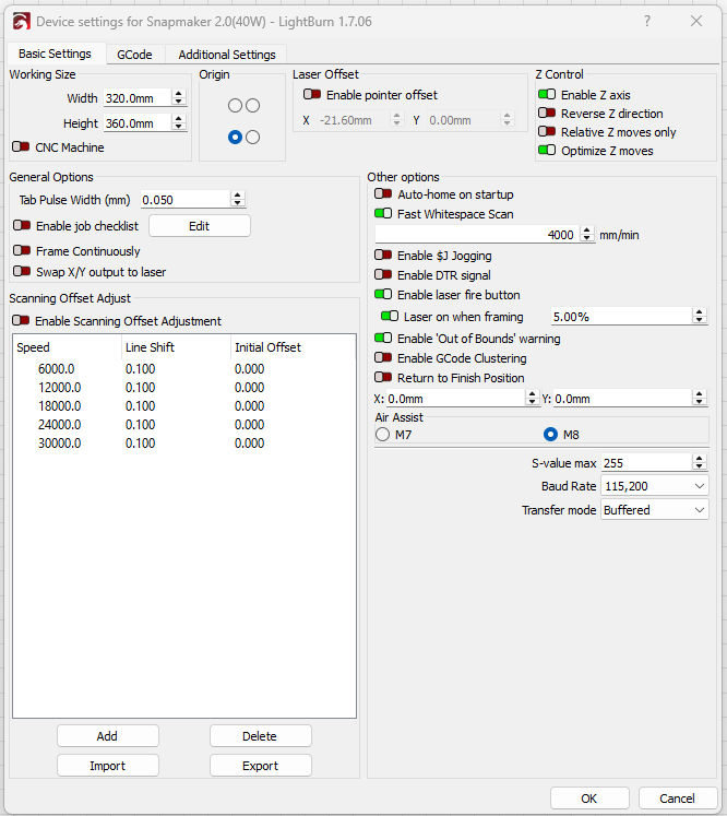

Still no luck in getting the air assist to turn on/off when actually running a materials test. I can turn it on and off in the console with M8/M9, But even if I just export he gcode from the mat test there is still no M8 command in the code. I just have to turn the air assist on first, then set up the material test and run it (text and all), then turn air assist off at the console screen.

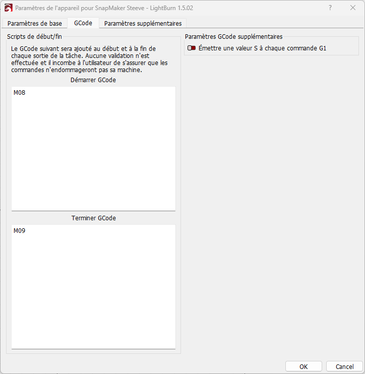

Bonjour,
Essayer cela…
Bonne journée
Running LB 1.7.06 here, with the 40W blue.
Looks like I have the same issue, while I have M8 selected in device settings, and air assist turned on for the layer, I’m not seeing “M8” or “M08” in the output file. Manually adding M08 in the start gcode does turn on the air, and M09 turns the air off.
Why would lightburn not output the air on and off commands after I’ve explicitly told it to do so in two different places?
Are you using the correct machine profile in Lightburn?
Using Ray/Artisan/2.0 with LightBurn | Snapmaker Wiki
You have to use either Marlin or GRBL, the “Snapmaker” profile does not output M8/M9, even though the options are there in the settings. If you’re lucky, maybe we can poke… say… @Colin to pass this info along? :slight_smile: Or you can email support@lightburn.com or a request here: https://lightburn.fider.io Though being more machine specific, I don’t think the feature request is quite appropriate.
Basically the fix is for Lightburn to enable M8/M9 output. Kinda like originally it couldn’t do inline. Things evolve :slight_smile:

The first step was to not use the snapmaker profile. My understanding is that they turned off the ability to enable air assist, but didn’t grey out the options, so you turn it on in the layer and in the device settings, but it still doesn’t happen.
So: Go to laser tools, Manage devices, and use the plain GRBL profile. I named mine SM350-40W You may need one for each laser head to handle the different X/Y offsets from the focus point to the actual laser position. I’m not 100% on that yet.
Once you’ve done this, use this profile and your air assist will work, HOWEVER you’ll find parts of the burn missing. It will go through the motions with the laser off.
Now in the Laser Settings, Device Settings, Gcode tab, turn on (upper right) “Emit S value with every G1 Command” No idea how we’re supposed to know that, but once this is done, happy burning!
