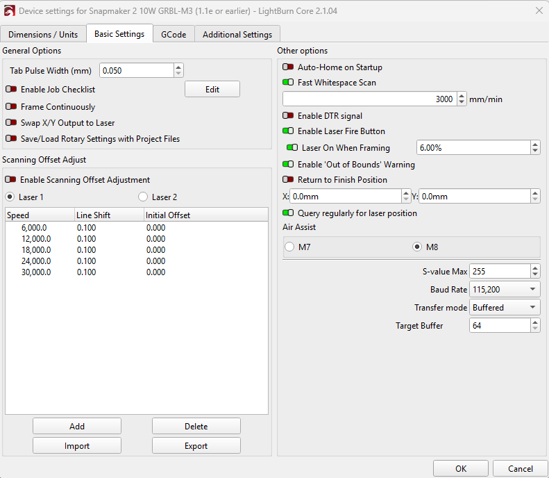

Snapmaker 2 A350, Lightburn Core 2.1.03, Device Settings, Target Buffer Setting
For the Snapmaker 2 A350, Lightburn Core 2.1.03, Device Settings, GRBL-M3(1.1e or earlier) profile, the Target Buffer Setting is set to 64. Can or should this be changed for better performance?
P.S. Running via USB cable

Yes, better performance, It never seems to run at the speed specified in cuts/layers.
Thought maybe the buffer size adjustment might be an issue.
I have no idea what the controller buffer is capable of handling via USB.
This is because every direction change requires some degree of stopping and restarting, or at least slowing down and speeding up. It is not physically possible for the laser module to travel at the programed speed continously.
The correct statement is that it is unknown how fast the controller can empty the buffer. What is well known is that the controller can accept data and process it at a much higher rate than the motors can move the module around.
Of course, I do not have your machine, so it may not be behaving like what I have experienced. Your controller might be 8-bit instead of 32-bit like many machines are now. Double the Target Buffer size and see if it improves your situation. If not, change it back.
To see if you might have a controller parameter out of whack, clear the Console window (right click), enter $$ and then copy and paste the entire result in a Reply.

This is all very good information, thank you.
But it doesn’t answer the basic question if the default Target Buffer setting of 64 for this profile is correct or not.
Basically all the information ends in; it doesn’t matter what that setting is. The controller in the Snapmaker is controlling the buffer itself and being a limiting factor. You can use any number in the target buffer.
Actually it does. The controller software is pulling information from that buffer. It expects that buffer to be a specific capacity. You can feed more data into the buffer in bigger chunks, but performance can possibly to suffer.
My question is why have you not changed it to see what happens. Are you expecting the machine to speed up? Is the machine stuttering (stop-starting) during a data transfer, which would indicate it is starved for data? You will not break anything by changing that number, so go for it. Adjust until you are satisfied.
