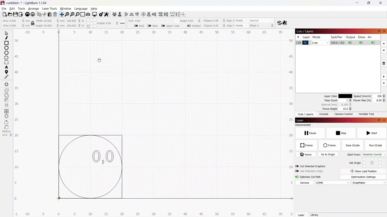

I’ve got a laptop, it has a touchpad, I can’t use Pan if activated by pressing and holding spacebar (mouse movements or click+drags do nothing.
If I choose pan from the toolbar it works as expected.
It feels like windows has taken over the key binding and is repeatedly pressing spacebar instead of sending the keydown/up event once.
Somewhat counterintuitively spacebar alone won’t cause panning. Spacebar essentially enables panning but needs to be accompanied by a click-drag to actualize the pan.
You can confirm this if the pointer icon switches to the hand when spacebar is pressed.
There-in lies the problem, when you release spacebar, the mouse-selection mode is activated and Pan de-activated. If I maintain the spacebar held down then mouse movements and click+drag combos do nothing
Nice video. This is the sequence that works for me. I also have a Lenovo with toudhpad and W11. Not sure what might be at play.
Are you running and background apps that could be modifying your keystrokes? Perhaps a key modifier or even a password manager type application?
Can you confirm that middle wheel/mouse wheel click-drag with an external mouse works as expected?

Plugged in external mouse, works fine. Touchpad doesnt work. I tried clicking with the mouse and moving the cursor using the touchpad which works. Using the mouse movement with touchpad clicking does not work.
Interesting. When you use the touchpad are you physically pushing down on the touchpad to the point where it clicks or are you using single tap click? I have to physically click for this to work.

Yeah sorry thats what i was trying to say, it works if i click drag with the mouse, and it works if i click with the mouse and move with the touchpad, so its the touchpads click that is the problem.
