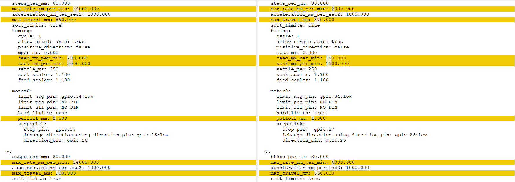

Speed limit for Lightburn? Trying to run @ 24,000mm/m - 400mm/s
I have my laser config file setup for 24,000mm/m but I don’t believe that ““while performing a job”” it ever reaches those speeds, only when framing does it move this fast.
  1. When homing its slow 2000mm/m as can be seen in the config so I understand that
  2. When running a job it does not reach 24,000mm/m as configured (above img)
  3. I know this because when I do framing option it actually moves much faster
How can I begin to troubleshoot this issue? I have large print area close to 1m x 1m so I need to be able to move quickly through the print. I have already resolved quality issues so really just need the software to work with my goal now. Maybe I forgot to change something else?

It appears something was wrong with my config file. I ended up flashing my controller with a new firmware to assist with wifi issues and it appears to have inadvertently resolved this issue.
My Lightburn → Edit → “Machine Settings” page does not have any values in it. Fluidnc seems to keep all those in the config.yaml
You controller may handle that a bit differently than most others… but somewhere there are limits to the machine… specifically to keep a user from running some code and damaging the machine.
Somewhere in your configuration is the maximum speed and acceleration values for your machine… These controllers are relatively generic as they will drive most any machine, so they have similar settings.
Unless you change the limits, you can’t exceed them.

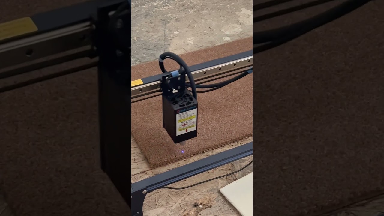

This seems to be unrelated to Lightburn but I cannot figure out for sure what is going on here. For some reason my laser frames baddly when acceleration is below 2500mm/s2. This seems insanely high!! Anything you think I can try to resolve this? Please see videos below.
Rubber band frame w/ acceleration at 500mm/s2 (notice how there is no laser showing, belts shake)

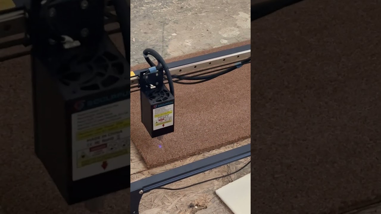

Rubber band frame w/ acceleration at 1000mm/s2 (notice how laser is flashing rapidly, belts shake)

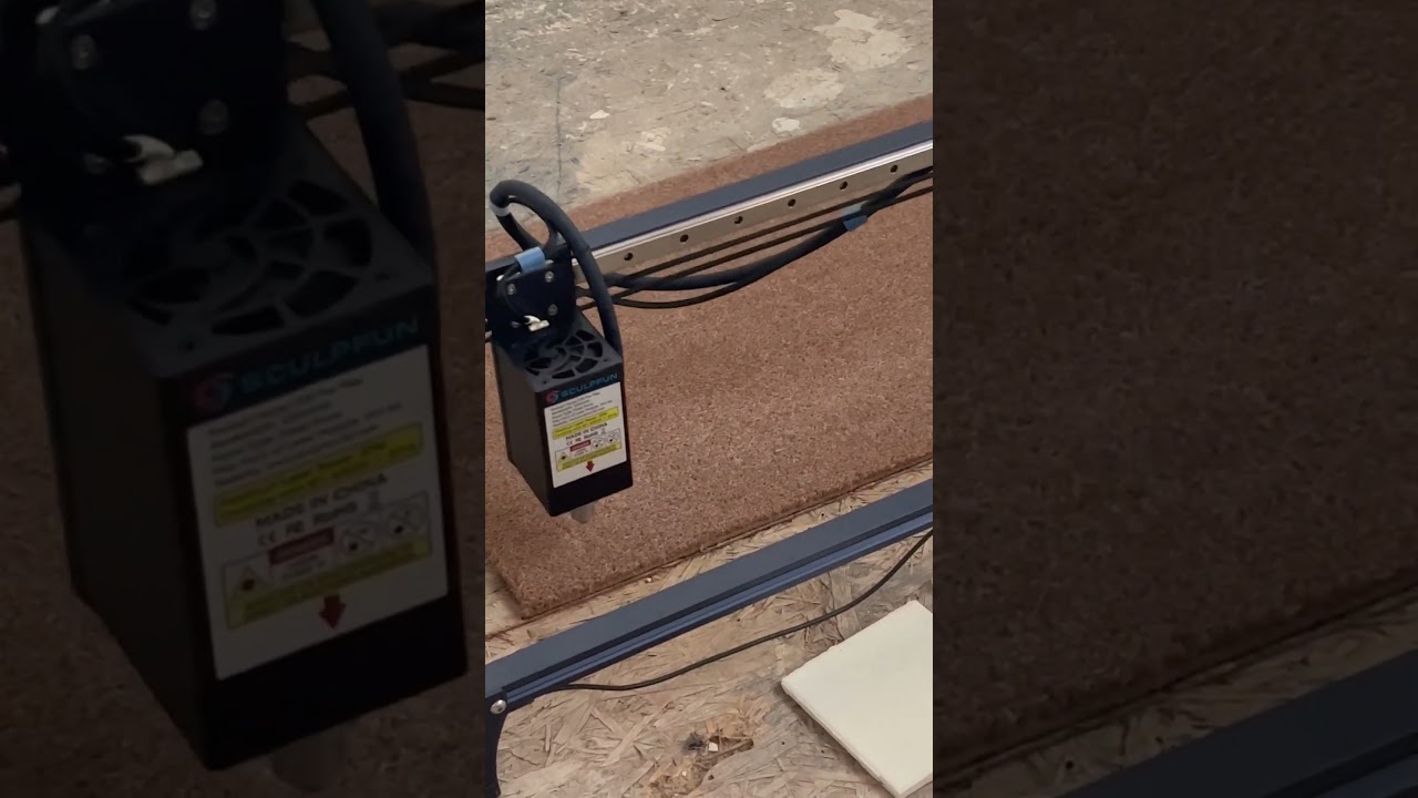

Rubber band frame w/ acceleration at 1500mm/s2 (notice how laser is flashing LESS than before, belts shake)

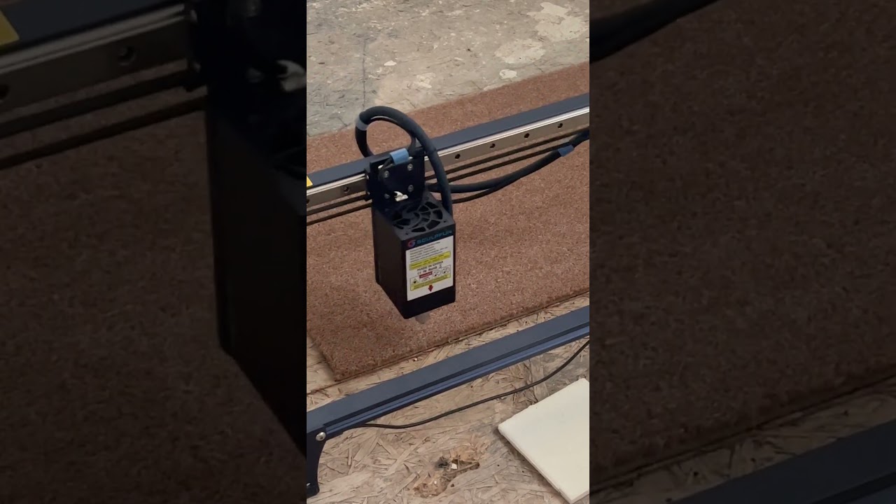

Rubber band frame w/ acceleration at 2000mm/s2 (notice how laser is almost smooth)

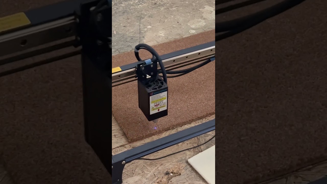

Rubber band frame w/ acceleration at 2500mm/s2 (notice how laser seems the best?)

The rubber-band frame is made up of straight-line segments joined at obtuse angles. The GRBL path planner must manage the speed to keep the position error within the specified tolerance, so it must accelerate and decelerate at each corner.
Higher acceleration allows faster speed changes and looks smoother on patterns with smaller line segments. Lower acceleration lets you watch the machinery gain momentum, which is rarely productive.
