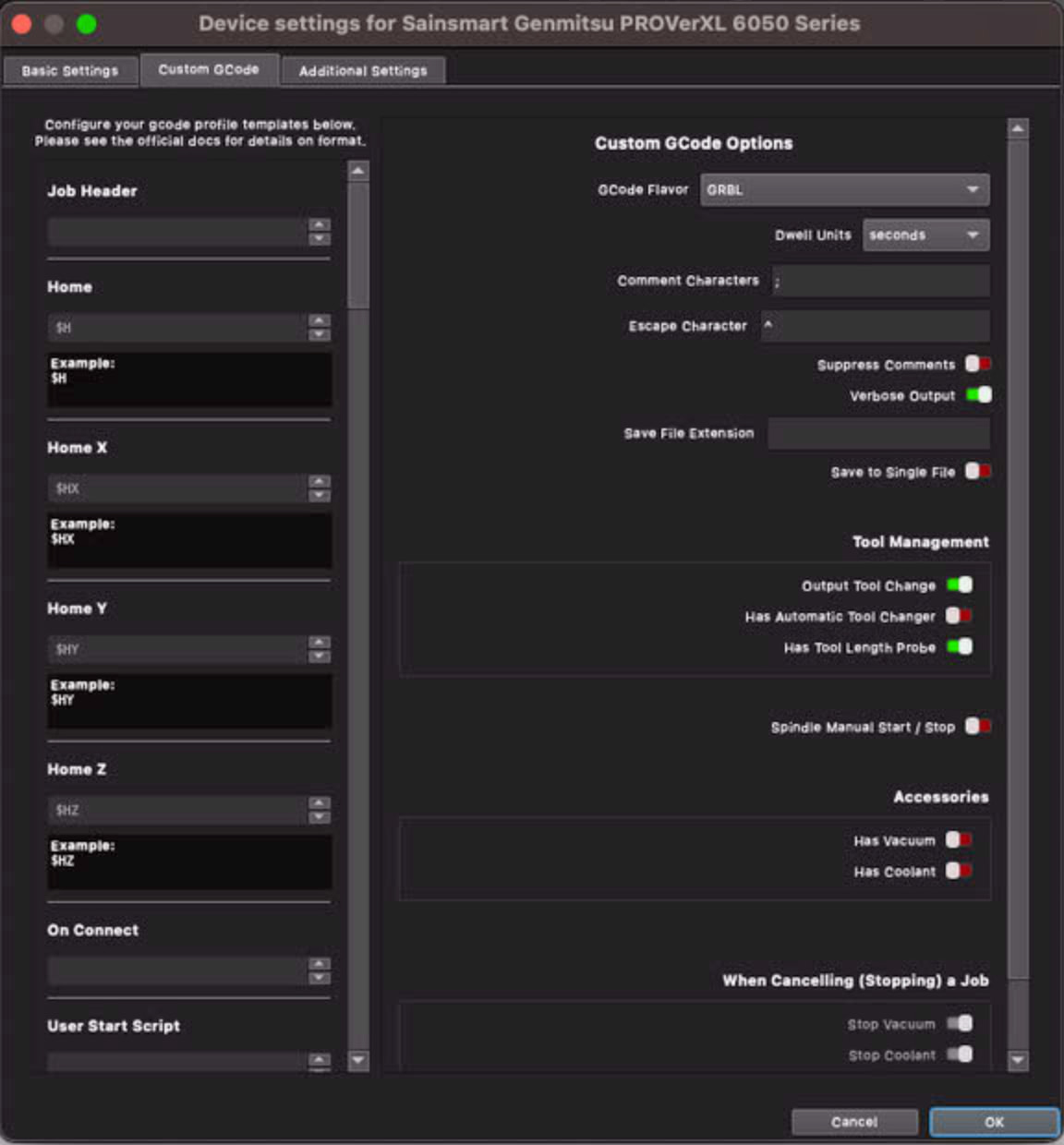

Doesn’t sound like a comms issue. Under advanced for the machine settings, do you have 'Spindle Manual Start / Stop set?
image (When you check the gcode do you see for example, m3s18000 near the start of the op? (You can just search for M3))
can you post the generated gcode here?
Hi @fourpaw
I uploaded the entire file. At line 22, is the M3 S30000 line. I also uploaded a screen shot showing the option to manually need to start the spindle NOT on.

You’re right, it’s definitely telling the controller to start the spindle. Would be interested to know if that gcode turns the spindle on in gsender. It’s possible its mapped to the wrong output, but if m3s10000 [for example] works when you type it in console on millmage or gsender, it’s not that either.
If you are sure the spindle turns on manually and with gsender, its not a wiring or comms issue. (no vfd either to worry about)
Unfortunately I think you need to wait for support to chime in, because the only things I can think of are (and neither should really stop it working, as M3S30000 should apply the max allowed pwm) are:

Yes, I agree and understand how anyone can only know what I describe. Let me try to clarify. The CNC has a box with a rotating knob that controls the speed of the spindle. That knob does not control the spindle activation. The activation of the spindle is via software in both gSender and in MillMage confirmed by the fact that gSender works for the gCode created by MM and that in MM, I can control the spindle by the manual spindle control. The fact that I said the speed isn’t controlled by MM wasn’t meant to say the on/off of the spindle also wasn’t controlled by software.
So I went through the first few lines of gCode and saw this below, in bold. This appears controlled by the Device Settings option “Output Tool Change”. This didn’t affect gSender when running the same gCode. I “suppose, not confirmed” that gSender skips lines it doesn’t understand?
if I’m supposed to, I never see a popup or any indication to change bits and continue. Also the behavoir with that line the spindle doesn’t turn on AND the z axiz will drive the non-spinning bit into the material.

M5
; T{tool}.
@T ← This seems to be the culprit. I removed this line and the tool comes on

Posting about Tool changes:
If you want tool change halts between operations, you will need to modify the Custom GCode for Tool Change. You cannot just turn it on and it will work. Otherwise, you must turn the Operation steps on and off one-by-one to enable a tool change. I like the no-hassle part of it moving to my desired location and returning when I say ok.
Here is my setup for manual tool changes. If you want to use a touch probe, you will need to set that up as well.
My retract is to Zzero, not the Zhome position which would be higher up.
Yes, the spindle turns on.
