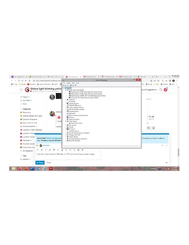

b) now that you did, when you plug machine and go to device manager, ports section do you see your new com device?

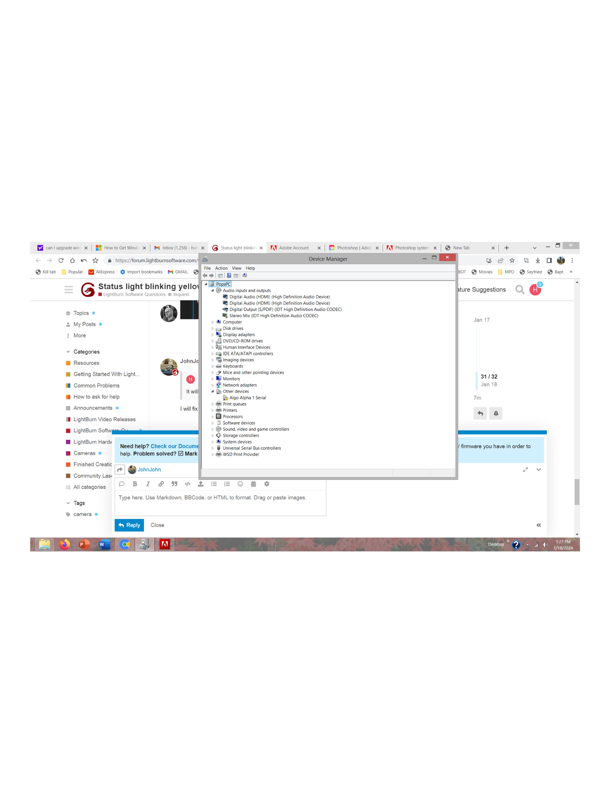

Going to device manager I see the same thing I have always seen: "ALGOALPHA 1 SERIAL I was not trying to give you a hard time it was more of a joke.
My view is: My computer sees the com port for my laser with no problem and always has. My lightburn software can not find Algos serial port.
I can possibly upgrade to win 11, what do you think??
plase take a screenshot of your device manager
There should be zero reasons why you would have to go through the pain of going to windows 11 (not a fan of win11 at all here!)
But i need a visual cue to know if what you are saying is what i think it is or different
just pop up device manager
Expand ports section, and take a screenshot that shows everything including the algo alpha 1 serial you describe

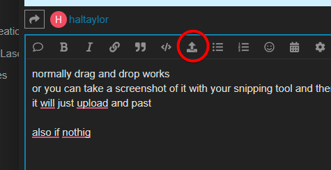

How do i add an image in this forum?
normally drag and drop works
or you can take a screenshot of it with your snipping tool and then Ctrv-V here
it will be just uploaded
OR the upload button

ok so Definitly the computer is seeing it
But the drivers are not installed, therefore your windows 7 cannot give it a com port
If you do follow the steps in the PDF i sent earlier it should fix the problem right away
If you were to follow the PDF i sent you it should be able to fix it

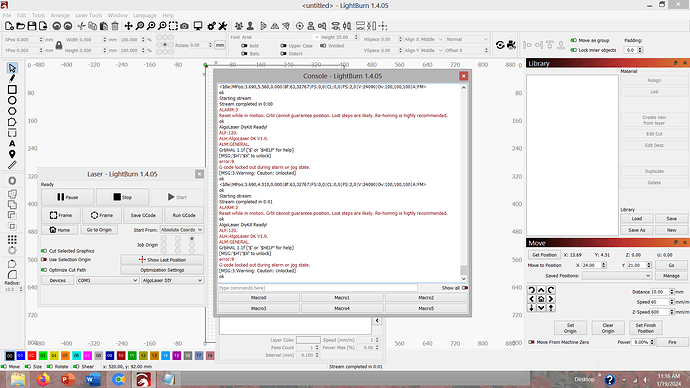

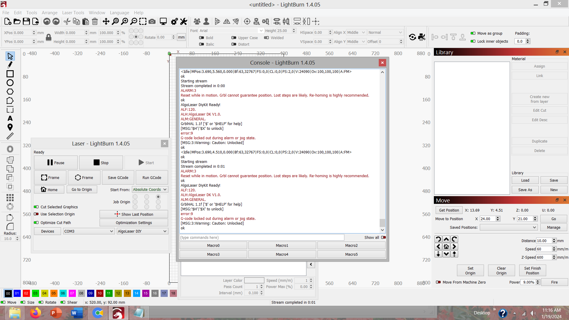

Alarm 3s are mostly based on loss of communication and or power issue
Reach for the laser head and unplug the top cable and run the job again
Will it still alarm 3?

WHat might happen is when the machine turns off, and you dont close lightburn it defaults to COM1 port
Then you might have to go back and reselect COM3
The restart process is always the same
PWOER on → let it home
Plug usb . hear the pc SHIME
Then launch lightburn and confirm COM3
