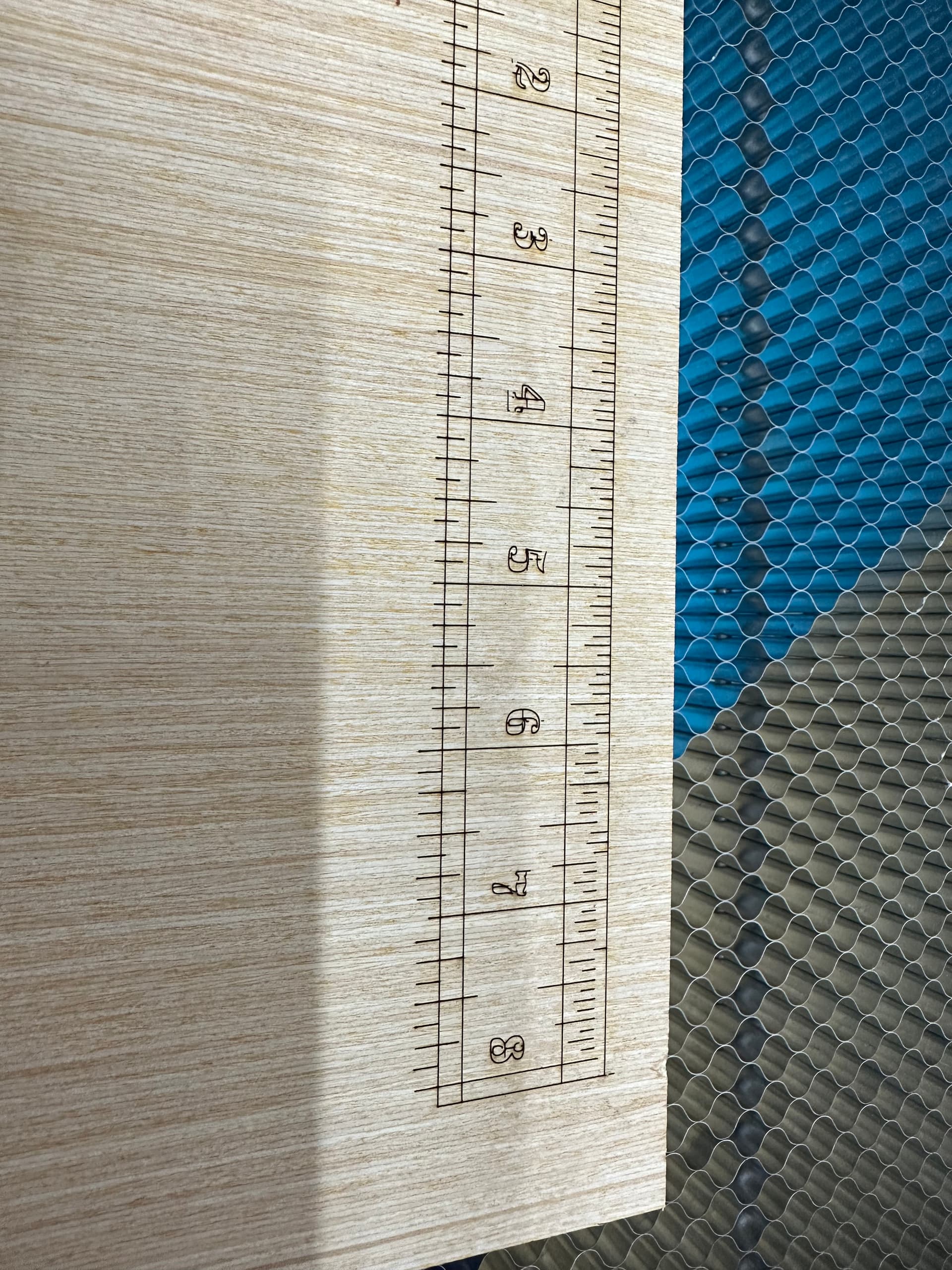

Sorry to bug you Gil, but now I repeatedly get “image might be out of bounds” If I click cut anyway the laser head moves a little then sits with no LED on.
This means probably you changed the Start from to Current position
And console must be giing you an ALARm 2?
Try absolute coordenates again please
Cool! Could I borrow your brain for a week?? I promise to put it back when I am finished!
Hey Gil, I have an alignment, and a ‘falling out of alignment’ issue now.
The mis-alignment appears to be only in the “Y” axis Also, If I home the laser, prior to starting a new burn, the first thing the laser head does is “stutter” a bit causing an initial “y” error. If I move it a little off of zero, ‘Y’ it seems to be OK. BUT looking at the ruler burn it is obviously falling out of registration in the ‘Y’ after starting!
I think we will need to adress the issues with your homing
For that we need to share video. Best to contact via support@algolaser.com
