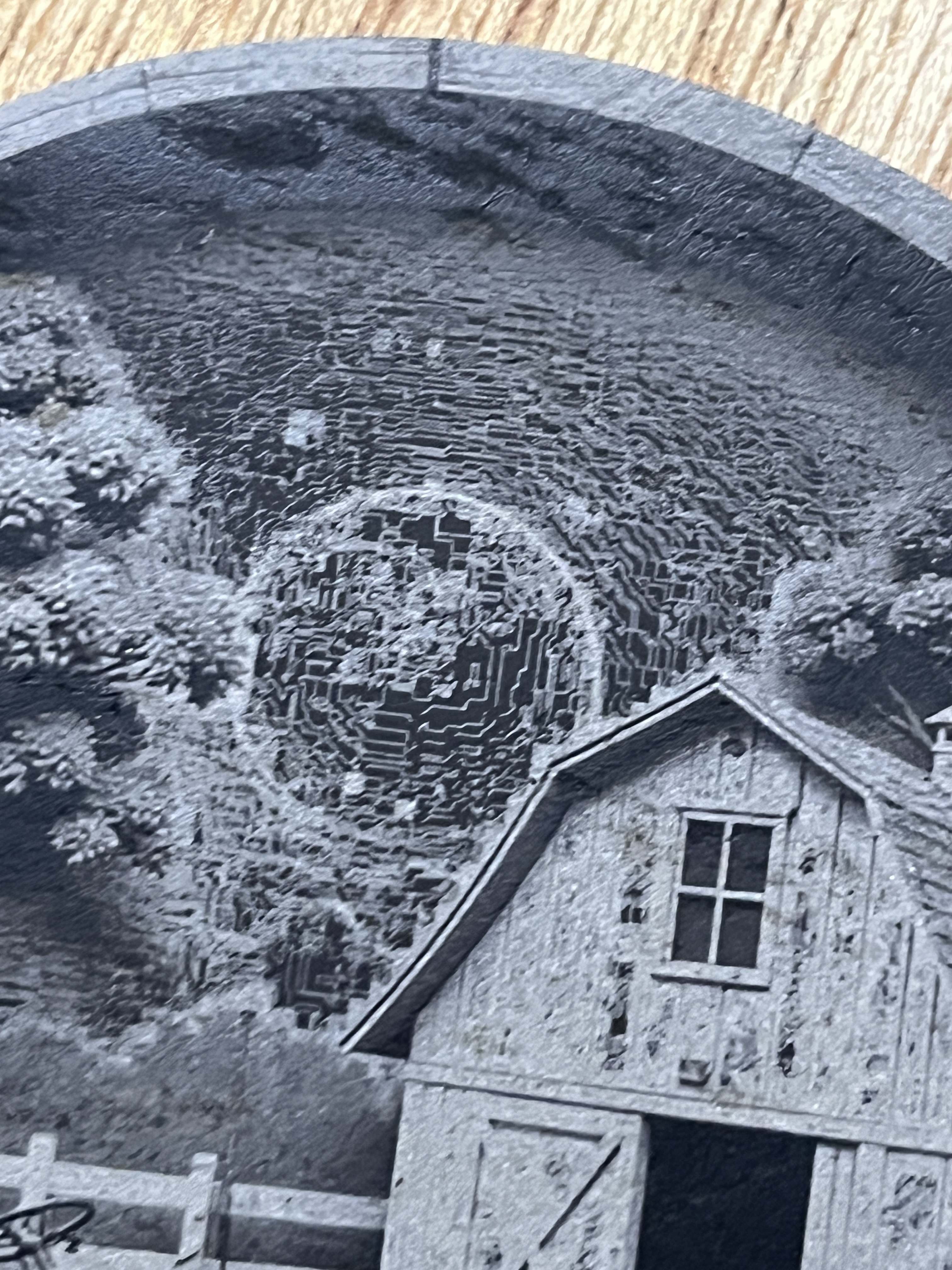

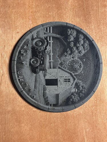

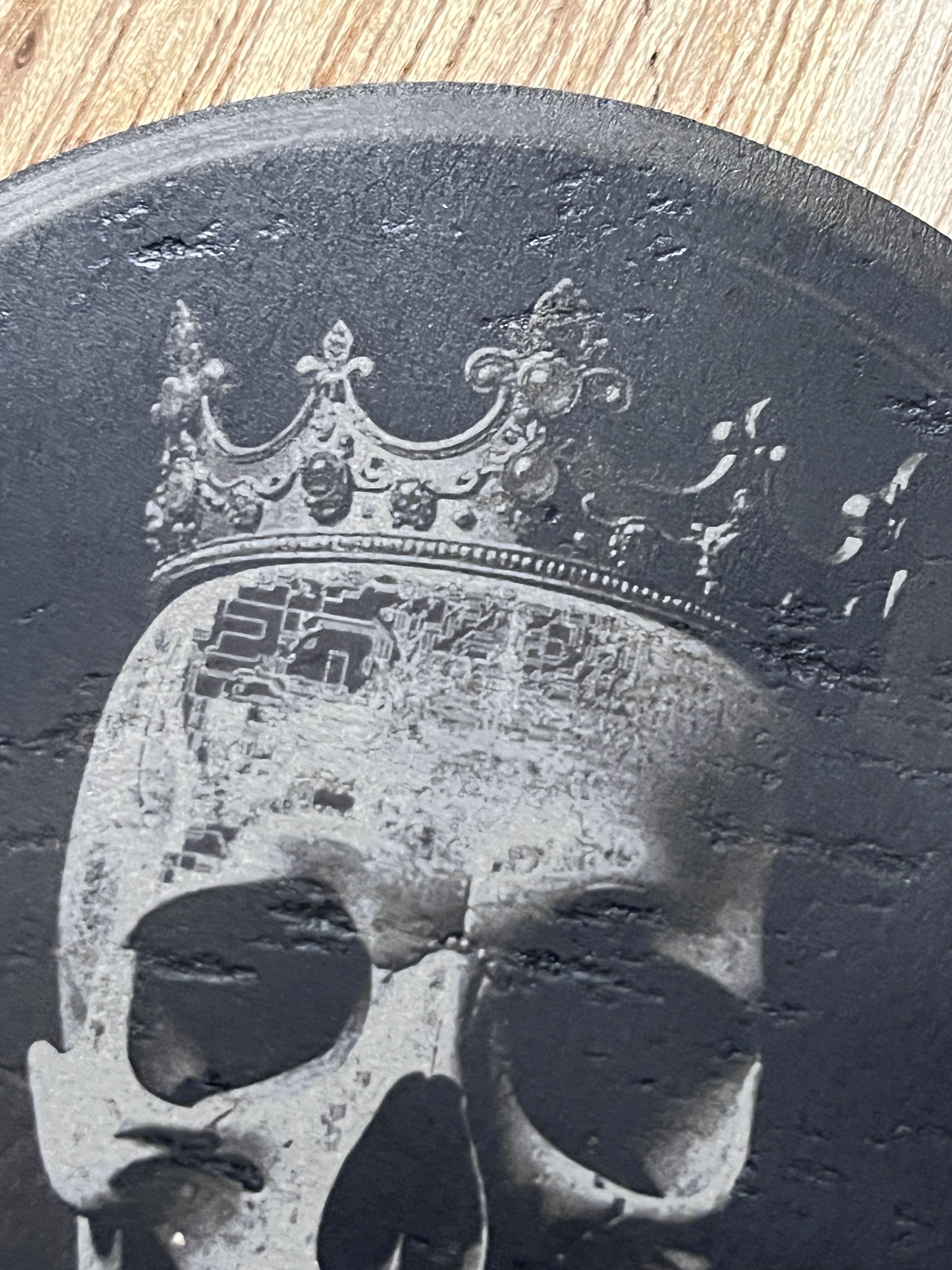

So I’m trying to engrave some images using my 60w mopa fiber laser using grayscale mode and everything looks perfect apart from some parts that have these strange lines. Tried different speeds and powers and still the same thing. I think it’s the brightest part of the image so I’d assume that’s confusing it somehow.
The resolution down near the bottom of this loooong thread may be relevant:
You may get better (or at least different) results with 2.0.0 RC4:
So I read all that and what the guy was saying about it showing in the viewport as well as the engraving, and everyone disagreeing that it’s not showing. I’m having the exact same problem where it shows in the viewport and in the engraving.https://youtube.com/shorts/Xzrkxk1d8VE?si=oS177rOh19kn5w8R
Yes, this version partially solves the problem. But new ones appear. I just stopped fighting it, because I no longer had the strength and desire to prove anything. I also have comments on the new algorithm. But most people do not use it, so I stopped fighting. Although, I will repeat once again in these releases everything works fine visually, but problems with the engraving speed appear. Oz explained to me why this happens, but I still stuck to my opinion. I just stopped defending it.
