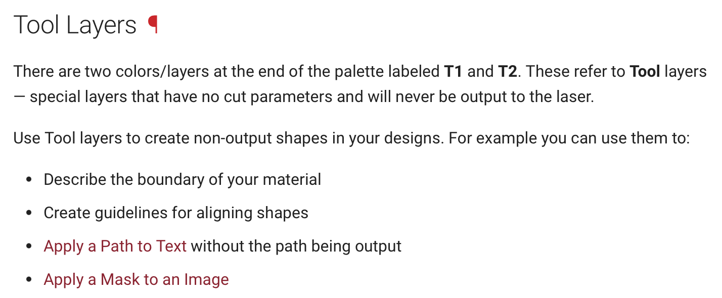

I mean the description in the documentation says it reasonably clear, Tool Layers - No Output.
You must perceive the 2 layers as auxiliary lines, just as in this image, it will not be smart to be able to send them to the laser.

This has been discussed before during the 1.3 release when some behavior changed while the design intention had not. It caused some confusion then and still slightly ambiguous now.
Read more here:
