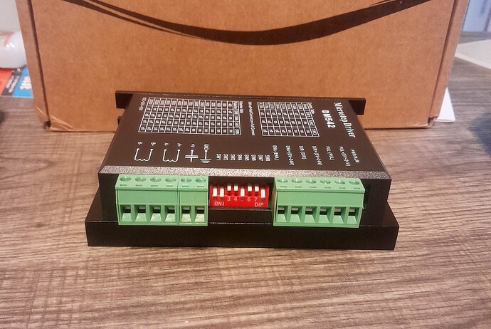

I have an issue with the rotary on my Commarker Omni 1. This is a brand new unit I received 2 weeks ago. Machine setup was a breeze; I was up and running in 20 minutes, happily engraving stuff. I am not new to Lightburn software or galvo lasers.**
When I plugged in the rotary cable in the back of the machine, the stepper motor coils got energized instantly, and it’s very hard to turn the rotary chuck. Also, after the rotary setup in Lightburn, when I press the test button, nothing happened except the software freezing up for a few seconds. I get the green light for the rotary in Lightburn, so it looks like communication with the controller is established.
**What could cause this? Bad wiring? Bad stepper motor controller? I’ve never seen this before on a laser machine. I’m waiting for Commarker support now to see what they say…keeping my fingers crossed. Thank you for reading my post. Any help is appreciated.

I’ll wait for Commarker support to see what they say and if they allow me to open the box to inspect the driver they used without voiding the warranty. My suspicion is that the microstep driver (likely DM542?) is defective, and they may not have adequately checked rotary movement after final assembly

Hi. I received an email from ComMarker support a few days ago. They said they would send me a new microstepper driver tomorrow. It’s possible the current driver works, but has incorrect settings. I will post pictures of the DIP switch settings when I replace the driver, in case that helps others.

Just a quick update on the rotary problem. I got the replacement parts from Commarker yesterday: computer board, micro stepper controller, and some cables.
I’ll be checking the DIP switch settings on the new and old parts when I open things up. Fingers crossed I won’t need to swap the computer board.
I measured the stepper motor coil resistance at 1.2 ohms, which seems a little low for a standard NEMA 17. Anyone else seen that before? I’ll post more pics and info after I get the parts installed this weekend.

I’m going to start by checking the DIP switch settings on the original micro stepper controller. If they look good, I’ll swap in the new one. What’s puzzling me is why the rotary stepper motor coils are energized as soon as I turn on the laser. Could that be a bad controller or computer board? And shouldn’t the micro stepper controller only get a signal from the computer board when I’m actually trying to move the rotary in LightBurn? Any thoughts? Thanks for your help.
I just went and turned mine on. The rotary energizes when the laser “on” push button is turned on. I do have a different laser but I bet they operate about the same.
