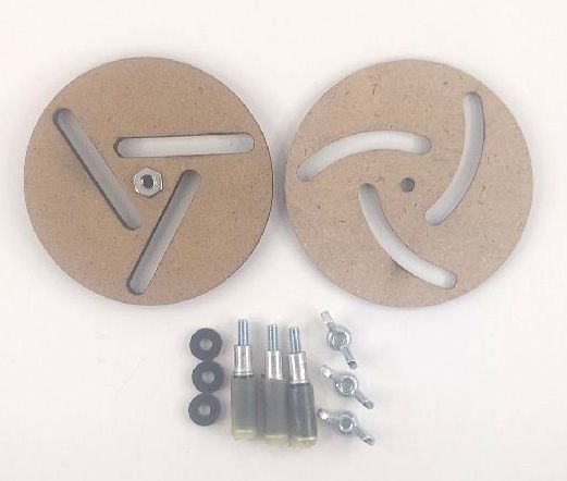

I have 250 flashlights to put a logo on, but because my other rotary is being used to make a whole-lotta political style mugs (thank you Mr. Trump from a greedy old Canadian), I needed to make something so I didn’t interrupt my current projects.
I decided on a longworth chuck. They are very easy to make. This one is made of things I had sitting around: MDF, 8-32 bolts (same size as M4), wingnuts, plastic spacers, surgical tube and rivet nuts.
The rivet nuts make it easier for the bolts to slide in the slots.
I attached the chuck to a stepper motor using a bolt that I stuck into the pulley attached to the motor. I attached the motor onto a piece of wood, put it in the Neje Max4 and it works great.
The entire project took less than 3 hours to cut, assemble and get working. It would have taken less time but I had to make a Timmie’s run in the middle of the project - fellow Canadians will understand.
If anyone is interested in the LightBurn file let me know and I’ll attach it.

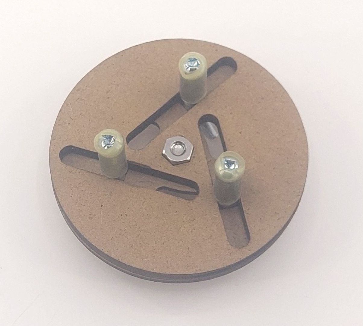

This one is adjustable from a diameter of 68mm down to 12mm. Rotating the rear plate and the front plate opposite directions increases or decreases the size. Tightening one or more of the wingnuts holds it in position. It is working great on the flashlights which are 22mm diameter where it grips and are 93mm long. If I wanted, I can easily make a larger unit that will do a larger diameter. I’ll probably end up making a better one out of acrylic for the plates, motor mount and base.

Here it is. This can be scaled up or down by resizing the entire thing. After doing so, ungroup each one. To get the proper slot size, delete the shapes around the blue tool lines (T2) and offset the tool paths to half of whatever diameter your pins/bolts are. The centre circle and nut will need to be resized as needed. I made this to use as a rotary chuck but it can be easily adapted to be used as a centre position jig like the one Albroswift mentioned just by adding a larger circle or square to “Plate B”. Using it like that never even occured to me but I intend to make one because it looks like it would be handy.
Please note that you will need to enter your own cut and fill settings for your laser. This one was made with MDF but it can easily be made using anything that your laser can cut.

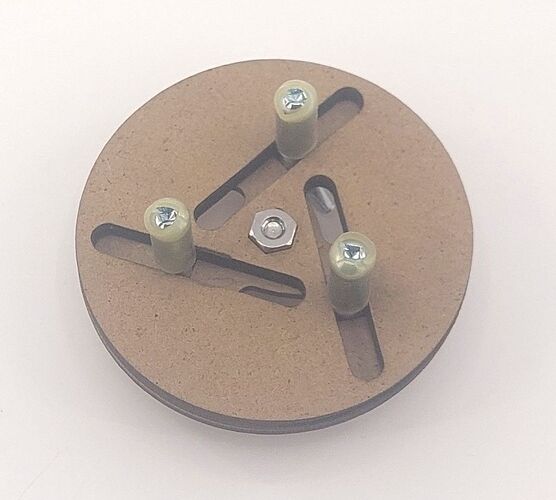

I have two CO2 and a Neje Max4 with the 20W diode module. These were cut with the Neje. The fill was set to: Cross Hatch; 3500 mm/min at 90% power; 1 pass. The cuts were set to: 300 mm/min; 90% power; 1 pass. Plate A is 6mm MDF. Plate B is 3mm MDF. I used the same cut settings on both because I was too lazy to change the setting for the thinner MDF.
Your settings on yours will probably be different because I have found the Neje to cut similar to a 30W module.
The file is attached to one of the earlier replies here.
