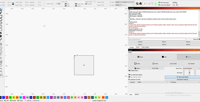

I have a CR pro 10 with CR falkon 5W, set up. There is offset, the bed at half minus. and that makes it on the outside of homing area. and goes outside the pad.
The bed stands at -120 to +120 not 0 to 300mm
The laser goes the opposite way.
And i get this
ALARM:2
G-code motion target exceeds machine travel. Machine position safely retained. Alarm may be unlocked. (Right-click the ‘Devices’ button to reset the connection)
I can’t reset without restarting the device or the program

In which corner home the printer in printer mode?
$100 and $101 are different, those $$ values are default?
Post a screenshot of Ligtburn Laser window and a screenshot of Edit → Device
settings.
left front side.
which values ​​should it be?
(upload://u9mKXjeO7LvCb5JTvF9d99YkqPr.jpeg)
This is how the laser is positioned on the printer bed
and the laser stepper motor controls go the opposite way. the left goes to the right side and vice versa, same with bed
I have load prefs.backup, and now the bed and the laser goes the right way, but still wrong location, out of printer area

when the laser is in the middle of the printer bed, it is in lightburn as in the front left of the printer bed
i need help to fiks this?
ALARM:2
what dos this mean? it did go to “home” and i did sett it to cut in glass. it did not move at all

i did sett the table to “homing” back left… this is what you can call of the grid
i dont now what to do, cant find any on googel
after only restart lightburn i get this up end usb warning

i did use CR 10 pro and switched to ender 3, got the same errors in the program on both machines. the errors cannot lie in the 3d prints. it must be the setup in lightburn
Before connecting the laser disable Auto-home at startup
Connect the laser (USB and power) type $RST=* in console window and wait a few moments,
Type $$ and post the output here.
the positon for the laser end bed befor the code and the same after.
