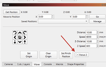

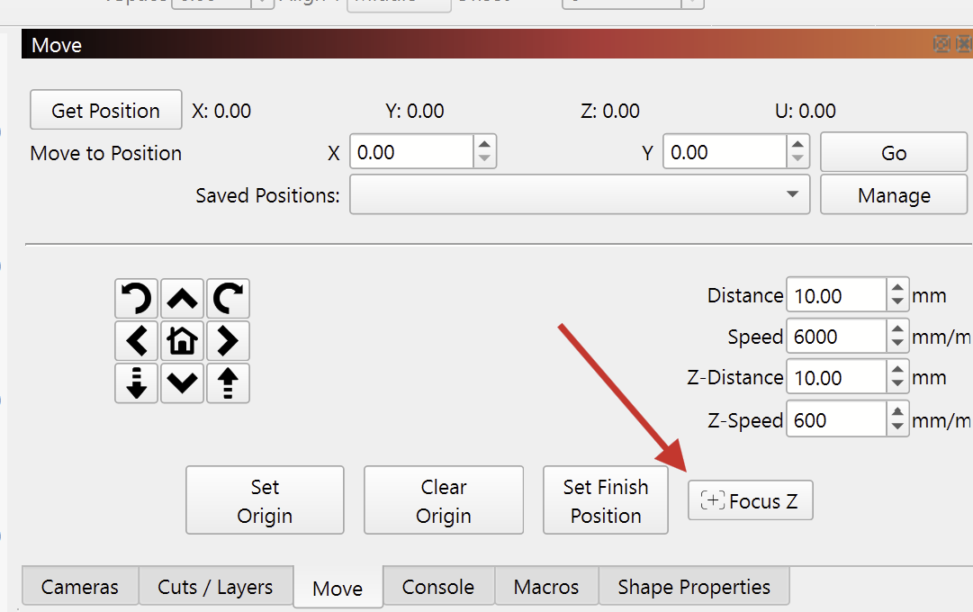

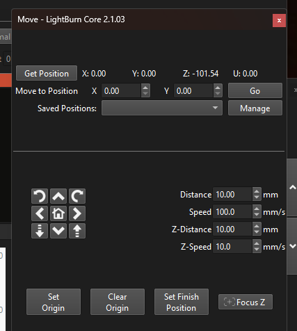

When using the device profile I sent, the Focus button is now in the “Move” window here:
This sends the machine the M130 command, which performs the focus sequence at the current position of the laser.

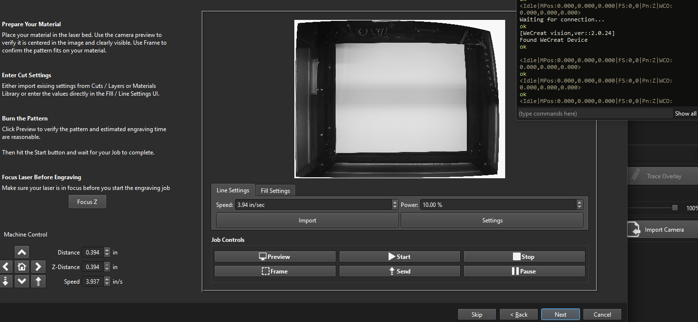

I added the wecreat device setting file. and changed the gcode flavor to wecreat like the program said to. there is no focus button any where in the program its blank box in maroc. i tried to set the camera but it will no move in the alignment area of the camera what’s next what am i missing.
As shown above, the Focus button is now in the Move window.
Please send a screenshot explaining where you got stuck in the alignment process.
Without more information available we can’t see what might be missing.
At your convenience, please confirm the version of LightBurn you’re using.
It will be visible in a full-screen screenshot and will inform us how to help you.

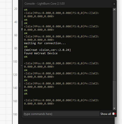

i now can get it to focus, but when the laser starts
it rise back to the top.

I can now focus the laser but start to cut or line fill the laser head lifts up the max height its like something is reversed. i can stop it and refocus but as soon as i start the laser the head lifts up . and the camera will do the same when a try to align the camera
when i focus the laser the position for z say it a -101.54 and when the laser starts it goes to 0.0
this is Z focus height

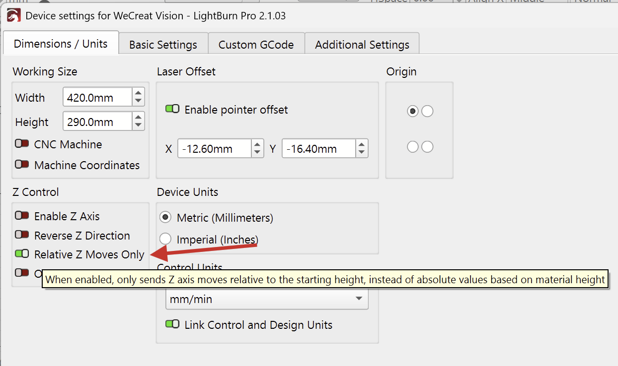

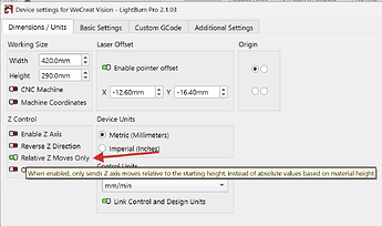

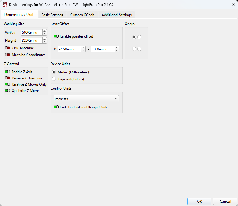

See if enabling “Relative Z Moves Only” in the Device Settings helps.
Hi Aron - this is fantastic awesome work! It is working great I think there are some nuances that worked for me. Here are my little tweaks that you already kind of eluded to:
  1. Had to select both Enable Z and Relative Z moves only. Otherwise when I press “start” the laser just moves up way out of focus.
  2. The (for me) the only way the focus would work and is working is with the macro “focus in center” you provided. I tried using the “Focus” button on the move screen and the laser focusses but goes all the way up when I press start (still doing that).
  3. I think you (wecreat users) need to purge as much of wecreat as you can from machine memory, registers, cache or where ever, so I deleted the wecreat supplied file, the 1st install of your masterpiece did not work, deleted my first install of your machine file installed copy (1) it somewhat worked. Removed my second install and installed copy (2) and it all began to work for the most part.
The only setting I changed was the “Relative Z moves only switch”. And yay off to the races.

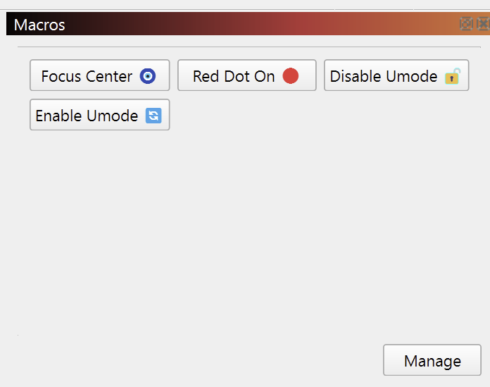

The “Focus-Z” button in the Move panel should work exactly the same as the macro. Both send the laser WeCreat’s custom command M130 for the focus sequence. In the macro, I only added the coordinates to perform the sequence in the middle of the workarea: M130X200Y150.

I didn’t get to test the Z-Steps per pass Cut Settings yet.
In the device profile they shared, they didn’t enable the Z-Axis, so the options for “Z Offset” and “Z step per pass” weren’t available.
The machine might be using an offset, and I’m not sure if it requires relative, or absolute coordinates for the Z-Axis.
With the correct combination of these two toggles in “Edit > Device Settings” it should be possible to get it working.
