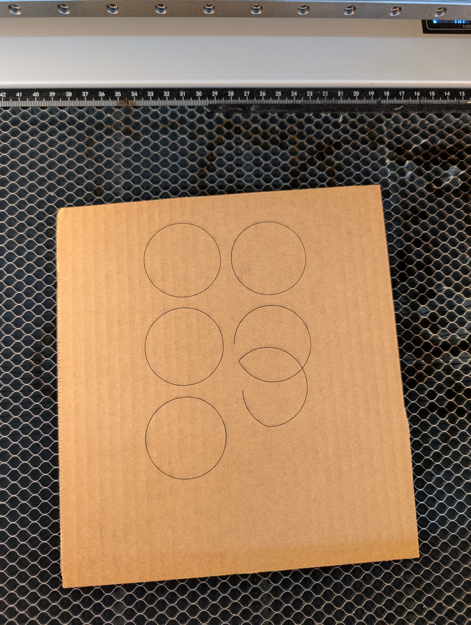

Here’s the results with 6 half sized circles. It was the end of #4 and all of #5 when it went wrong

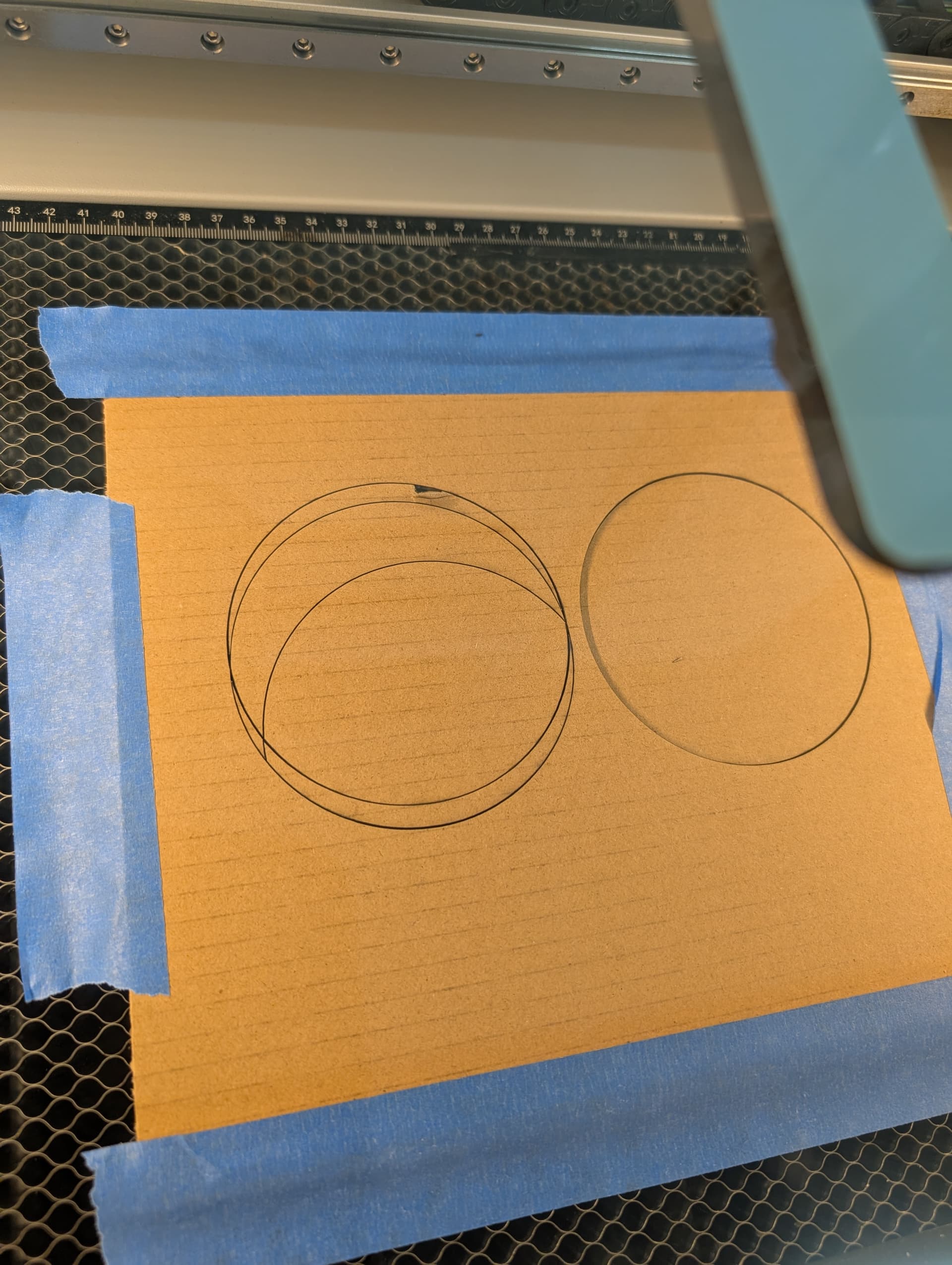

I also tried 2 circles with 2 passes each. The first circle was fine, but when it started the second circle, pass 3 it went wonky again

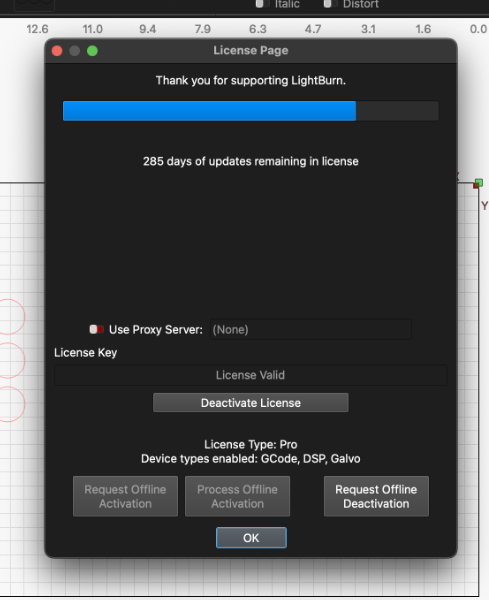

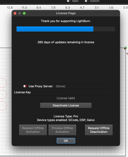

I purchased the license with the laser, directly from Omtech. I’m pretty sure it’s legit. It’s activated for sure and on 2.0.2.
