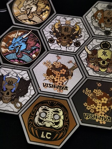

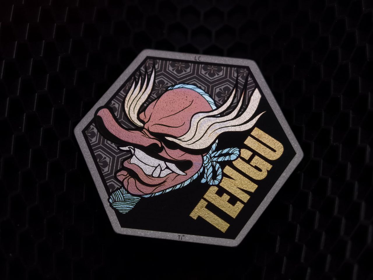

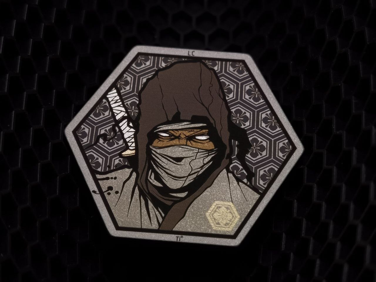

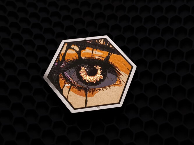

Titanium token & patch. Color engraving
due to the black color, the video had to be accelerated 15 times :slight_smile:
Excellent work :+1:
Would you like a “gentleman’s” bet regarding first to full colour?
Can I have more details?
Japanese Soul collection :slight_smile:
Top tier work for sure! Inspirational.

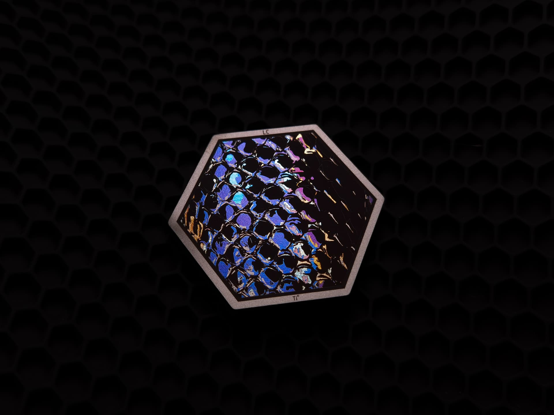

A little more beauty

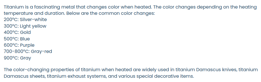

@jkwilborn , you have a thermal color chart for titanium? :grinning:
@Deepspace some beautiful work. Can’t imagine how much time you’ve spent doing this. Thanks for posting them.
I don’t trust many of the items I find on the Internet. :face_with_spiral_eyes: I keep my eye open for them. Some of these get copied, their names changed and other things so with these you have to kind of compare around to guess you’re getting something close.
This is the best I’ve seen from this site that deals with Titanium. :man_shrugging:
These kind of temperatures and their duration makes them next to impossible to measure in any real way for a hobbyist.

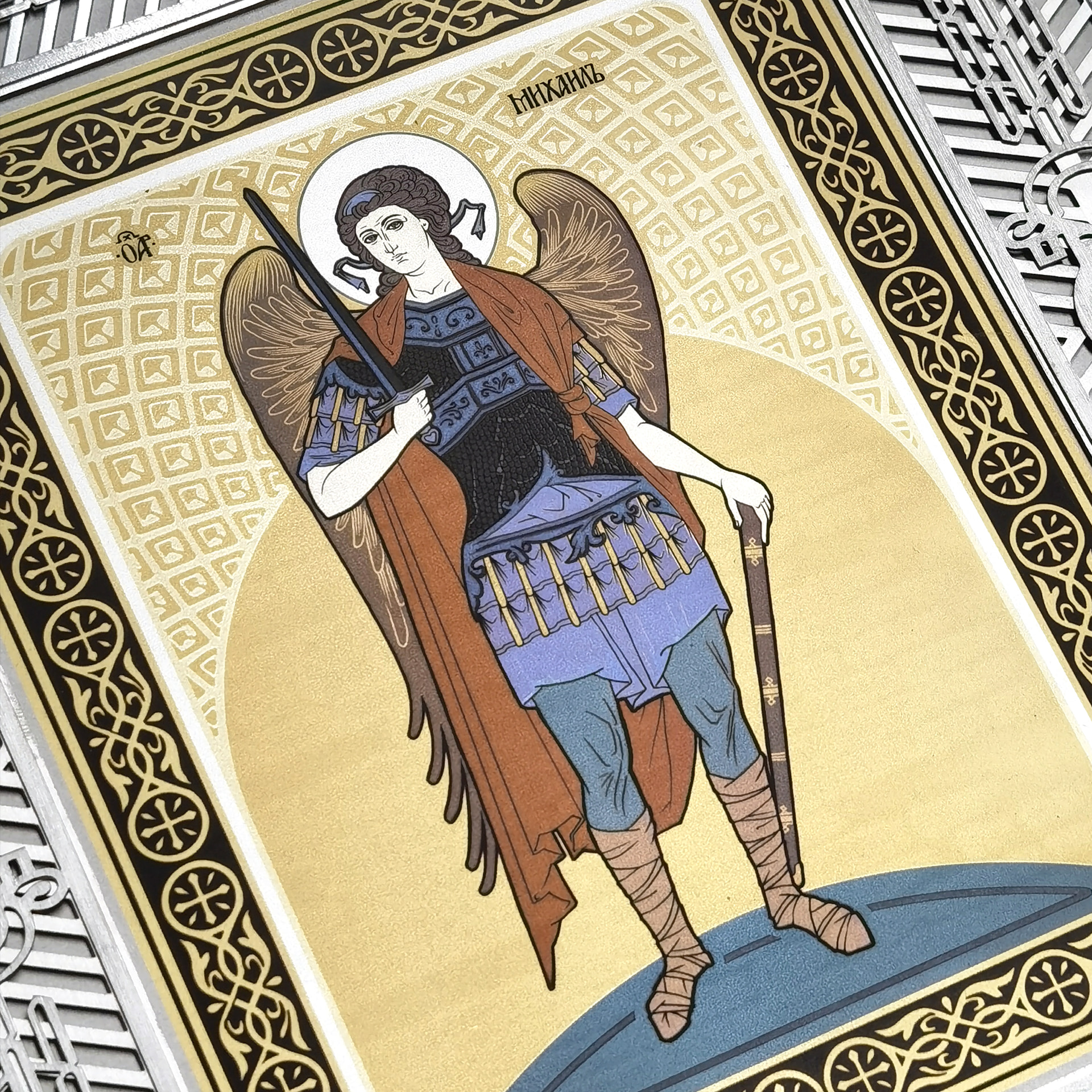

@Deepspace Do you cut your own tokens? if so where do you get the material and what width are you using?

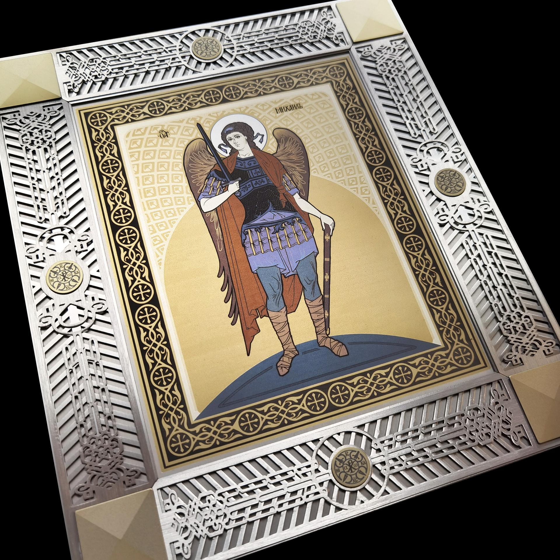

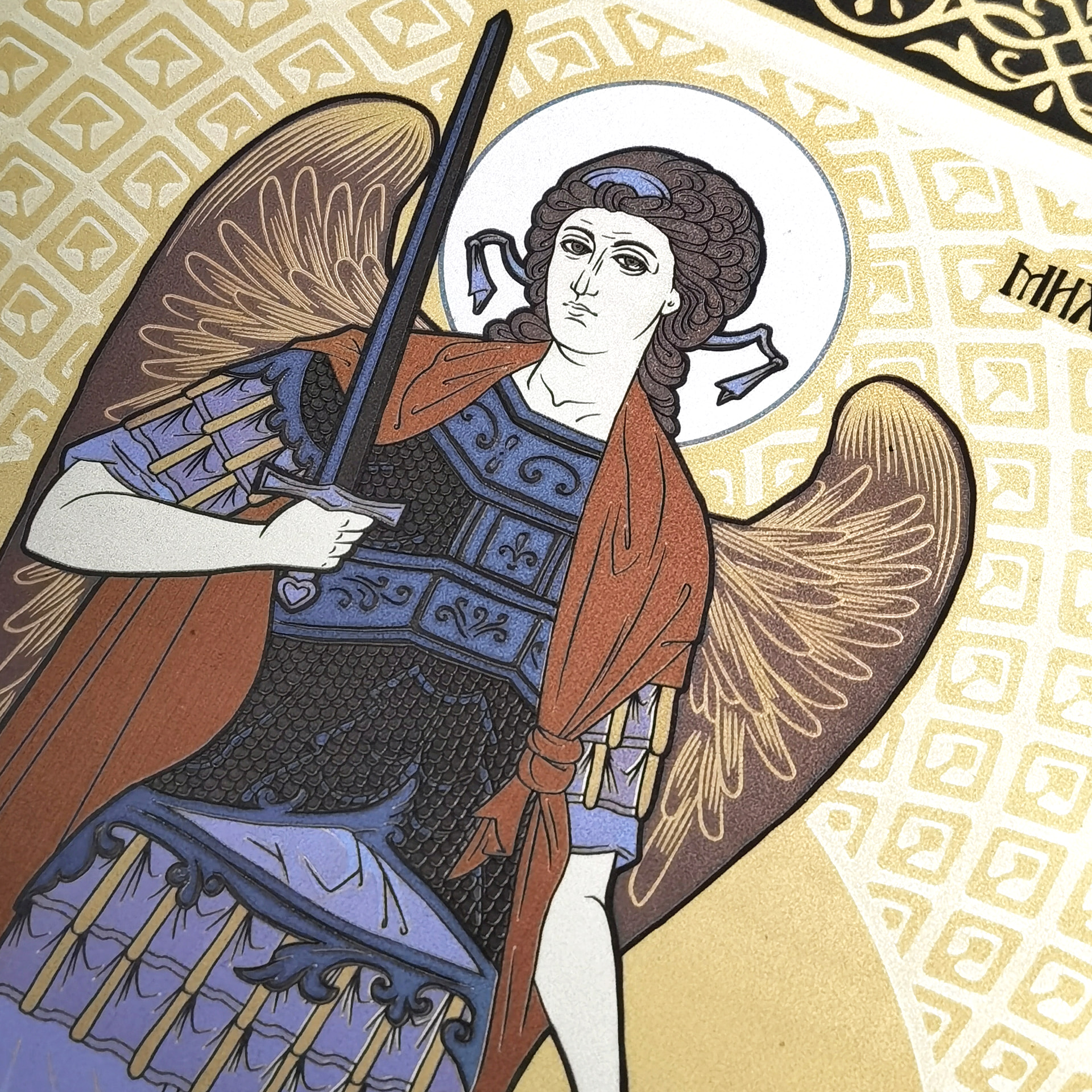

Sorry for the late reply. I have my own production related to metalworking. We have a laser cutting machine for metal. We have no problems with titanium sheet metal. We use a thickness of +1.5mm. If thinner, the metal will bend from the temperature. If you need blanks, we can make them. My contacts are in the profile.
I haven’t posted anything for a long time. And we’ve done a lot of things.
size - 280x240mm
Material - titan 100%
image - laser engraving

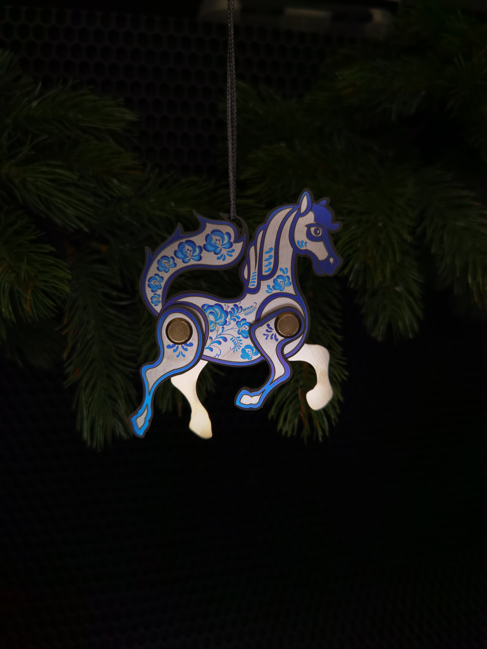

New Year’s titanium horses to everyone. Happy New Year!

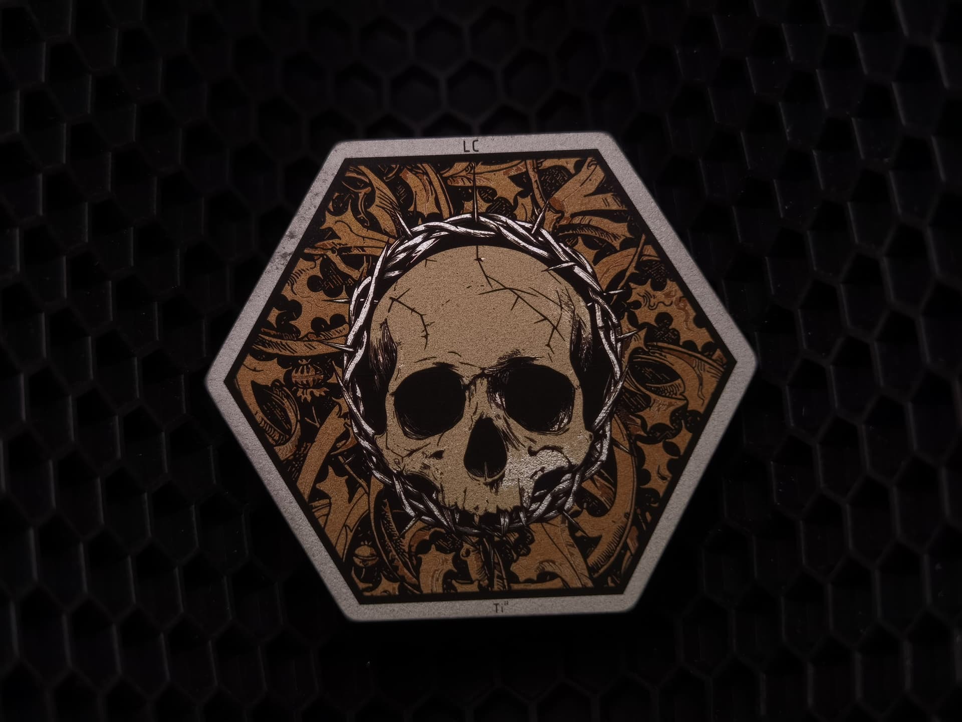

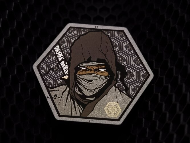

I quit trying to do color with my fiber, too many variables.
:grinning_cat:
As we say, “patience and labor will grind everything down.” More than one person does this work for me. Designer-technologist, engraving technologist. And of course not the first time. It’s really not easy, but the result is inspiring.
