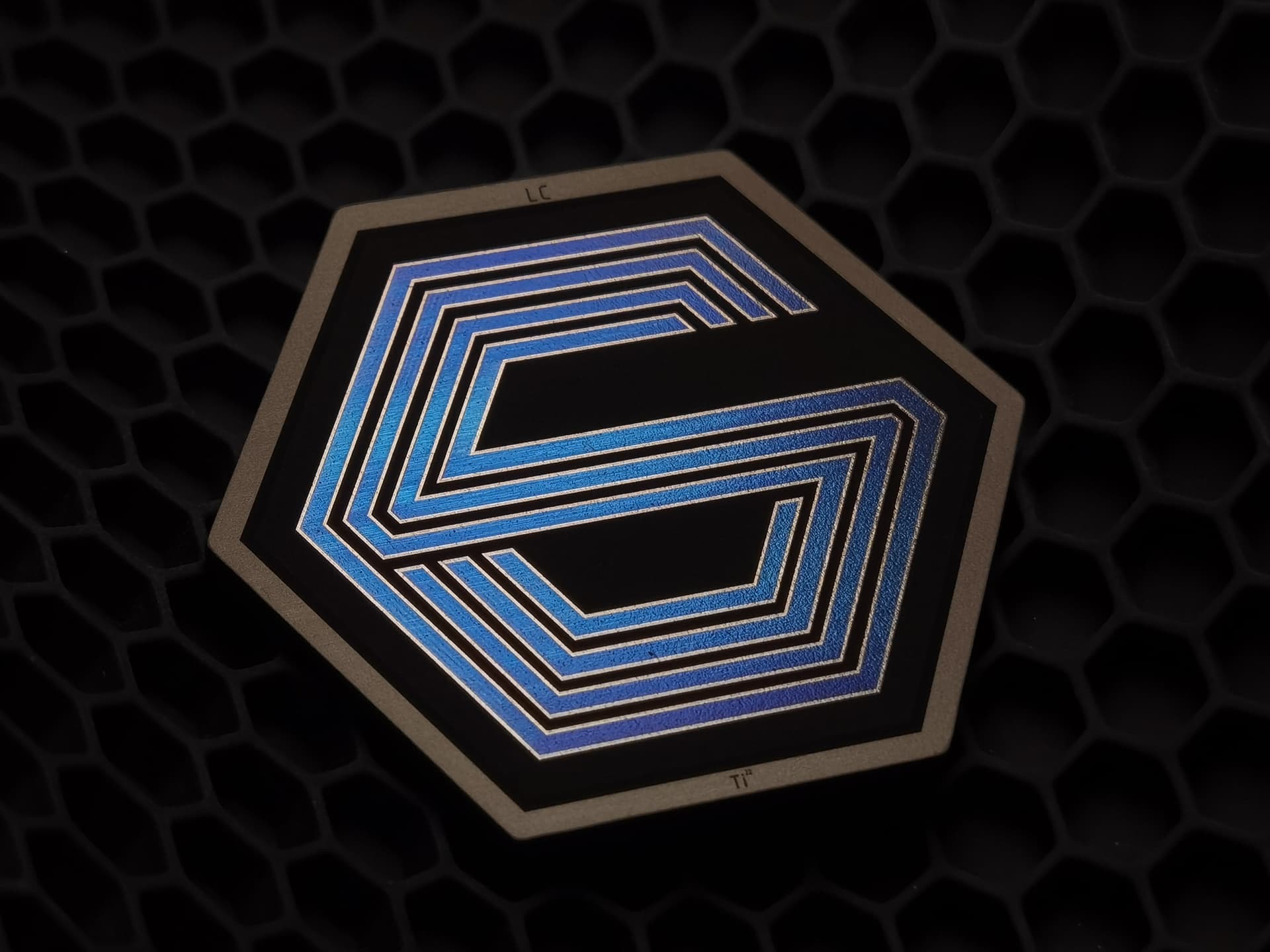

Titanium token & patch. Color engraving

each layer/vector/color should not intersect each other. The colors go close to each other. Background filling of the blank is allowed so that the color engraving fits better…
Absoloutely fantastic, I am assuming that you are cutting your own ti blans as I never seen such shape.
Yes, I have a laser metal cutter. When cutting titanium, there are also nuances.
Do you have a good source for the blanks? Any business card blanks?
I cut them myself, in almost any shape. Of course, I prefer titanium or stainless steel with a high titanium content (aisi316T).
Sample of business card

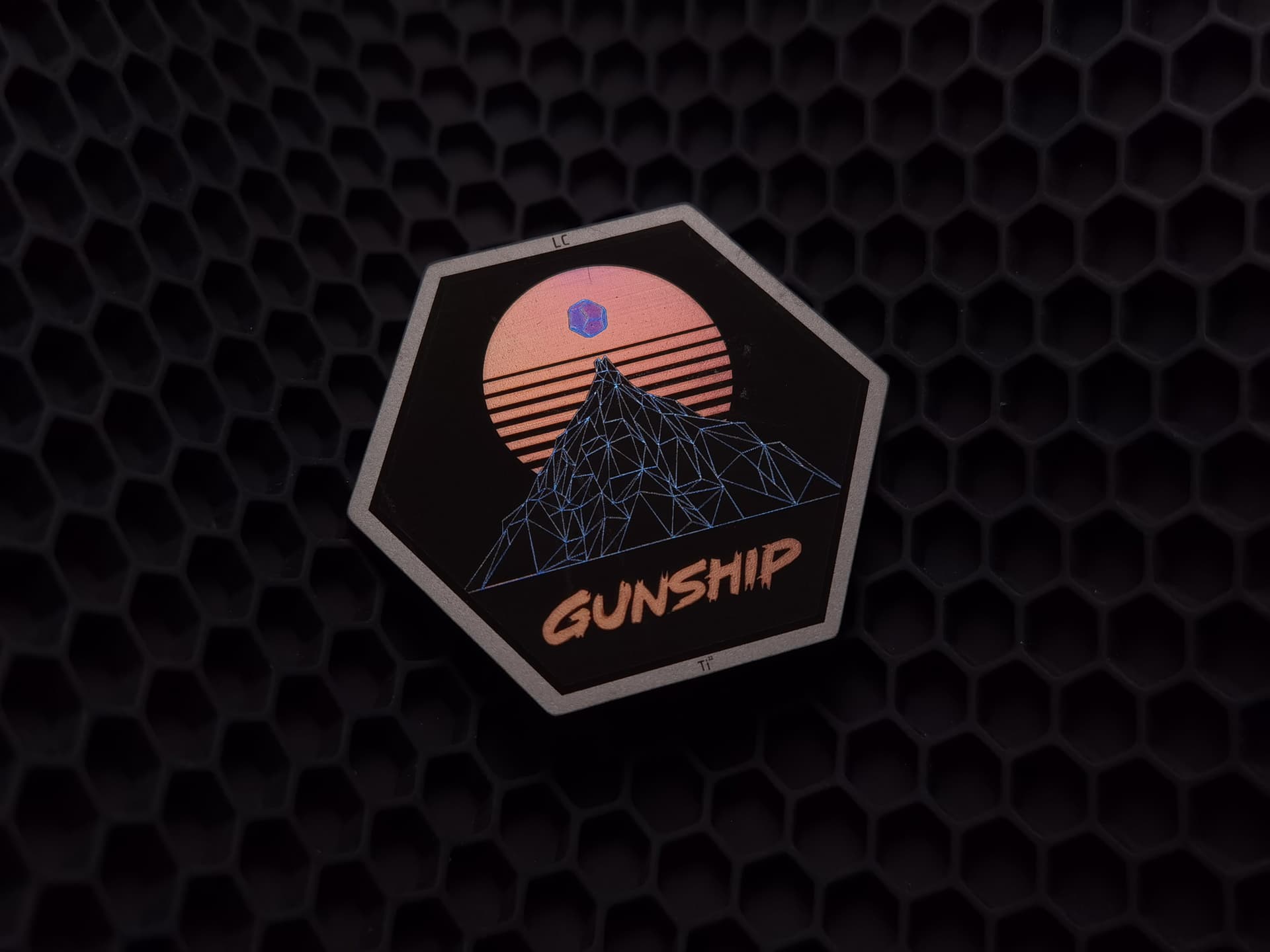

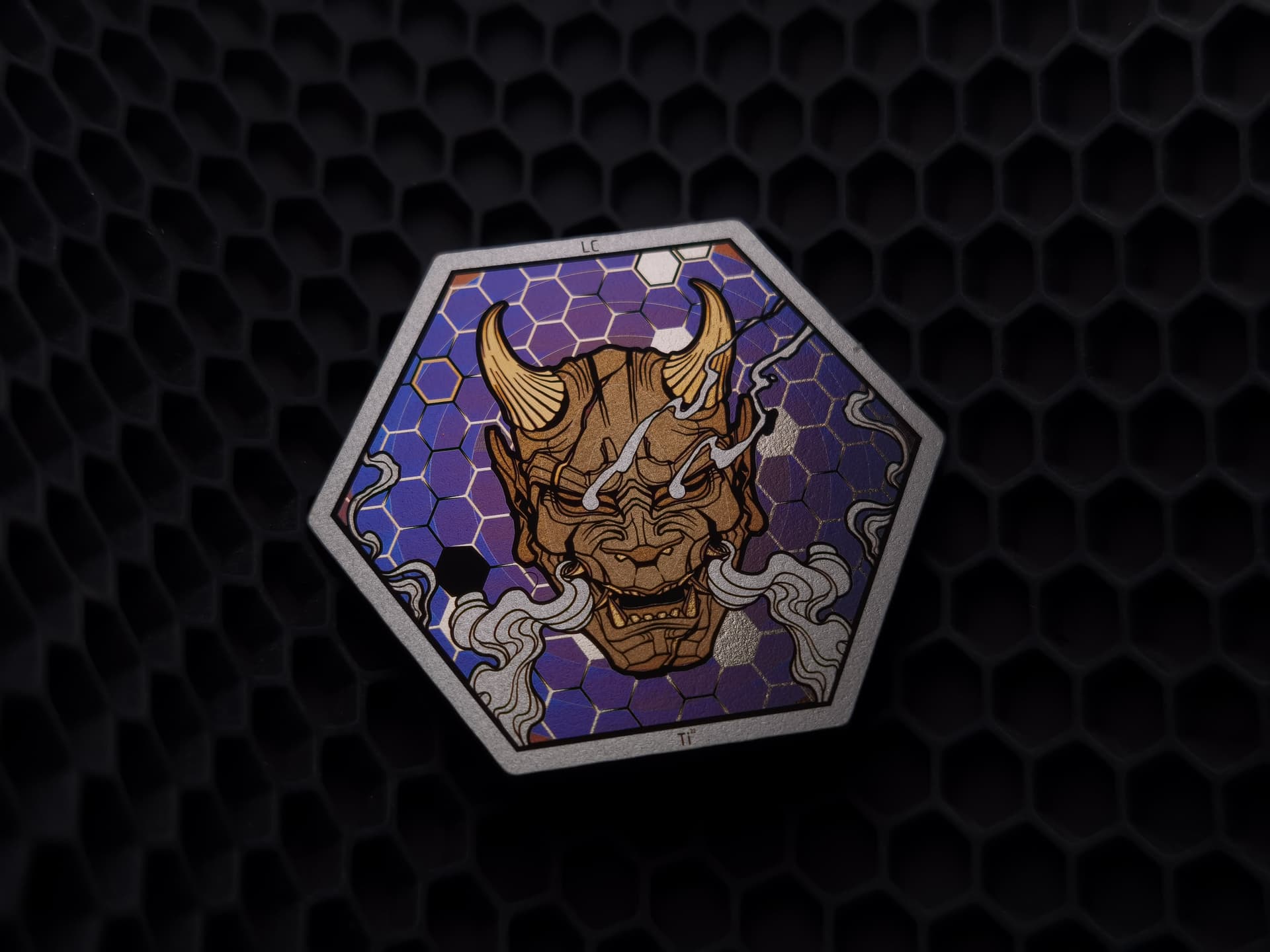

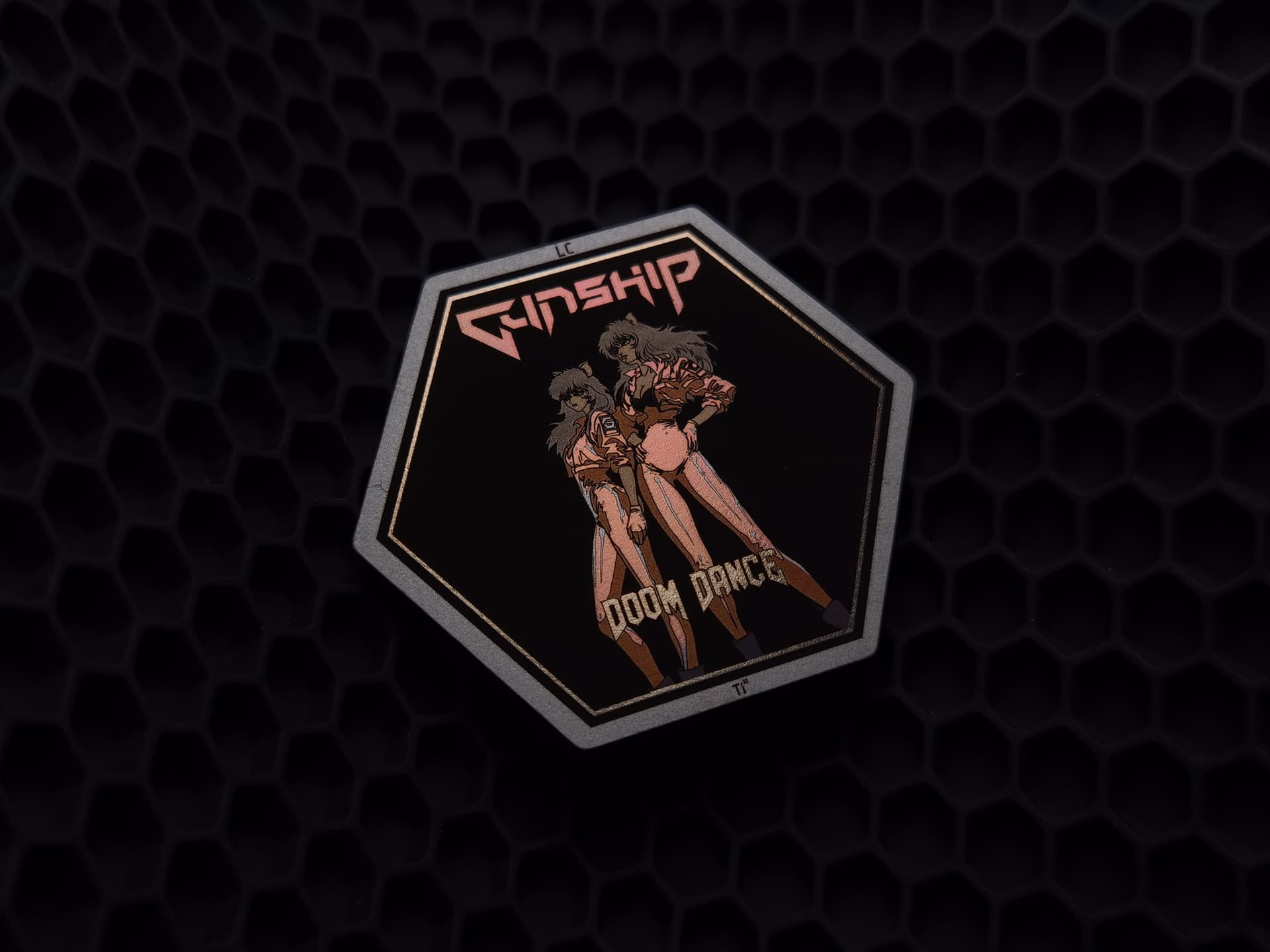

I haven’t posted our work for a long time. Here.
Titanium, some mate colors.
