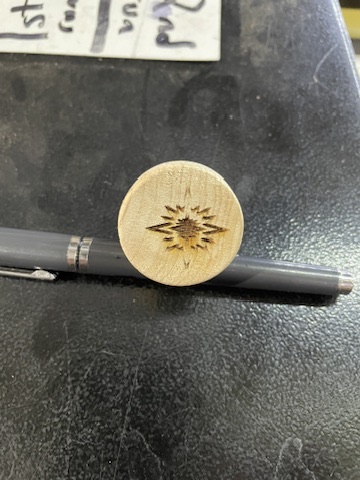

We have an 80 w Logilase 9060. We recently switched it to a Ruida controller so we can use LB. However, the laser is missing small details while engraving. In order to rule out any hardware problems, we reinstalled the old controller and used the old software and the engraves came out just fine and at much higher speeds*. I have triple-checked that the laser is in focus and have done a bit of testing on changing line intervals and lines per inch, but no luck. As you can tell in the photo it misses the smaller details where the laser doesn’t pulse as long.
*I would give you the exact speed at which the new controller runs, but it doesn’t tell us. It only says “Speed 90%”…whatever that means. But by eyeballing it, it looks to me to be somewhere in the 250 mm/s to 300 mm/s. By contrast, we are running at 180 mm/s and still missing details. Even slowing it down does not help.
I assume this is the bad version? Only having the before or after results, makes it hard to compare this … what details are missing or?
The artwork would be nice and we can see your settings, if you’re ok with that. You can just drag and drop the .lbrn file on the reply window.

Here are the results of running the same file, at the same speed, and same power but using RDWorks.
2DBE61B8-E918-4A86-B59A-A72070385F23_4_5005_c
Note the faded lines at the top and bottom of the engraving. Also noticed how the engraving is off-centered. That is another problem we have been having but maybe I will make a different post about that later.
I will also mention another problem we’re having that I don’t think is related but perhaps it is and I want you guys to know as much as possible.
The engravings get weaker and weaker as the laser moves from left to right. The above photo is the bottom left and this is the bottom right.

That is 100% guaranteed to be a mirror or lens alignment / cleanliness issue, because there are no software or firmware settings along the lines of “get weaker over on the right side”.
If it’s much worse in the far corner from Mirror 1, then a “fourth corner” tweak is in order.
Unfortunately, because you cannot access the settings of the old controller, you must reconfigure this one from scratch. The fact that “it used to work” suggests getting the details right will improve the results, but we must work from the evidence at hand rather than recalling The Good Old Days. :slightly_smiling_face:
