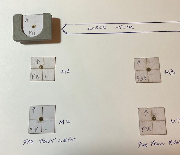

Hello Jack, I had a look at the TEM00 mode and went out and bought some watercolor paper and did some tests. the result are what i show in the pics. I set max laser power to 11 and min power to 10. Max power seems to bee offset a bit. mirror 3 result seems it is getting max power. Go easy on me I’m a mere novice but please let me know what you think. If it’s way way far out then please say so. I’ll do a ramp test tomorrow and upload it.

This is pretty indicative of a TEM00 tube failing. Notice the output of your tube at m1.
The crescent shape should not be there…
At m2, it’s showing no power in the center area.
M3 has a similar look as if a doughnut.
I think you need to ask the TR manufacturers about this anomaly. I’d say you have a bad tube.
